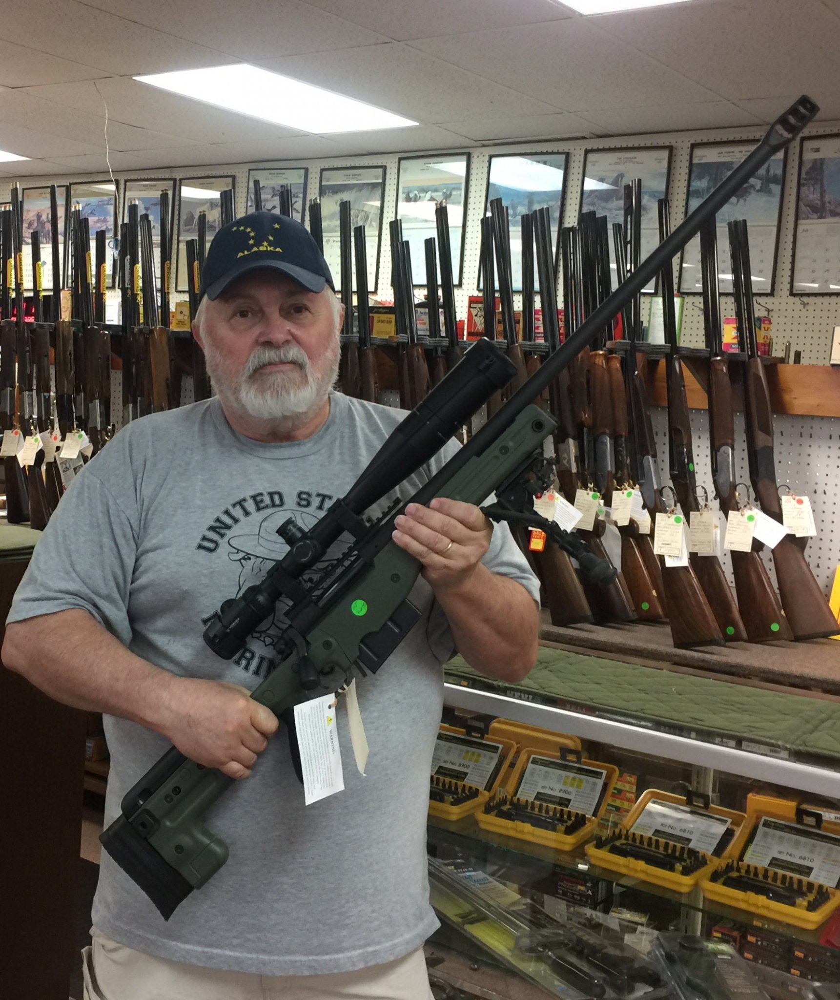

My new to me rifle has had not a lot of rounds thru it. It shoot adaquite for my learning curve right now. Under 1 inch. Stock 700 action and bbl in 300 wm question is. Do I have someone here in the LA area bush , true, flute polish. And put a great bbl on it our do I go straight to a big name and buy a great action with a killer bbl that fits my AI chassis. The trigger on this is fine for now. 2.5 to 3 # no creep or overtravel. I think the tricked out stocker will serve me fine as a beginner. But if the money is near replacement cost then why mess around. Iookinh to get into the mile and better shooting. Not competing though. I’m to old for that. Just some bench or prone shooting. Thinking of 7mm/300wm. 30 inch bbl. any good smiths in LA/Orange County. I like boomers. Oh yeah. It’s a Long action. I have to single feed cause the lands are so deep.

I think just the truing. I can wait for the ginger bread when I get my big boy pants. This I what I bought.
I’d keep your current rifle as is.
Then later build an entirely new rifle based off an aftermarket action and new barrel.
Then you have 2 rifles. Problem solved.
