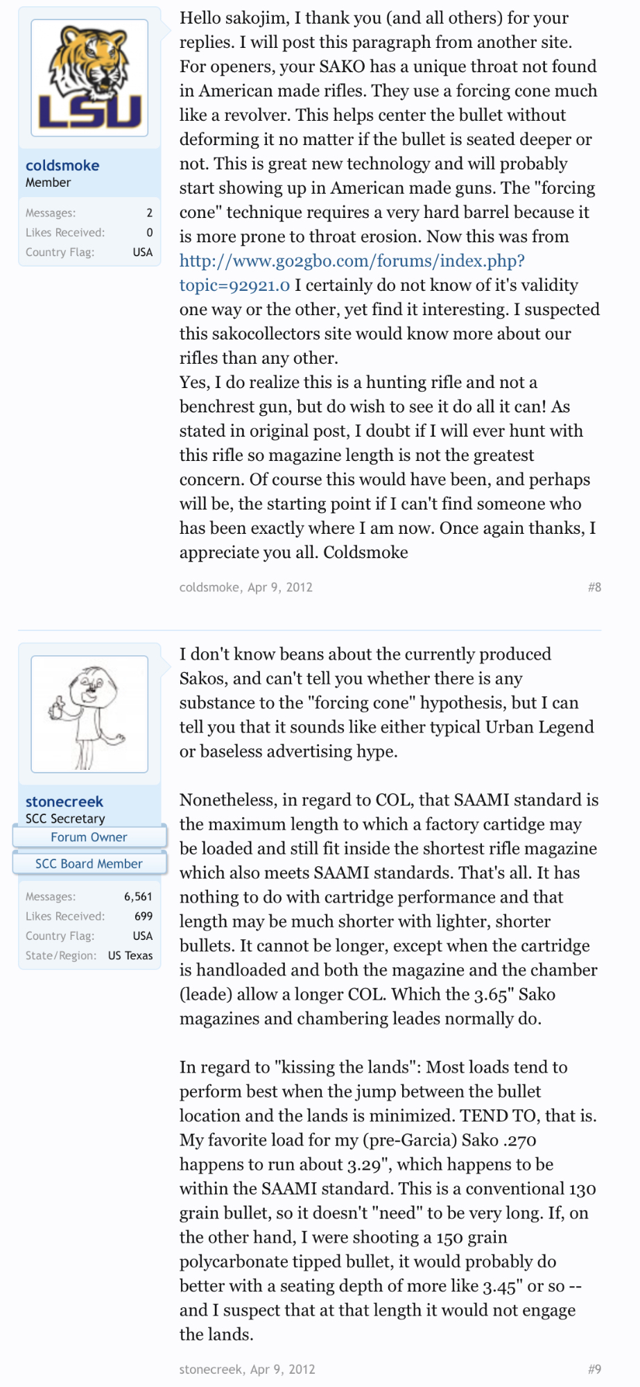

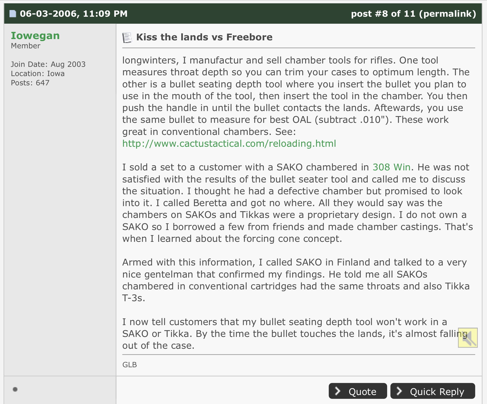

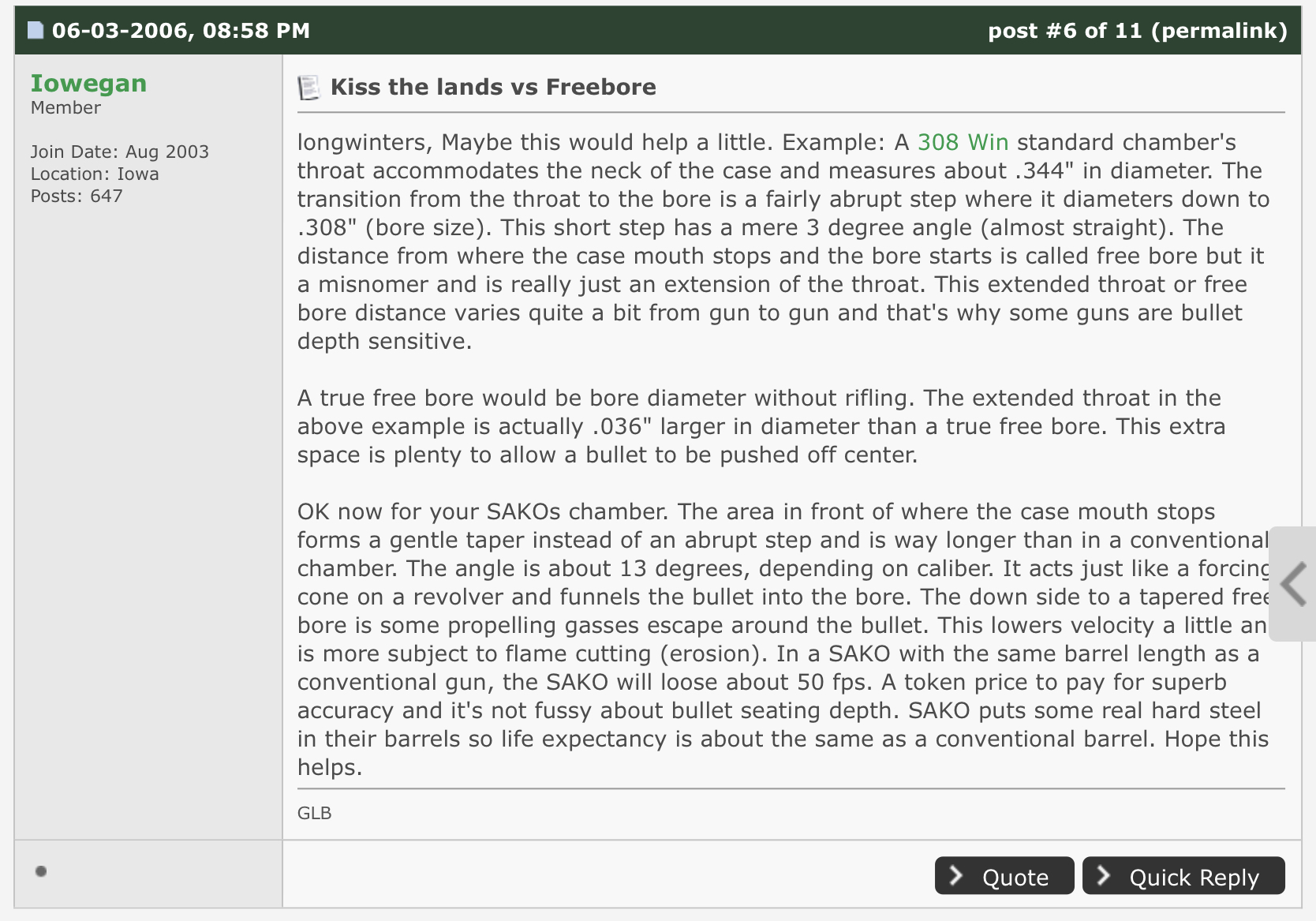

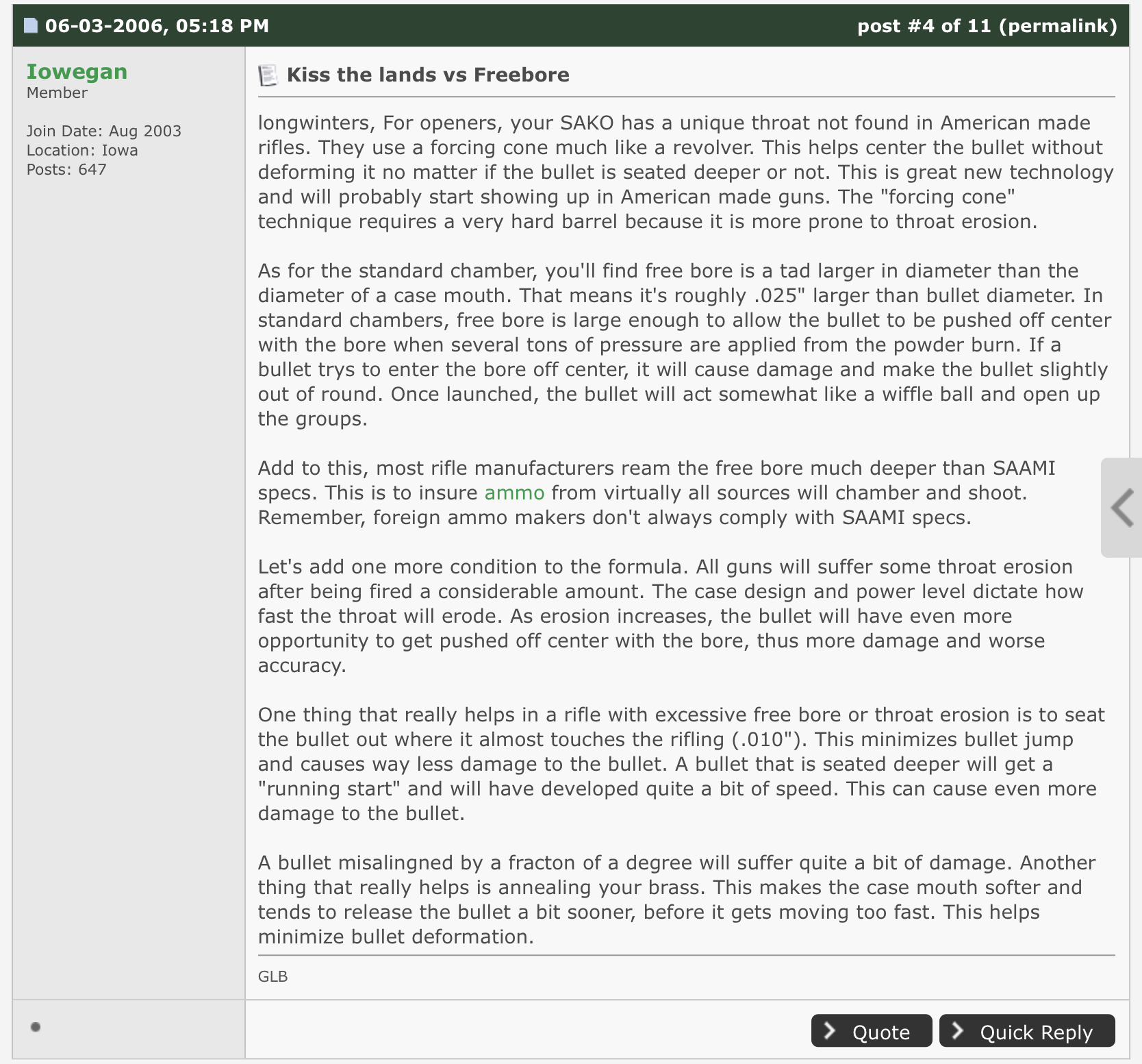

Found a post referencing it.
Might just be hearsay, it seems...
Really not sure.
Personally don’t have the background to comment on such.
A lot of cartridges have a tapered, instead of a parallel, freebore.
For starters, look at the SAAMI specs for Winchester cartridges. A 243, 264 Mag, 270, 284, 300 Mag, 338 Mag, all have a tapered entrance into the barrel. There are other too, including the 30-06.
