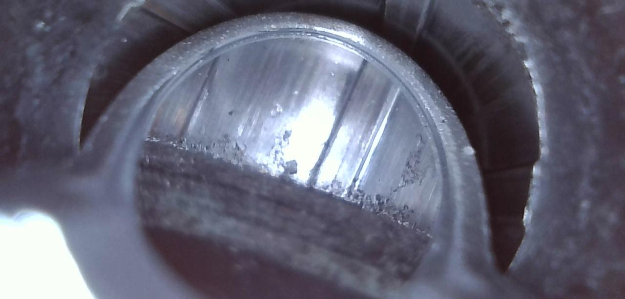

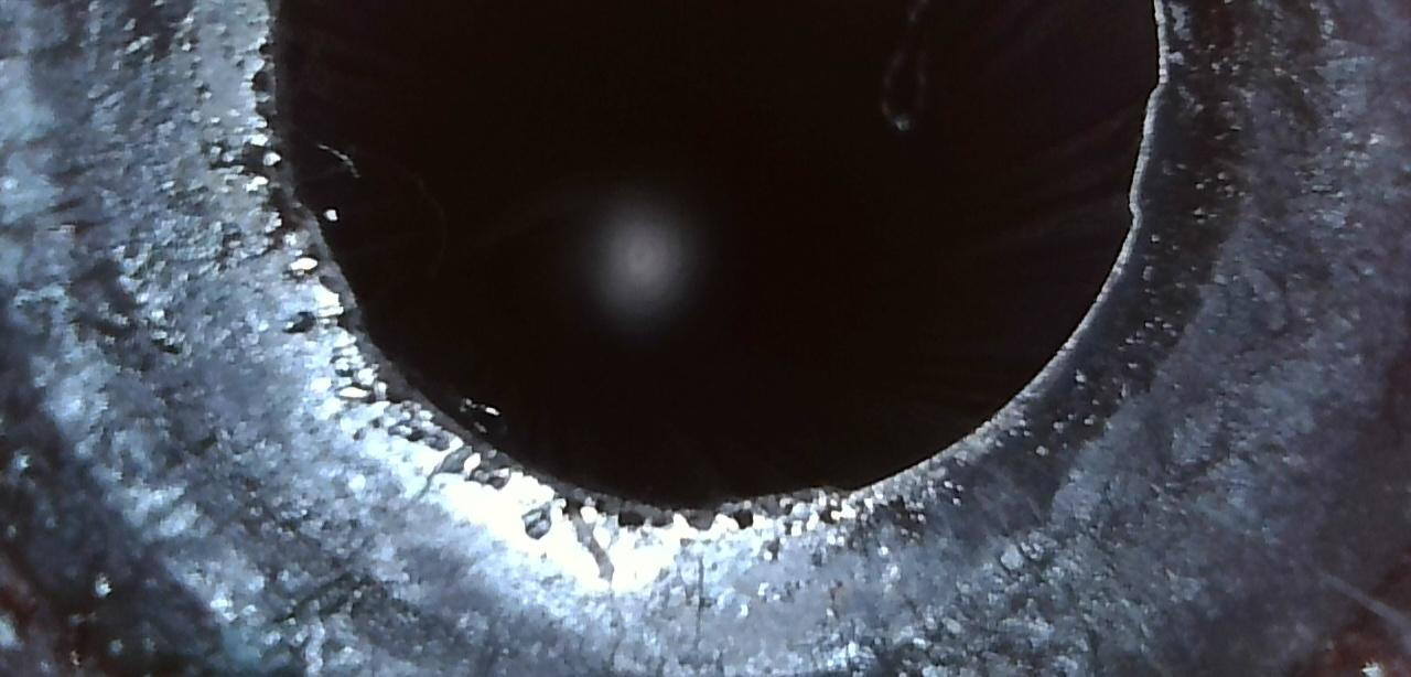

Forgive me if this is a dumb question. Long time shooter, new to bolt guns and groups. It's on a used .308 rpr I bought off gunbroker. Groups are only reliably 1 1/4. I'm able to do better with other guns. Is this my problem? Cause?

Assuming 100 yards. There appears to be some pitting (corrosion?)in the barrel. Barrel does look clean. Not sure, having never owned one, how these guns will shoot. You don’t see a lot of them at matches but they do well as a hunting gun.
Missed that the picture was the crown ( what I get for not fully open both my eyes and the picture). That is actually pretty ugly. I would find a local gunsmith and have the crown recut
Reactions: Baron23
Personally, I would replace the barrel.
If it is that pitted on the crown, I would think the rest of the barrel is jacked as well.
If you have the tools to change an AR barrel, you have the tools to change the RPR, they use the same tools.
You can buy a pre chambered shaw 10 twist stainless steel barrel for 370 bucks.
They are good quality, OEM type barrels. I have experience with 4 of their barrels, all sub-moa.
No, they aren't as good as a bartlein, mullerworks or krieger, but they tend to shoot very well.
Reactions: oldrifleman

Yep, get a smith to clean that crown up...dunnu WTF the previous owner did to get it that rough but to my inexpert eye, that's fugly but also easily fixed by a competent smith.
Are you sure it’s pitting and not Carbon build up. Common to see build up with suppressors. Almost looks like micro cracks in the pics. And looks raised making me thing it’s carbon
What is your experience level with rifles? Can you typically shoot better than 1-1/4? What ammo are you using?

What ammo are you using, just because something says “Match” does mean it can it can hi a barn from inside it. Know any smiths? If not, where are you maybe someone here can find one.
Federal Gold Medal Match (168), there are some smiths in my area. I'll probably buy a barrel if the consensus is the damage is likely causing a problem.
FFS, any even reasonably competent local smith can clean that up for a modest fee. I would certainly try that before putting a new barrel on it. But I guess that’s just me.
Makes sense, I think I'm looking for an excuse to buy a barrel, which I may do. Expertvoice has Proof SS Prefits for $524. My takeaway from everyone is that the damage looks is likely a problem. Correct me if I'm wrong.
Thanks everyone for the replies.
Reactions: Baron23
I'm with @Baron23 and spend far less to recrown than to rebarrel. Recrown is going to be in the $150ish range at most shops and is not generally a long lead time because the work is simple.
Sure, it may not improve the groups but it sure as hell might. Save yourself $300 or more.
If it does, you can shoot the thing until you wear out that barrel. If not, try the new barrel and you "only" spent an extra $150 to find out.
BUT...what if you get the new barrel and it still doesn't shoot?
Reactions: Baron23
I found a smith 10 miles from my house and ordered an LRI barrel nut wrench. I guess we'll see if this crown is a problem.
If you were close I could have re cut the crown while you wait. Or have you do it for experience. I like to take off about 1/2" to make sure the rifling is good. What does the rest of the barrel look like? It just looks like someone had a can or a break on it and never cleaned it. They will pit under all that fouling.
