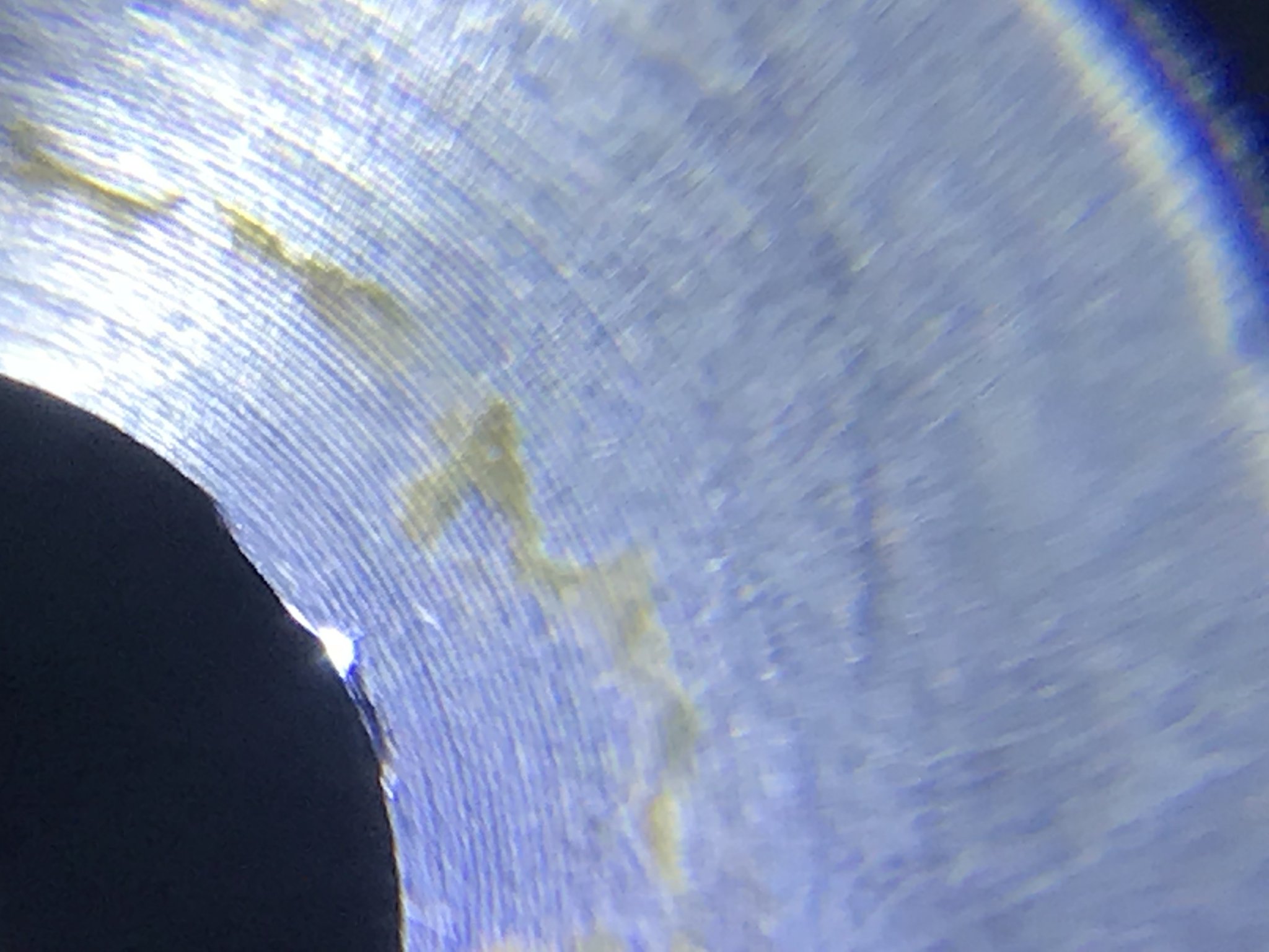

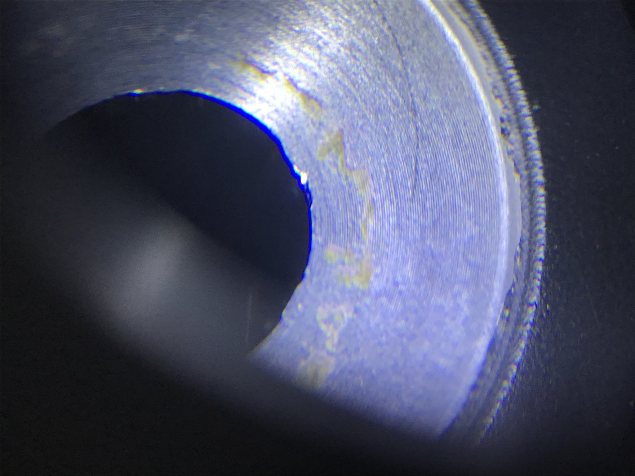

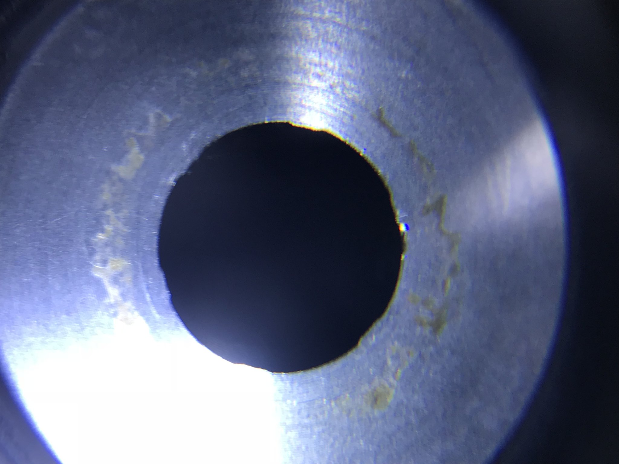

Rifle is new and un fired. Looking for opinions on what you would do with this crown it it were fresh from the smith?

That’s what he said ..... seems crazy to even waste bullets , time , powder ect..... knowing it has a burr or at the very least not a clean cut crown !
3-5 shots will be enough to tell if its shooting well......if the gun shoots well, dont dick with it......if it shoots like shit, have him recrown it.
just because a crown is not perfect doesnt mean it wont shoot.
honestly that doesnt even look that bad
I understand that for maybe a off the shelf $500 rifle, but when you pay the premium for a top shelf smith to chamber and crown I guess I just expected a perfect job ?!?

I understand that for maybe a off the shelf $500 rifle, but when you pay for a premium chamber and crown I guess I just expected a perfect job ?!?
do you care about perfect appearance or perfect shooting?
i mean do what you want......but personally, ide take it to the range and at least run a few rounds through it.......if i find its shooting bughole groups, i dont care how that crown looks, im not touching it.

Ideally both ! I guess we will see.
You could try the Qtip test first before shooting it. It costs as much as a Qtip and takes about 30s of time.
Take a Qtip and "fluff" it out to make it whispy.
Slide it into the bore and ever-so-slightly lay it against the inside of the bore. Retract the fluffy Qtip and see if the mark shown drags fuzz. If it does, ask for a recrown before shooting it.

I thought about that as well . It’s hard to see in the pic but it looks like the edge left when cutting something with a chop saw. It doesn’t grab from the inside but if I go outside to the center of bore it does grab . This would be the second time it has happened from this smith. The first time I had horrible velocity spreads and saw the burr, I used the brass lapping tool from brownels and the spreads came way down but accuracy wasn’t amazing. That rifle also had chamber issued (NK too tight ) so I’m not sure if the brass lapping tool really mattered ?
The pictures are terrible. You couldn't make the barrel look worse if you tried. With enough magnification you could make the finest machine work look like the surface of the moon.
I doubt that barrel will shoot. That looks all kinds of wrong to me. I expect my crowns to at least look perfect to the naked eye.
I routinely thread and put 11deg crowns on used rifles I buy (even before shooting them), and none of them have come back looking like that. No magnification is necessary. You can plainly see it, so I would expect it to have a serious impact on shooting. I'd just be done with that guy and take it to a different smith for a re-crown, which is $50 at my LGS or $100 for a thread and crown. Well worth it. While your at it have him go over the rifle to see what else is fugged up. Reminds me of a certain hide video about a certain FL precision rifle maker...
All internet BS aside, if you're paying for a built rifle it should hold sub MOA for a 30 shot group with tuned cartridges, and you should be able to easily cherry pick 3 shot groups to make you look like the winner of The World Bench Rest Championship to your internet friends...

If my rifles won’t shoot a 5x5 at or under .5 I don’t want them.
Second time from same Smith?
If I built anything with a bur like that it would have been an imidiate rejection from QC .
Being so obvious on the outside, wondering what care was taken while reaming the chamber?
The surface also looks bad, like cut with a dull tool, maybe you should bore scope the other end.
Have you sent those pix to the (smith) ?
It's correctable but you shouldn't have to eat it.
I have ran 10 ft chop saws with a new blade at proper speed with coolant and had better looking cut surface, just saying!

I sent the pics and told him it’s plain as day. He said just shoot it and see what it does. I don’t agree with that, if it has a burr .. fing fix it. Then I got the whole I’ve done thousands this way and your the first to complain or have multiple issues ?!
Looks like the tan stuff is residue from some type of cleaner maybe. Looks like the damaged part of the crown could have come from a cleaning jag being pulled back through the muzzle and catching the edge. I do think I would shoot it and see how it groups. I bet you would be surprised.
I'd find a new smith and have them re-cut the crown. If he is so upset about having to fix shoddy work I wouldn't trust whatever he does to fix it.

Even if it did shoot okay, I'd still want it fixed. How would you ever know if it could possibly shoot better with a proper crown job?! I'm pretty anal, so I would never be okay with getting a new rifle from a smith and finding things like this.
I am pretty surprised at all the people that recommend just shooting it to see how it does. That's like buying a new car and it shows up with a big scratch in the paint, and the salesman goes "take it for a drive first". Sure the engine still roars, and the scratch doesn't affect the drivability, but you paid for a new car, and it came with a defect... same goes for rifles for me. Your paying for a complete product, not just a tube that can shoot well.
I was trying to give credit to the fact that the pictures can make things look worse than they are but if the thing drags a fingernail it's worrisome.
Take it back and request it to be fixed without taking it to the range.

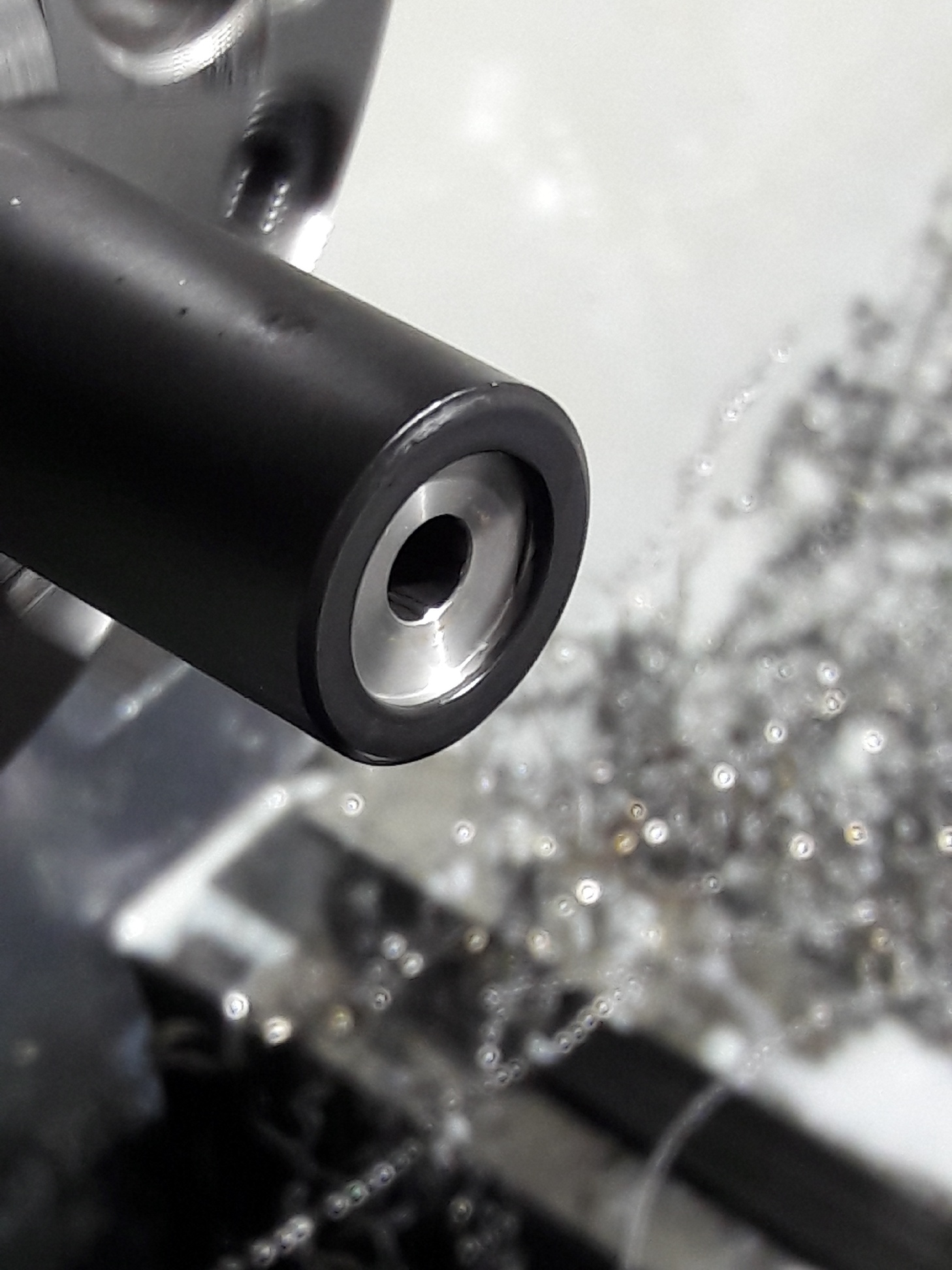

So here we go.
A bright shiny, concentric crown!
Done by a real lathe man.
Barrells are proprietary in hardness ect. You can't just dial up what the book says, you have to wing it.
Adjusting speeds and feeds is an art to make it come out perfect.
Using a sharp tool and some coolant should be a given but the first attempt seemed that some did not get it?
Would have a high confidence its right now got out the readers and blew up the shot, looks perfect!
