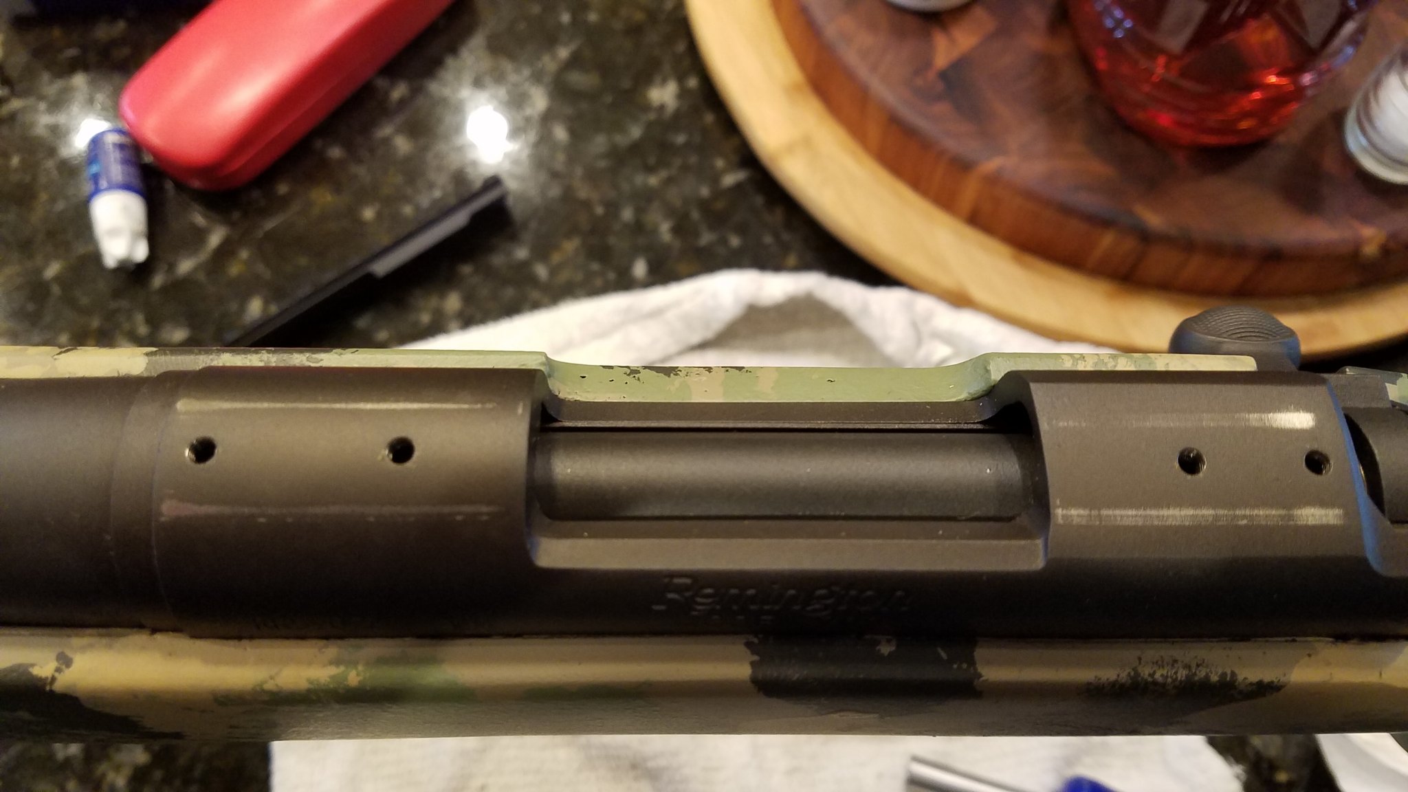

So, the top of your action looked like this? 😂

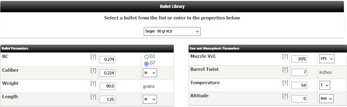

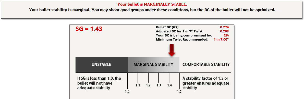

Ah...what am I missing here?? Jack the altitude to 1k and temp to 100F and stability factor comes out to 1.6 which is just over the 1.5 minimum comfortably stability factor.
