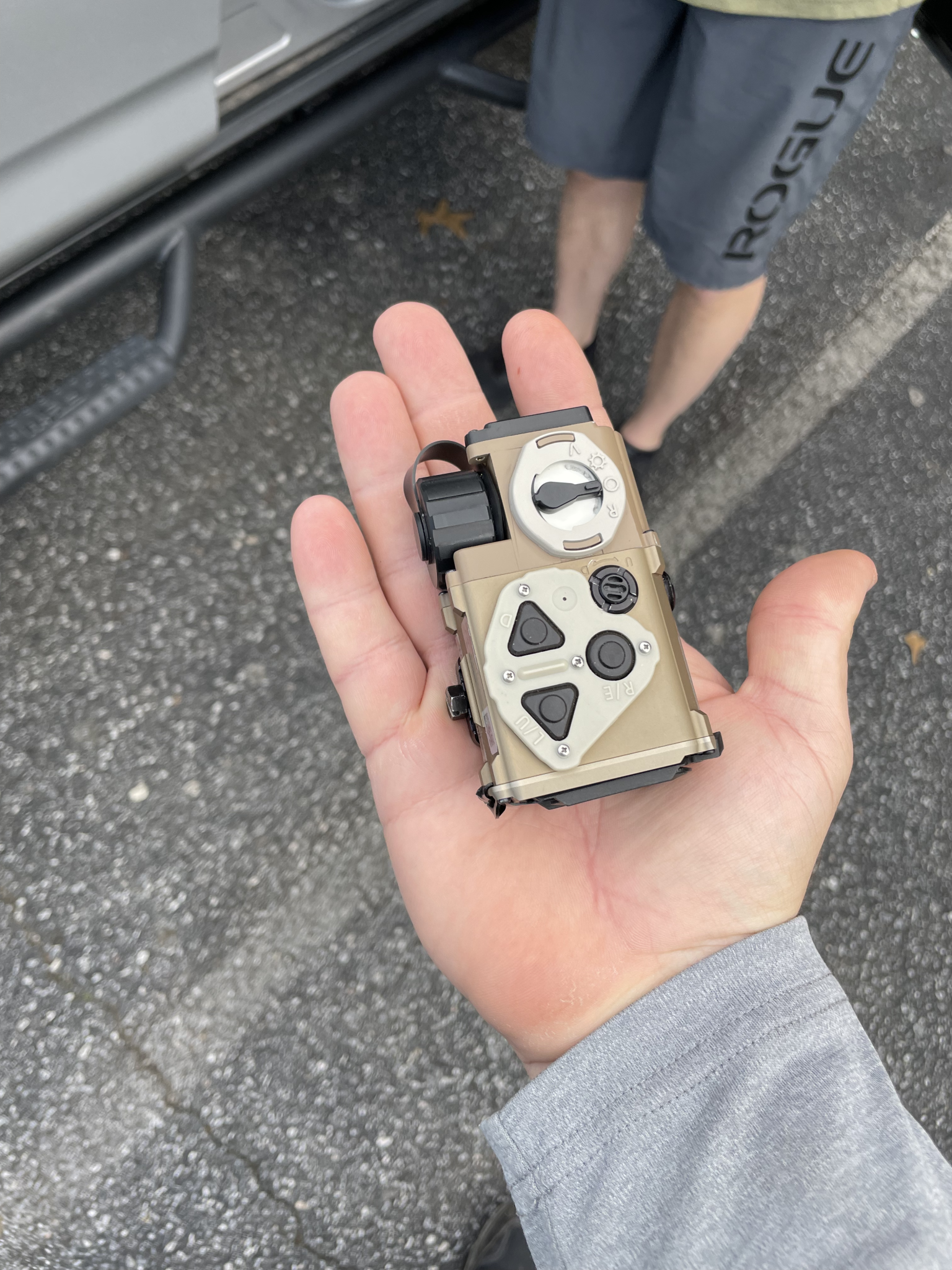

Here's the page. I had the idea of integrating a socket to use with a surefire tape switch or a Unity Hot button for momentary or continuous ranging. Couldn't really figure if I should go with a high quality 3D printed housing or a CNC machined aluminum housing.
Reactions: The Durk
I like how you’ve got it sitting low on top of the optic. My radius sits up quite a ways and that can limit use around barricades or foliage. Being able to use a Modbutton would be great, The radius button is terrible. Having the screen on a swivel is smart, but putting it on the left side of the rangefinder limits use to only right handed shooters. I know it’s only 15%ish of shooters but it takes it off the table for someone like me. Cool design though.
I am probably going to figure out a way to make the display Ambi. Trying to keep everything simple.

So after looking through some of the LRF modules available on the market. My initial concept art is much to large. I believe I can HALF (halve?) The size of the range finder. I'm currently working on a model of a prototype in Fusion 360. This is so exciting. Projected rangefinding ability is around 5km (~3miles).
