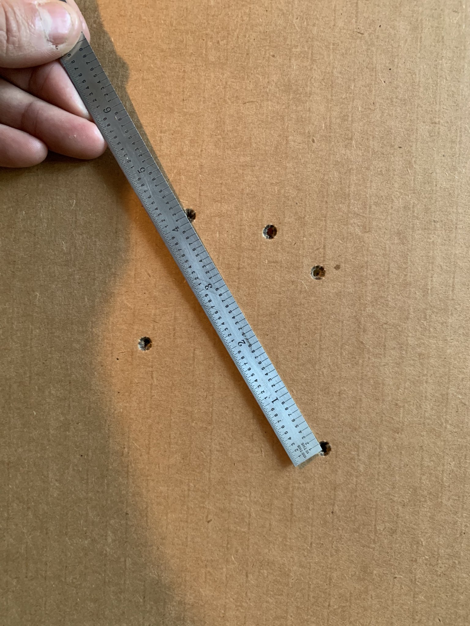

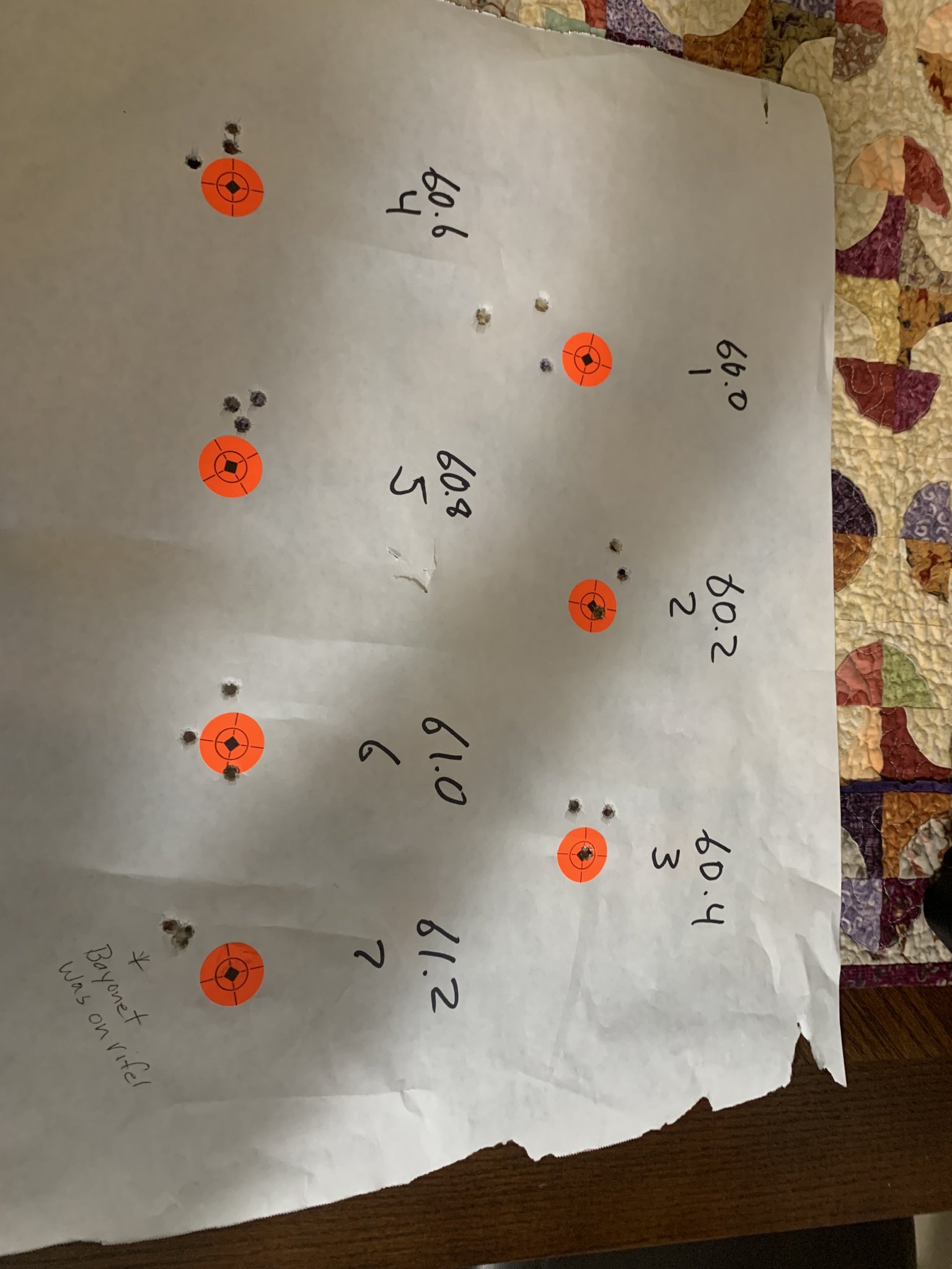

This was my first attempt at load development

yes exactly what I did but it was really bad
If that’s what you did then it’s not surprising. Probably shoots like shit at 100 to
Shoot the loads above at 500. Probably be much closer to what you want

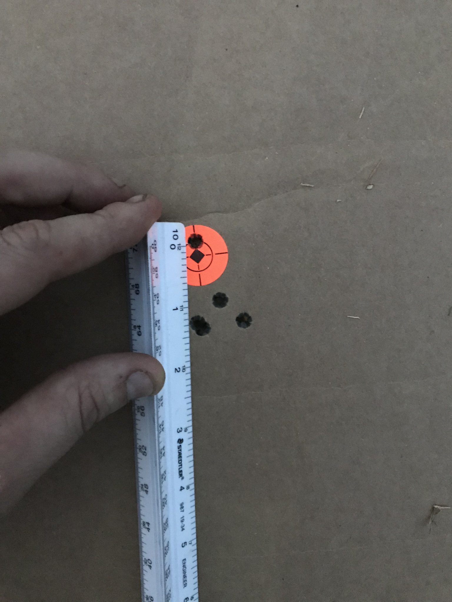

Here’s a 5 shot group at 500 yards from my fclass 284.

It’s not hard to get even MOA at 500. But you need to put in some effort

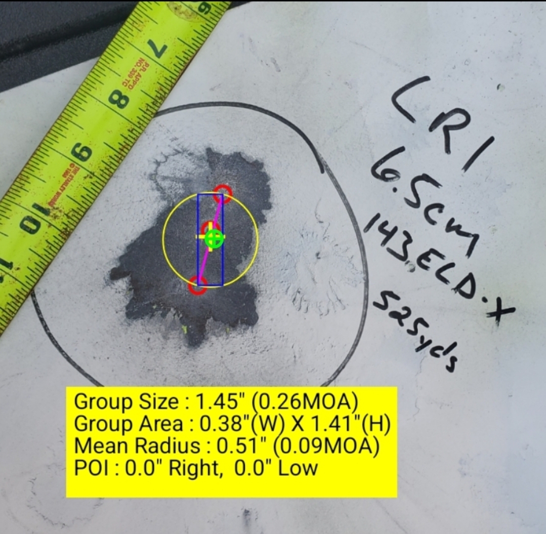

Since people are posting 500yd groups, here my group on my hunting 6.5cm with a 2.5-10x42 scope.

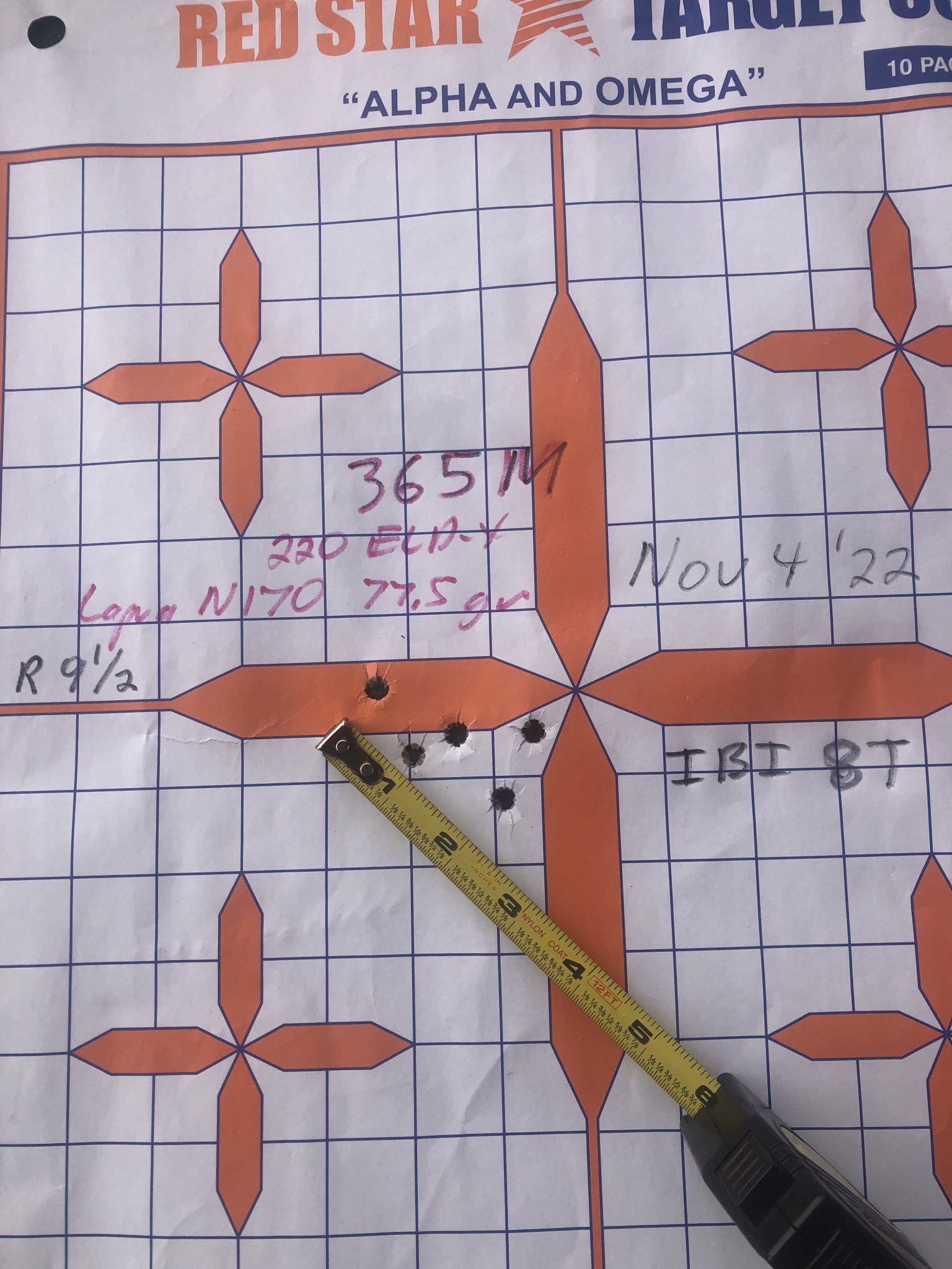

This has to be a gag thread if the OP is an actual F class shooter. This is my 300PRC Howa in an Oryx with an IBI barrel.
