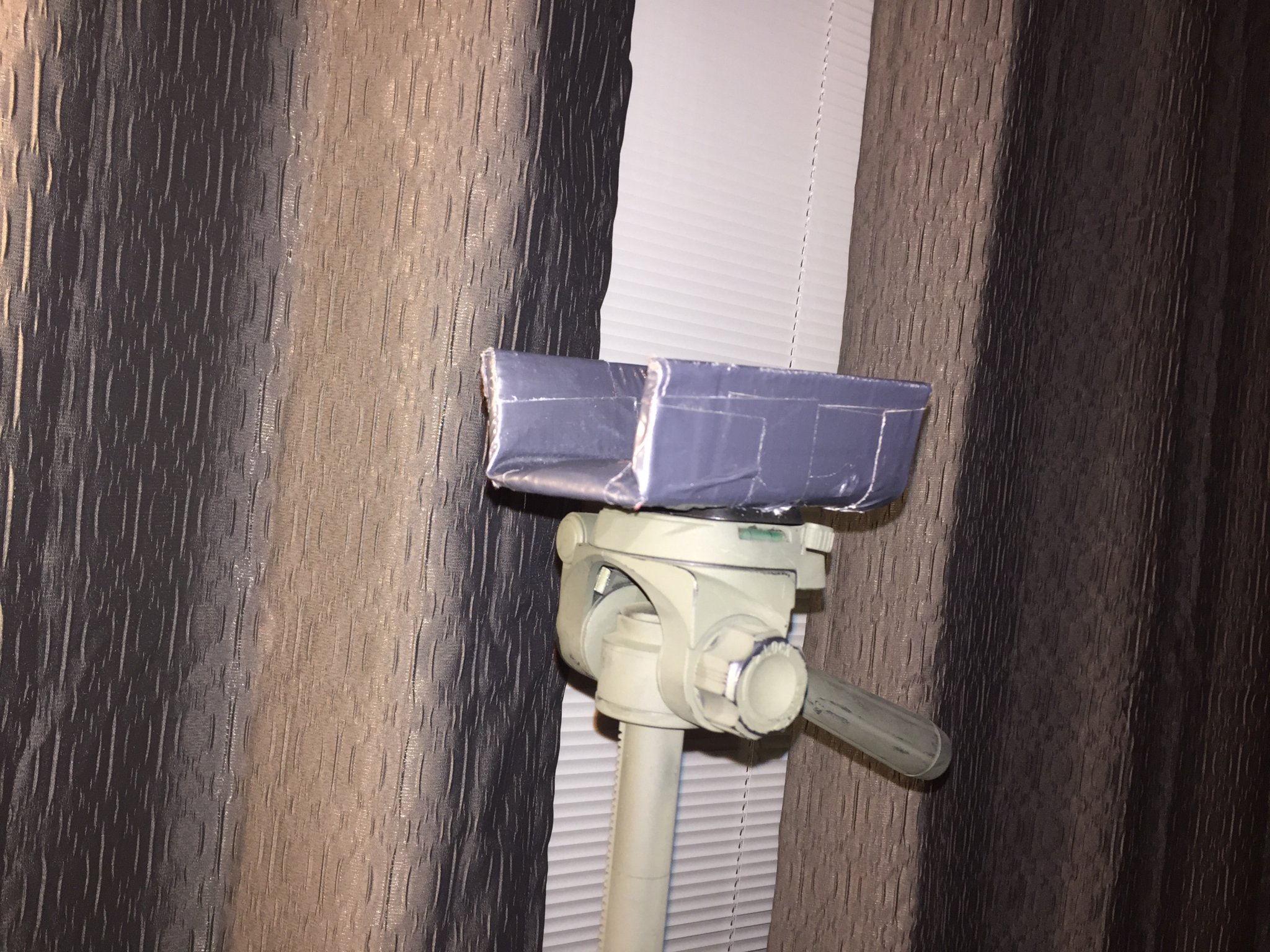

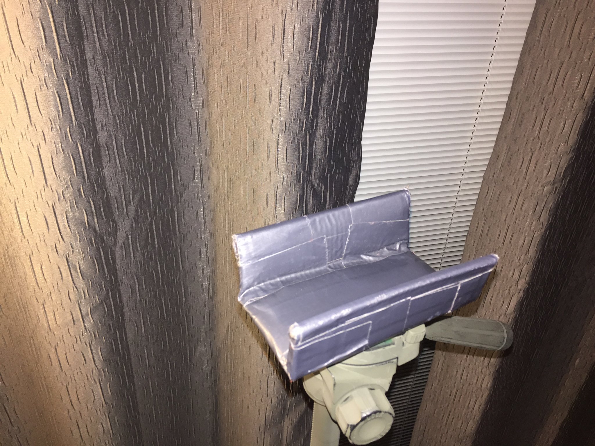

Here is a cheap one i did that the rifle rest on. No ability to clamp it down. Cheap metal folded and pad wrapped with duc-tape.

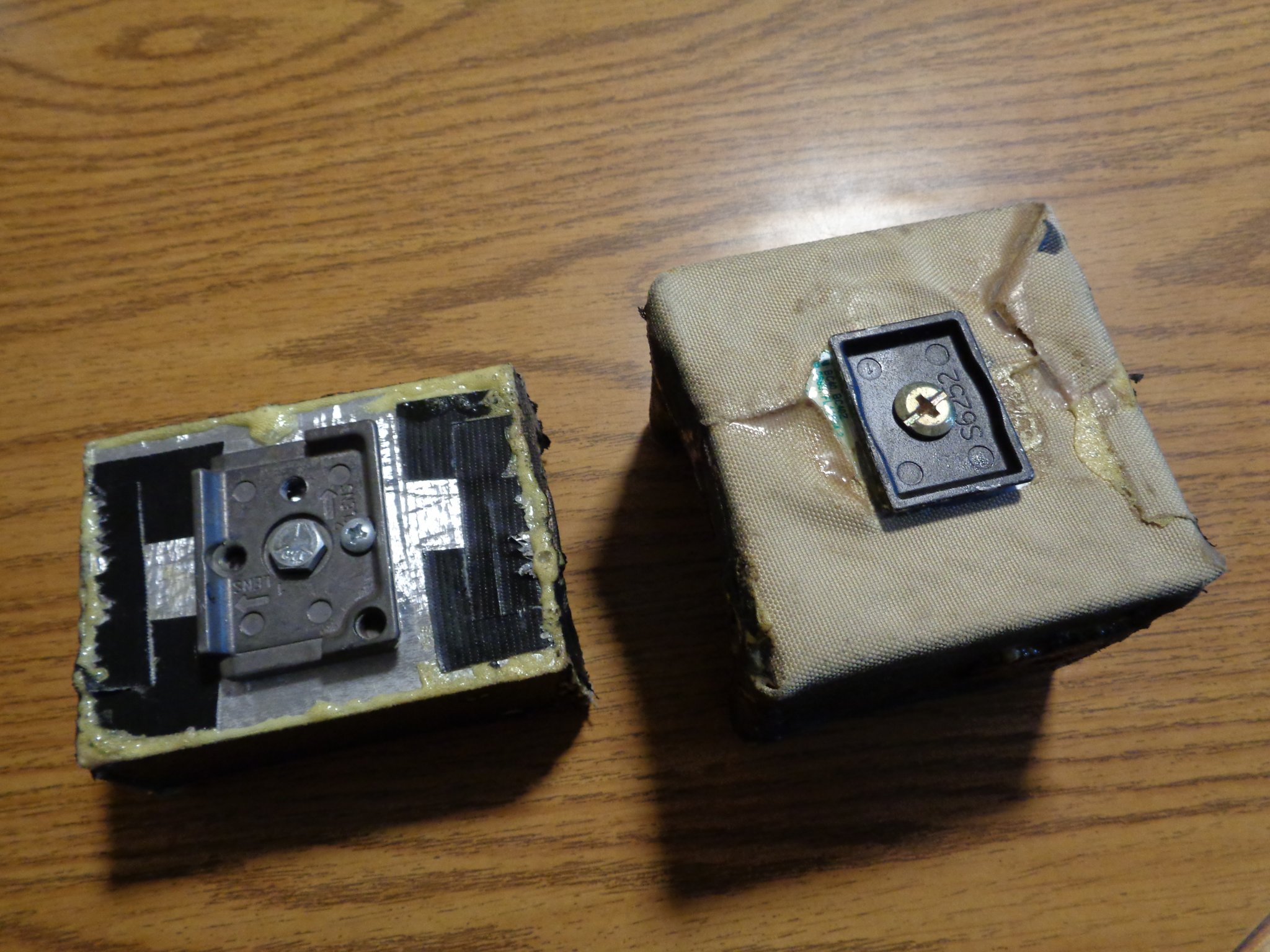

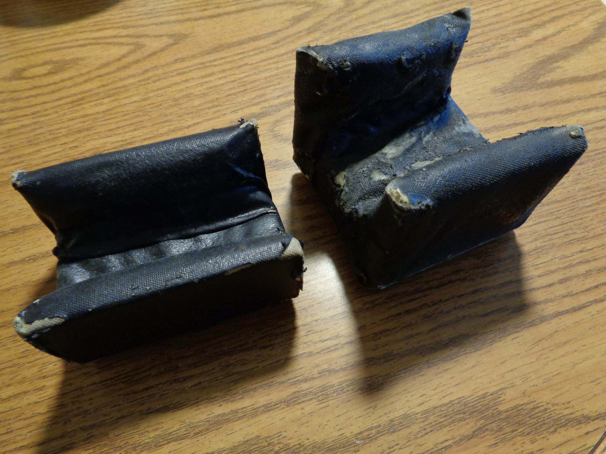

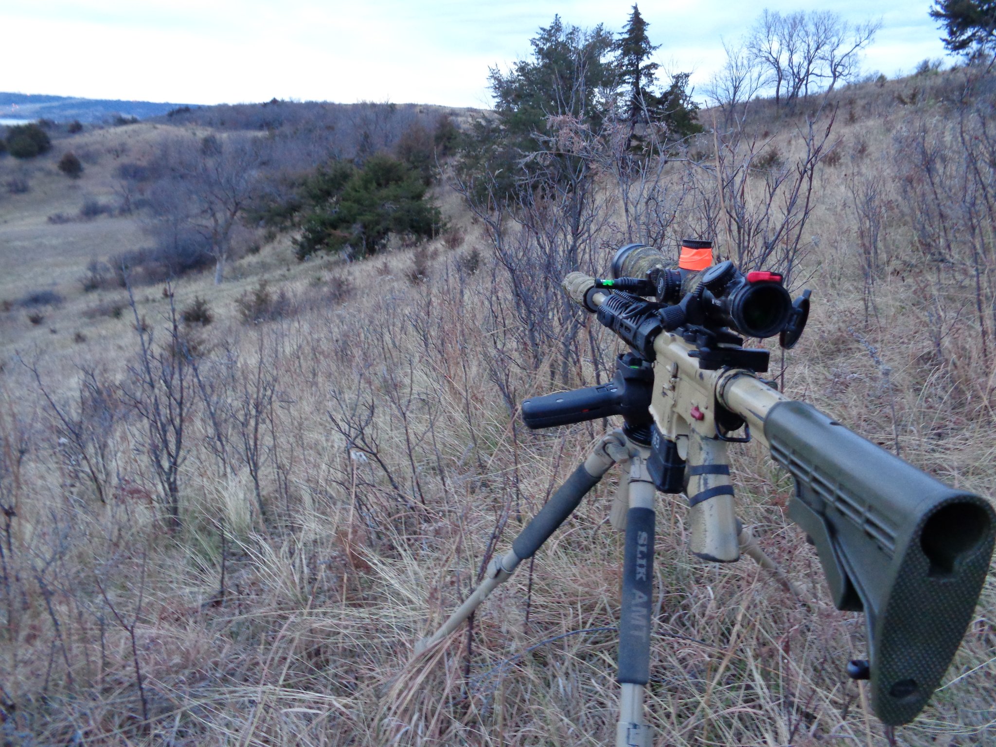

I have tried PVC schedule 40, cut length wise and threaded 1/4" -20 and used it until I came up with a better option. Now I use about 4" aluminum U channel, glue dense foam to it via Gorilla Glue, wrap it in heavy duty canvas, paint it with rattle can of your choice, and finally use Shoe Goo to add some rubberized texture to the inside of the channel. I have used this mount with various tripods out to a mile with great success. The downside is that the rifle is not "tied" to the tripod. A new option I am trying is the Magpul M Lok RC2 connector that works with my Manfrotto RC2 grip ball head. For predator hunting when shots may be out to 500 or as close as 30 yards behind you, I will be investing in more Magpul M Lock RC2 connectors.

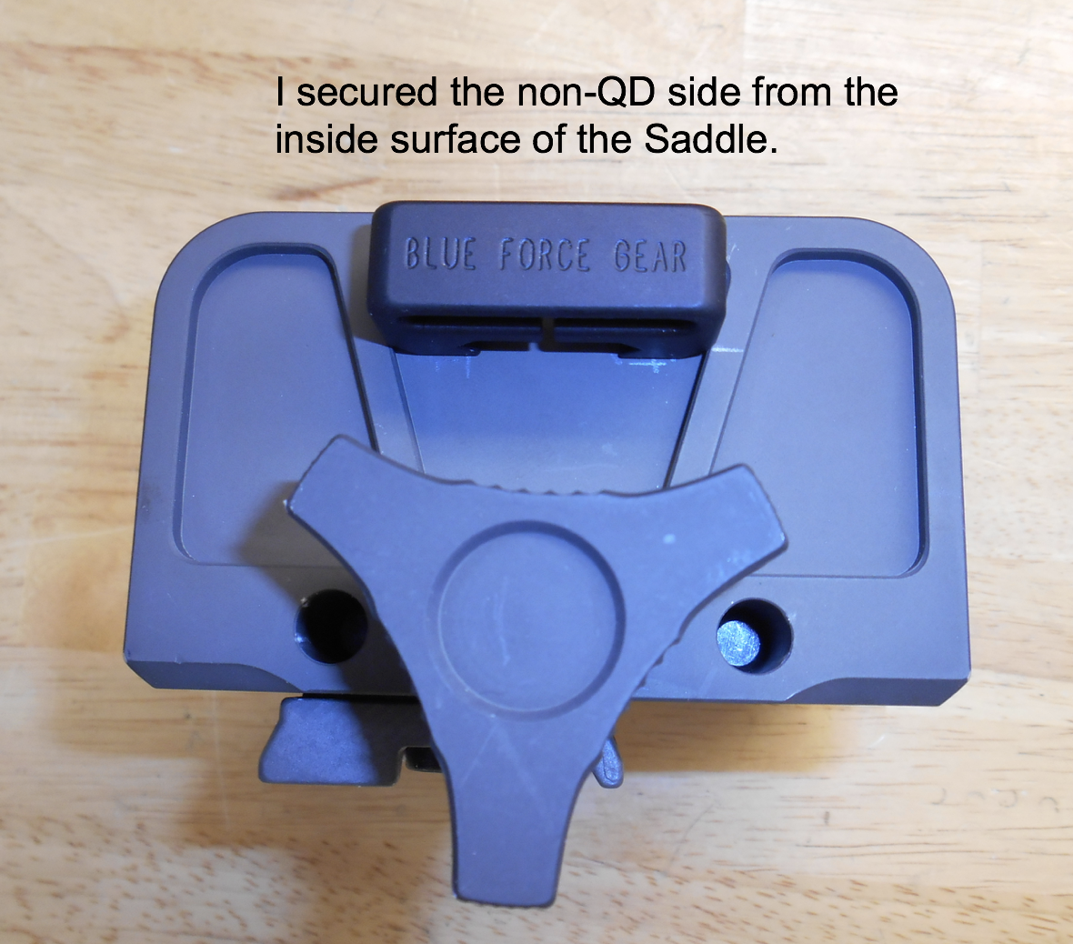

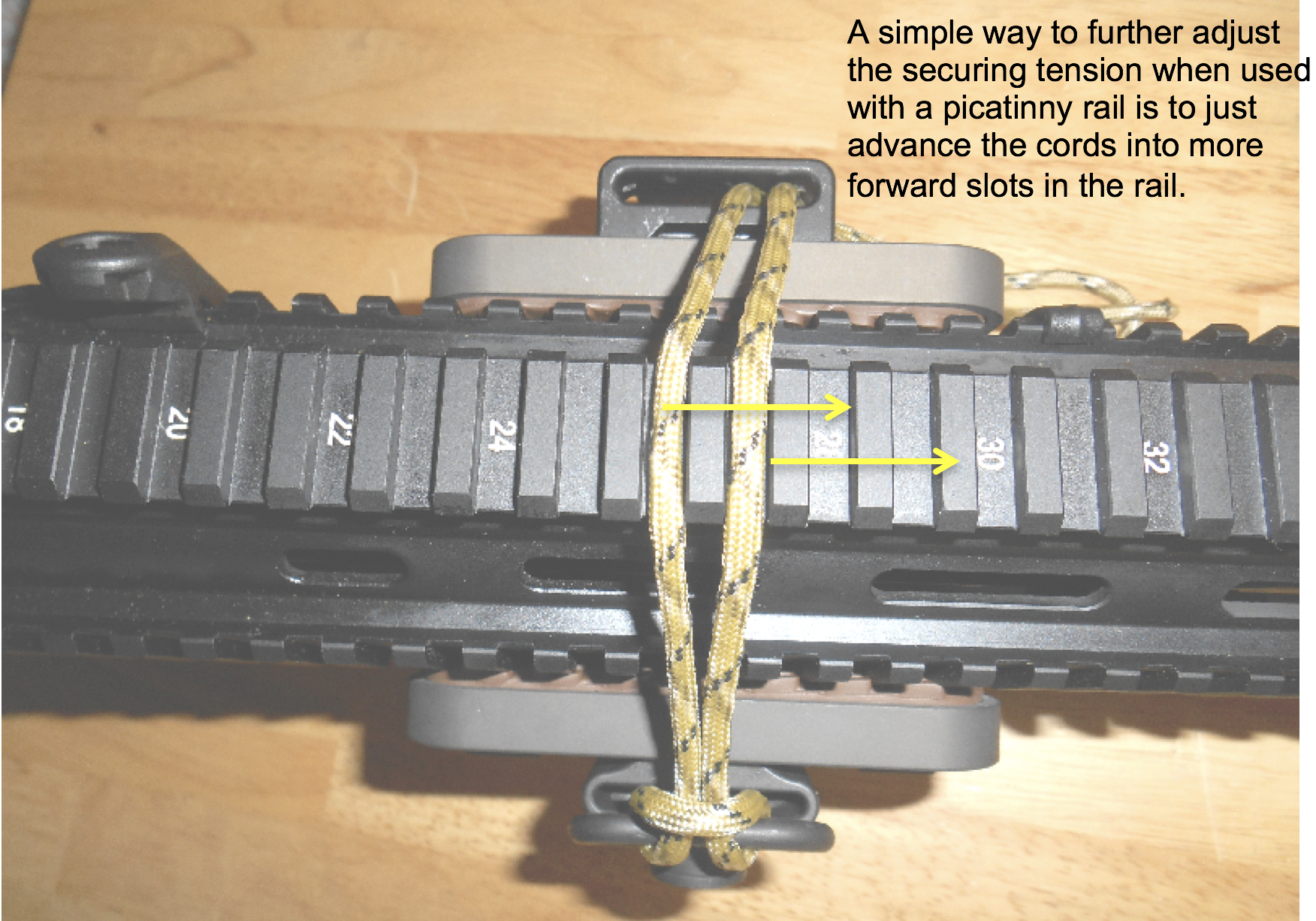

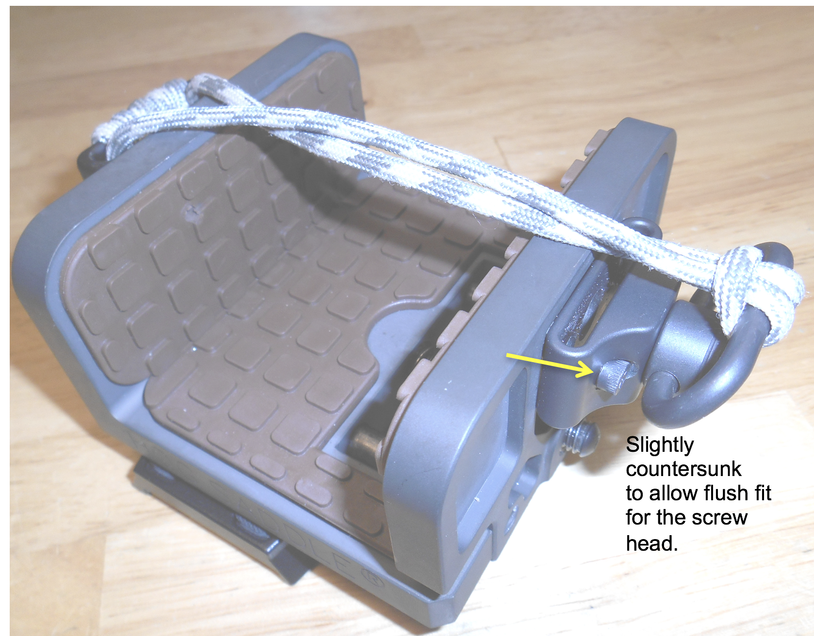

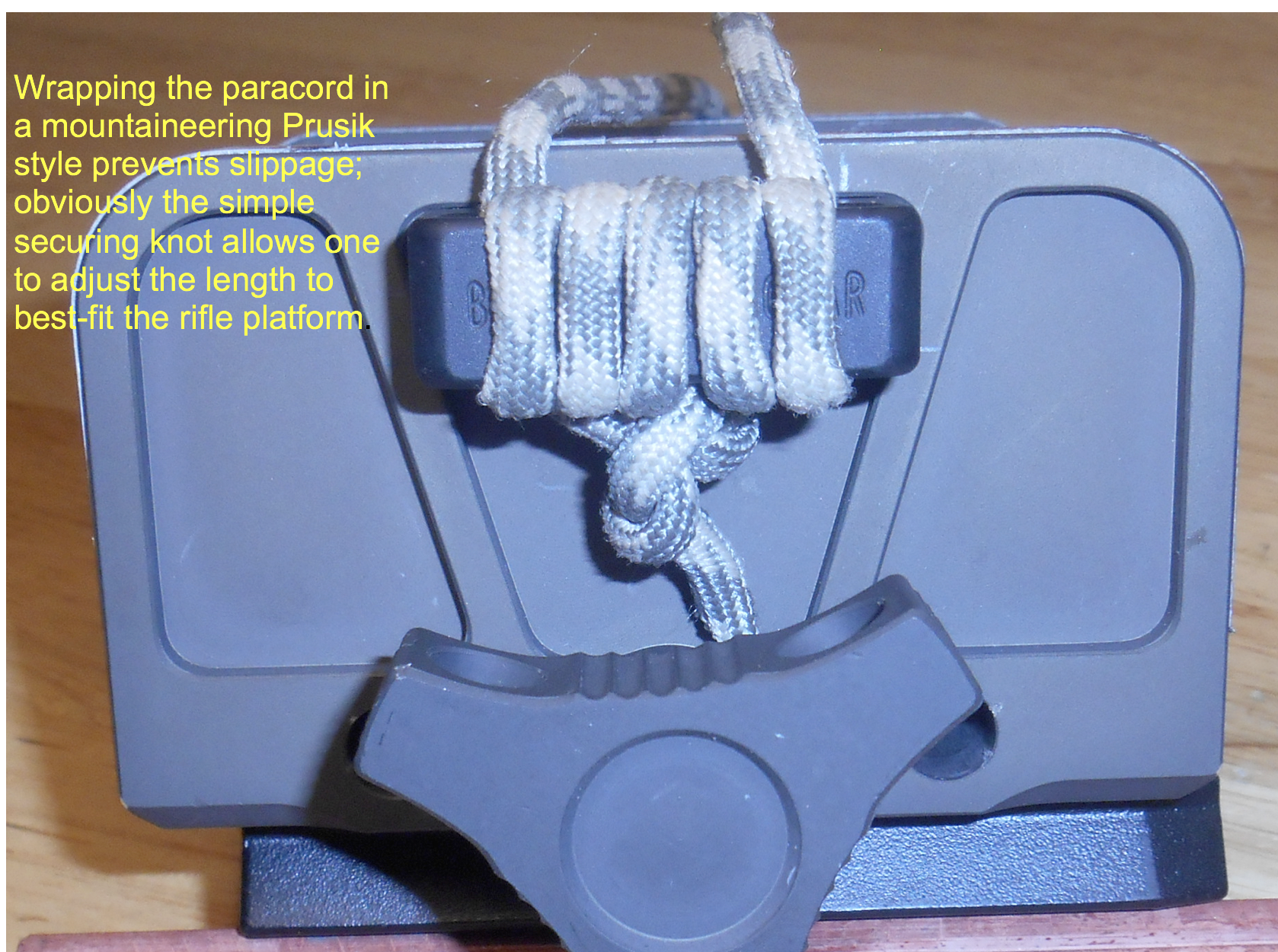

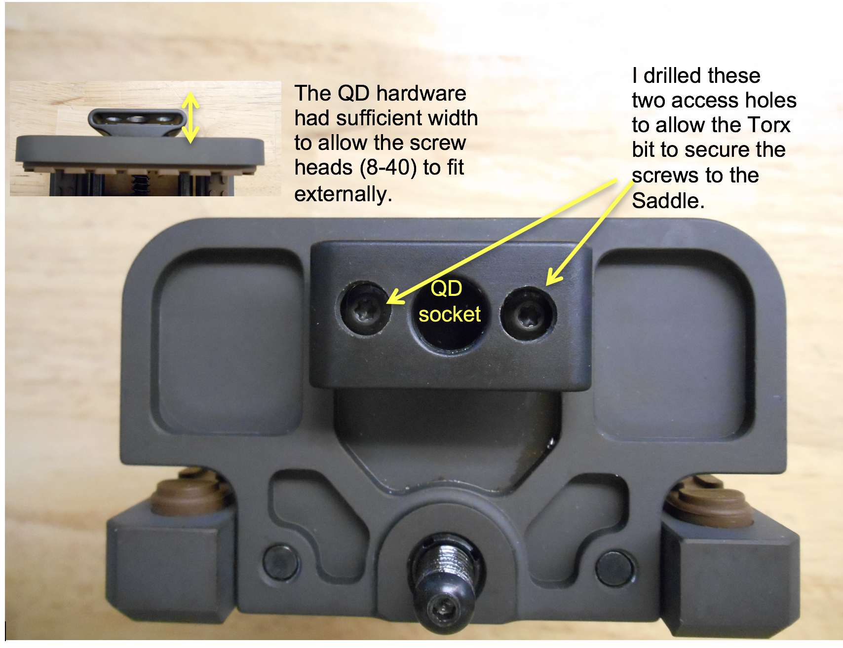

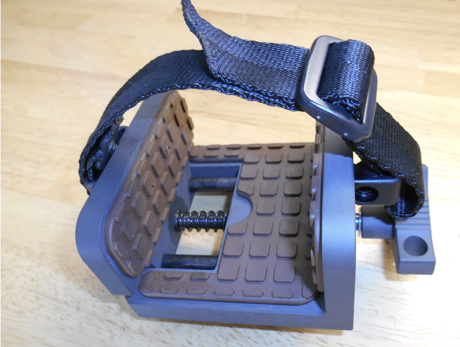

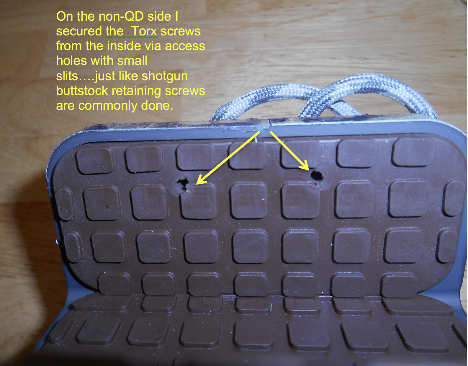

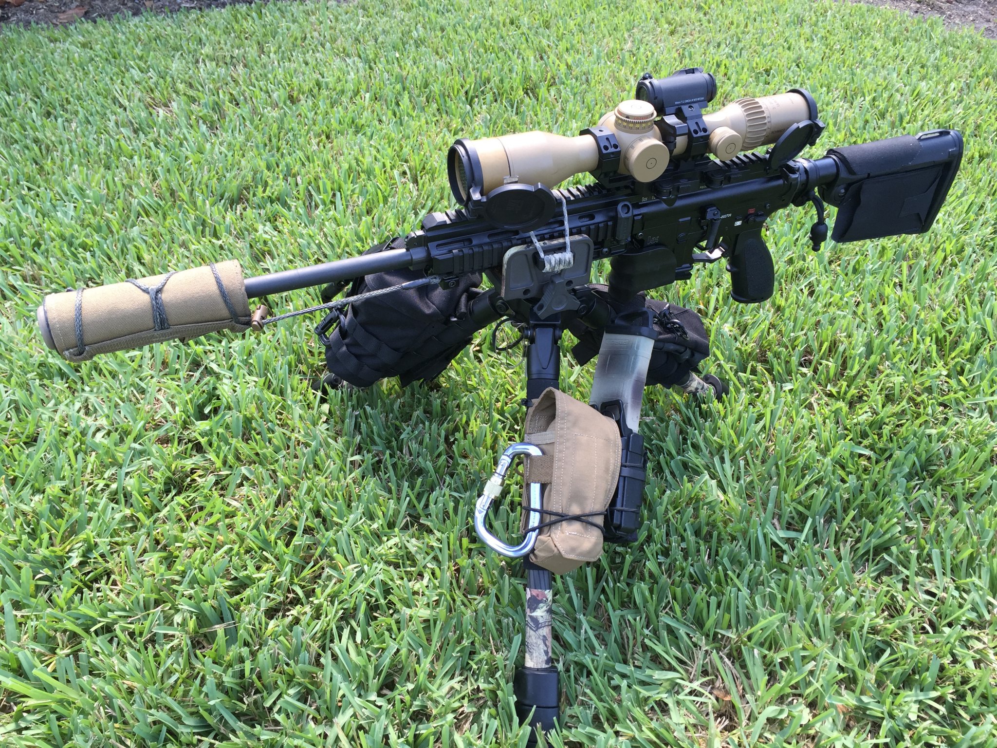

To address the issue of securing the rifle in a HOG7, I modified mine to HOG8. Some variation of the mounting straps illustrated maybe useful in your efforts to "clamp it down". I just used some Blue Force mounting gear.

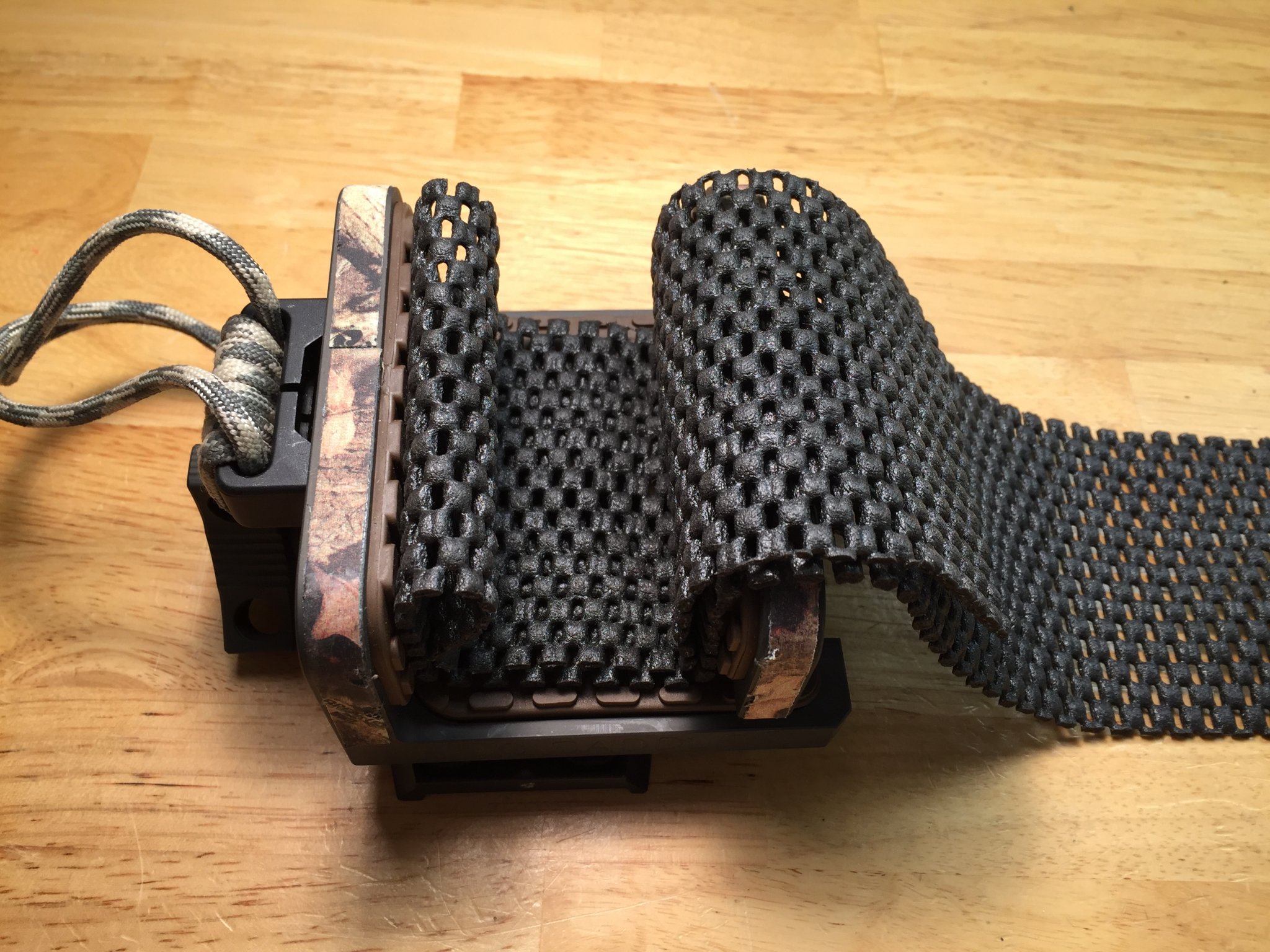

Using the QD system is quick and secure. I set the tension of the paracord, then push down the swivel so it locks in place like a canning jar top mechanism. I also use a liner of non-skid material for some rifles. A strap system is shown as well. Cammo Gorilla tape bling just because.

I have found that you want the channel to match the for end of your rifle. You don't want it loose or it becomes unstable. I fix this by adding enough foam. I have also found that if the channel is too short, it is also unstable. 4-5 inches seems to work for me. I use Manfrotto and SLIK heads so I have several mounts that work with various heads. Hope this helps.

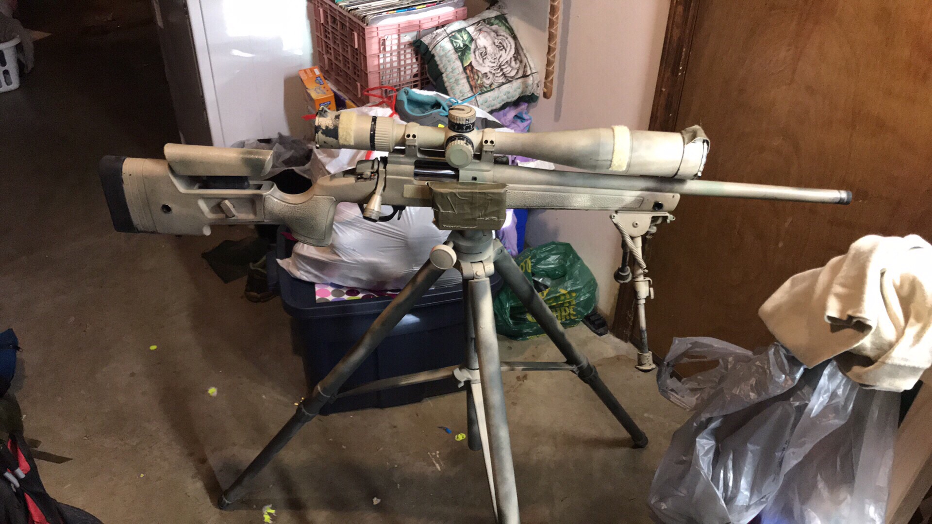

I built the same type of rest for mine as the OP, but used an old Army sleeping mat for padding. After wrapping that in tape a and a little squeezing on the bracket, my Bergara can rest in the tripod without me holding it. Not as secure as a HOG for sure, but its what I have for now.
