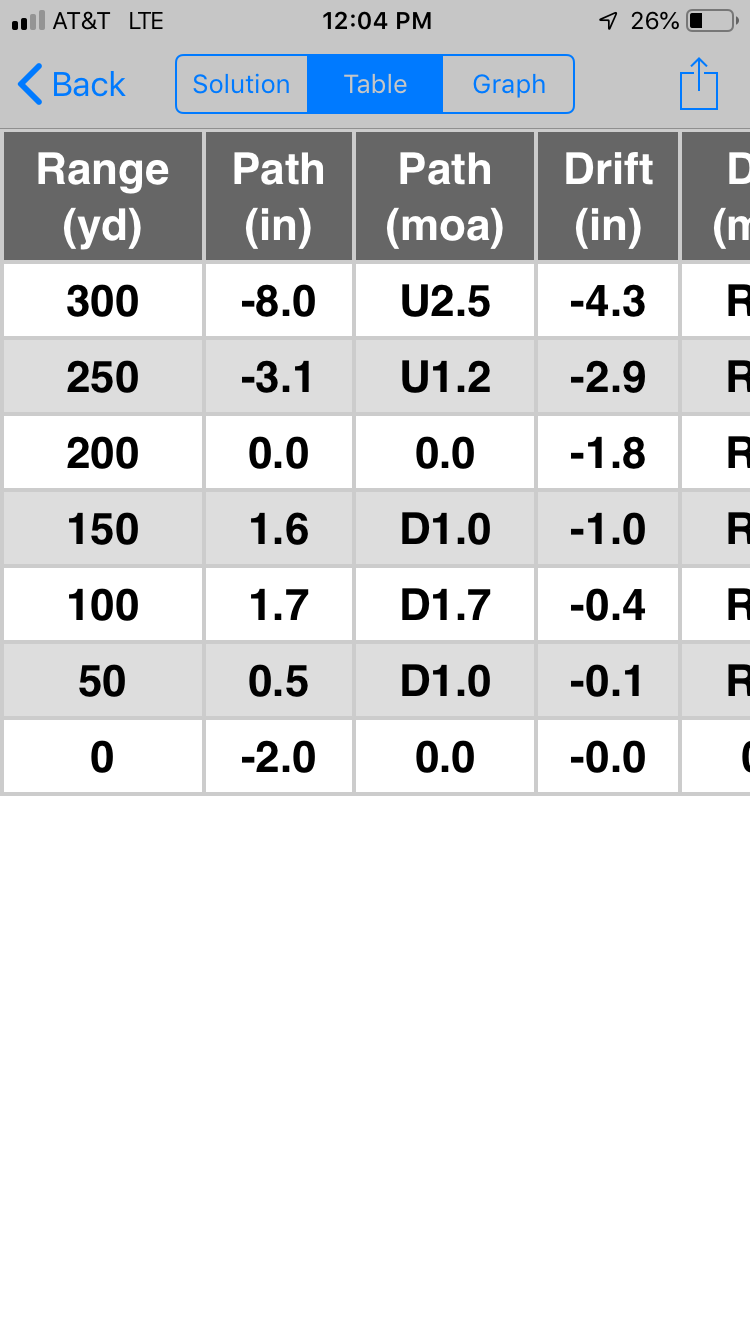

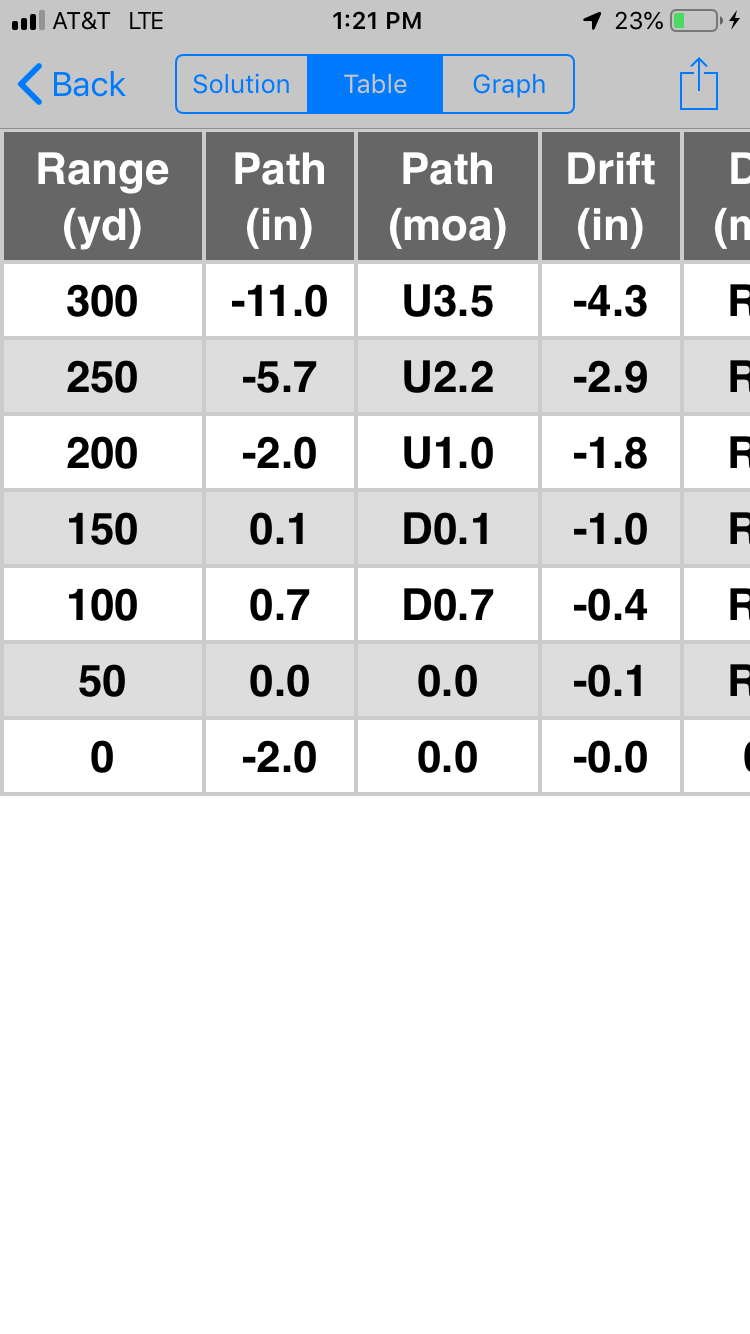

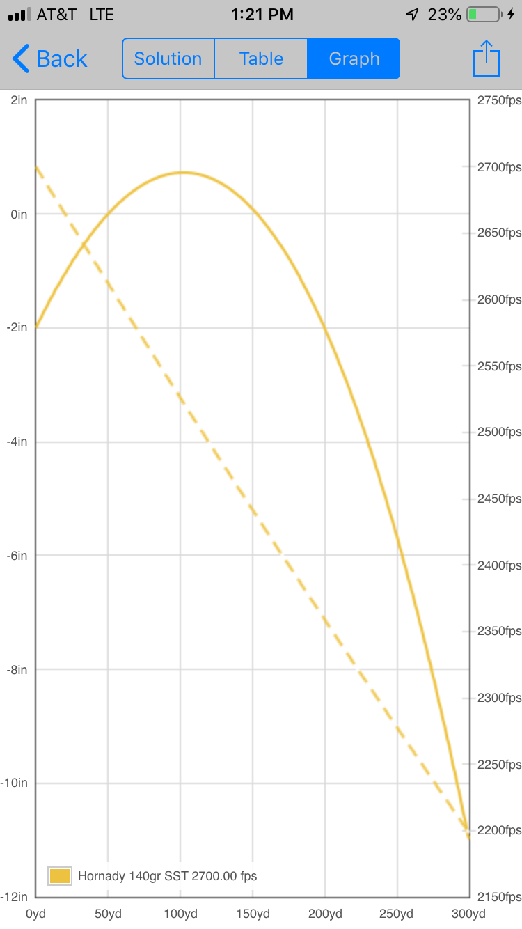

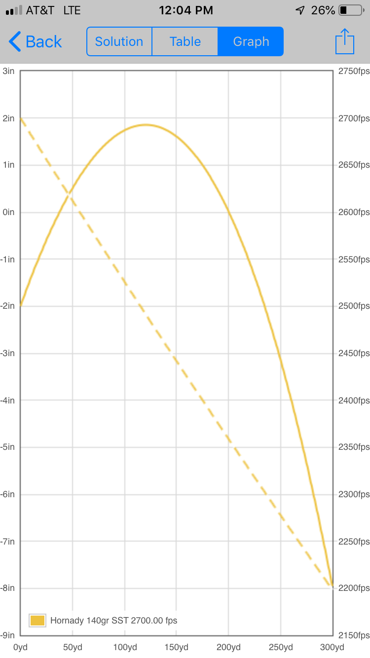

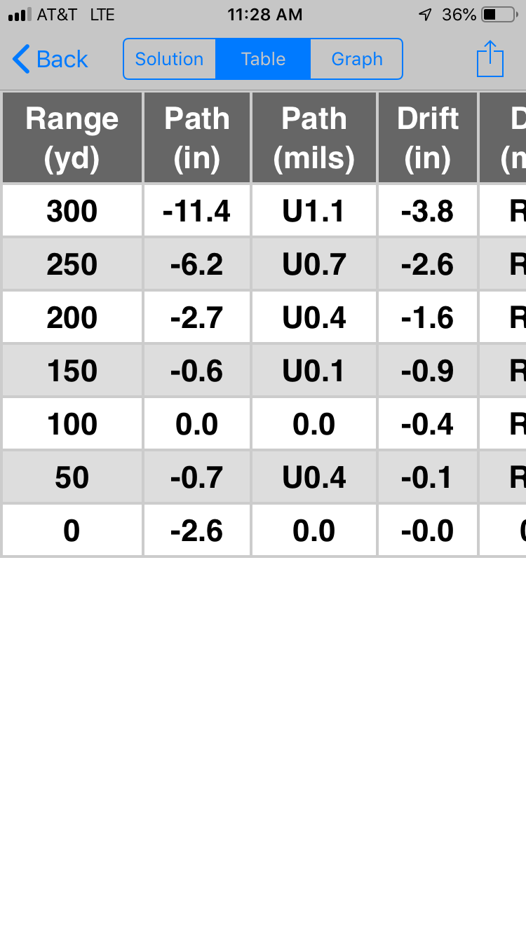

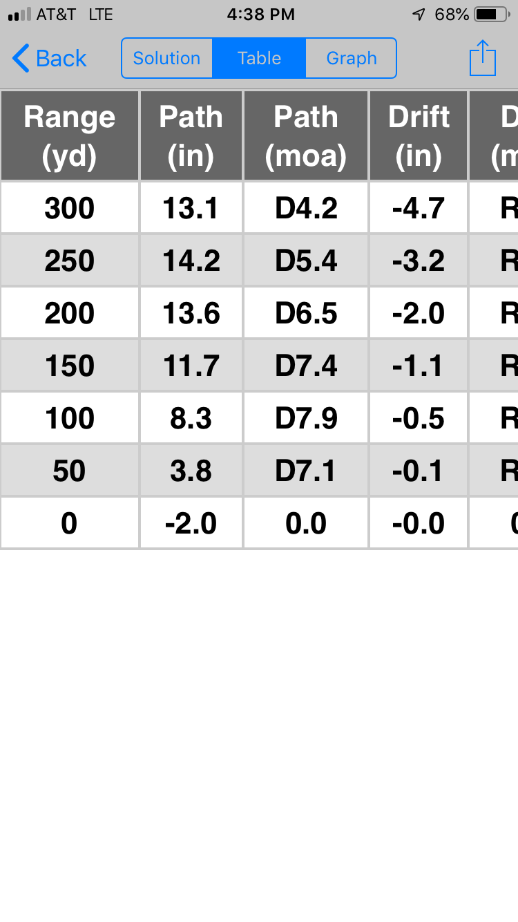

Here’s 2 6.5cm drop charts. With 140s. The first is a AIAX with a higher scope height. The second is a Rem 700 with a low scope height.
@deersniper Can post a drop chart showing a 200 yard zero and in 25 yard increments? Or better yet, 10 yard increments.. this should give the OP a better understanding of height over bore and trajectory. Assume a 2" scope height over bore.

140 6.5 at 2700 FPS 2” scope height
View attachment 7450635View attachment 7450636

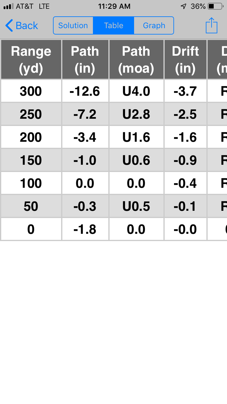

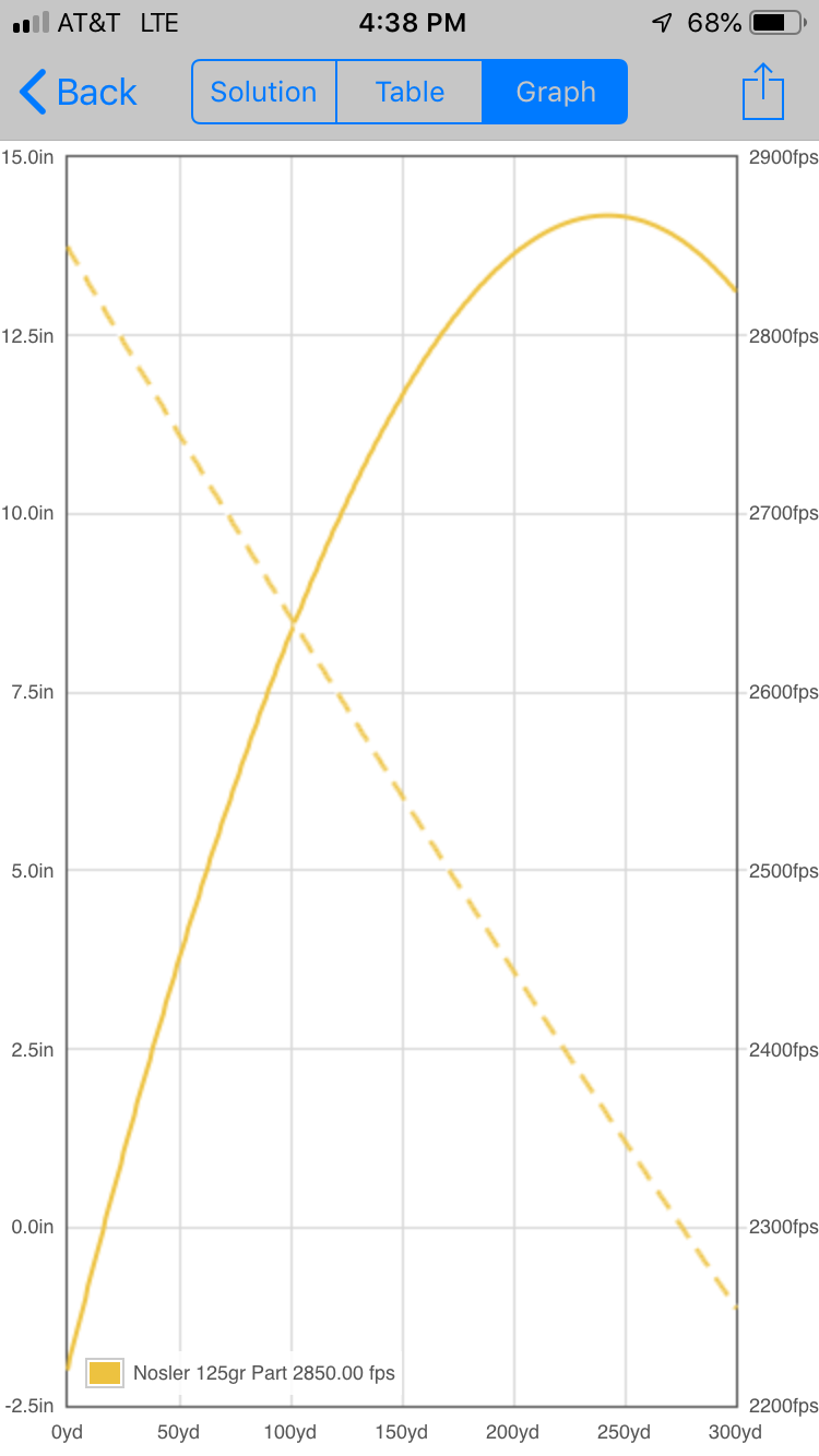

Here’s a 125 at 2850
1” high at 25 is a terrible zero:
You really need to measure your scope height and muzzle velocity and put them into a online calculator and pick a good zero for you.
Better yet zero dead on or 2” high at 100 and shoot paper at 50, 150, 200 etc and record your drops
