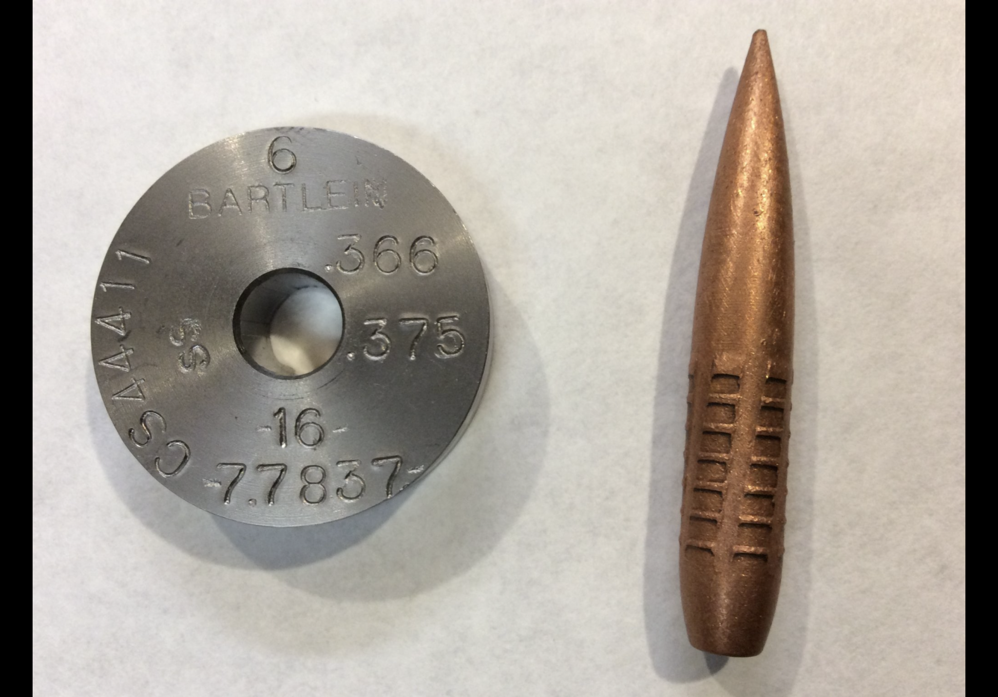

If I am reading the barrel stamps correctly, the rifling of this 6-groove .366/.375 barrel starts at 16-inch/turn twist-rate an increases to 7.78-inch/turn near the muzzle. The rifling helix angle would have increased from an initial 4.21-degrees to a final 8.61-degrees as the engraved bullet traversed the barrel in firing. The rifling marks on the recovered copper bullet suggest several things to me. The helix angle on the left (non-driving) side of the facing land engraving mark appears to be at the initial 4.2-degree helix angle. The copper displaced during original engraving of the driving rings remains only along the non-driving side, and mostly toward the front of the bullet. The rear-most driving ring is the area of the copper bullet where the contact pressure against the bore was greatest during firing. As the land driving the spin-up of the bullet rotated clockwise with increasing helix angle, the marks indicates that it "pivoted" about the rear-most ring position. The left-ward side pressure of that pivoting land wore away the trailing copper displacement marks there, just as all of those marks are gone from the right-hand driving side of this top-side engraving mark. The engraved width of the rifling mark also more closely matches the narrow land toward the rear of the bullet. The front-most end of the engraving mark is significantly wider than the narrow land itself. I cannot read the helix angle along the right-hand side of the mark due to wear, but it seems to be less than the full final 8.6 degrees--indicating that most of the twisting of the copper shank was elastic and it simply sprung back as the bullet was exiting the muzzle.
This extreme gain-twist example is great for studying its effect on fired bullets. This copper bullet survived quite well. Thanks again for the information.
Reactions: gnochi and Geno C.

Just for the record the pictured barrel cutoff and bullet. The barrel is being used in a 375 Snipetac that is shooting the Warner 361s and the Badlands very well in the ELR game currently lately.
osoh
