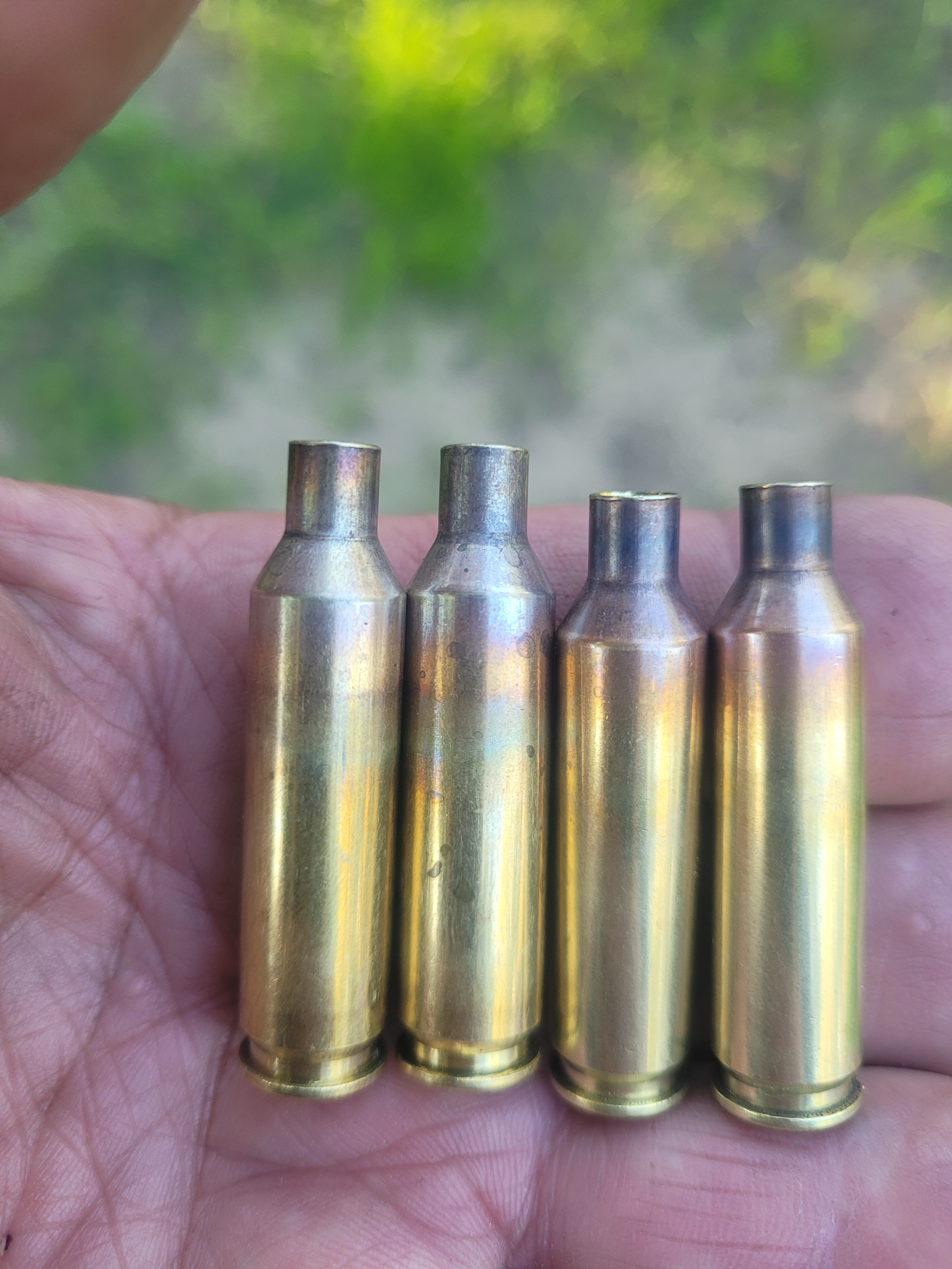

Because cases cool off so fast, quenching them really doesn't change anything and your results, in terms of changes in hardness, is no difference between the two. The quenching just adds more work to your process. . . nothing more. You have to get the neck and shoulder really hot for quite a long time (relatively speaking) to have any problem with the case body getting too soft. Like I'm at 9-10 seconds in the flame where the neck glows red (in a darkened room) for a hair over second and it gives me the hardness, as I measure with my tool, that's equal to my virgin Lapua brass. Here's some .308 cases that I necked up and sized from Sig .277 Fury hybrid cases, which I just fired a couple days ago getting a nice 4.7 SD and ES of 15 from these 10 cartridges (keep in mind that the color you see is not a good indicator as to how much grain structure of the brass is being changed):

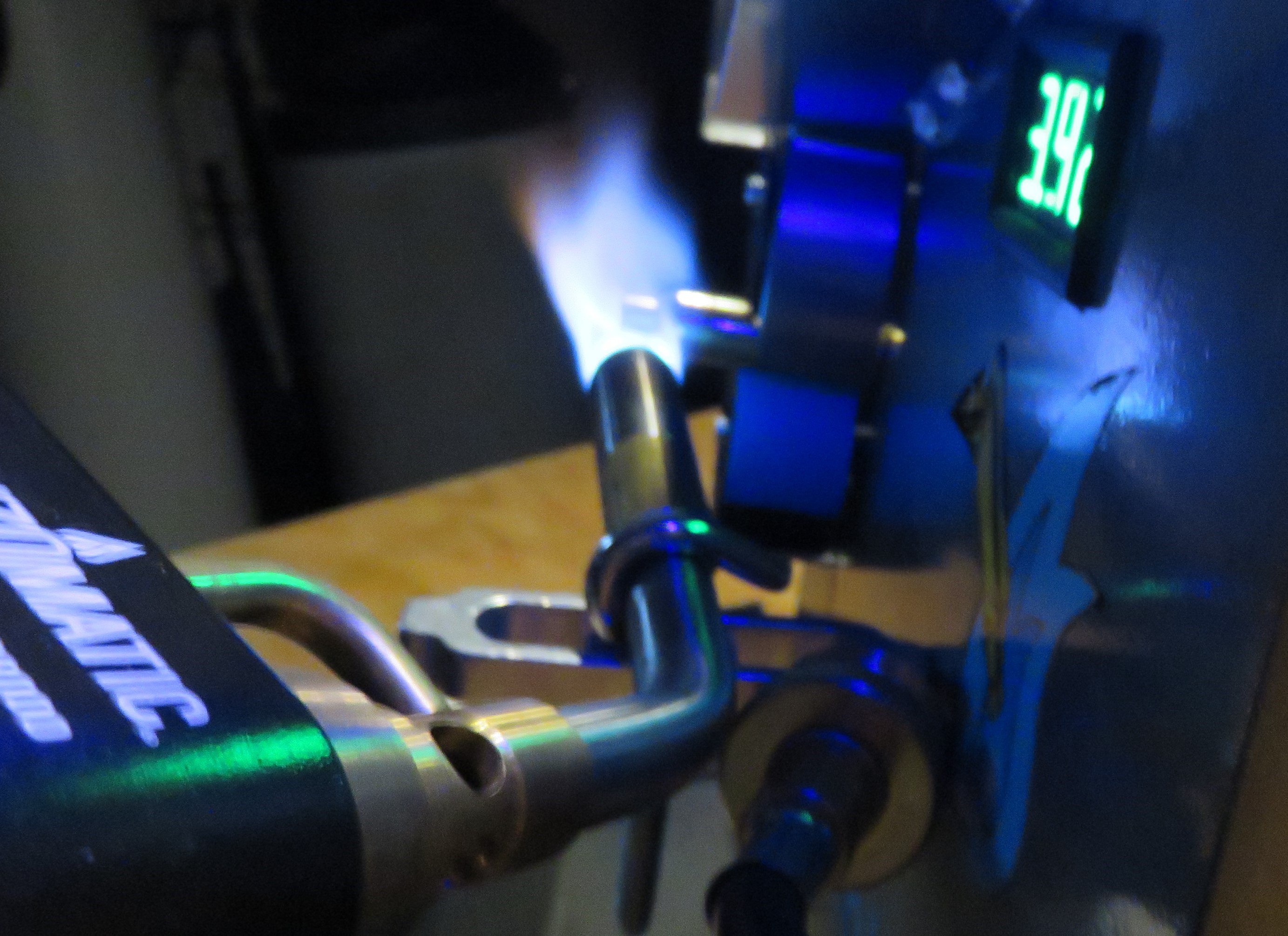

From what I can make out in this picture of yours, it appears the center of the flame in pointing at the shoulder-body junction??? It's recommended that it should be pointing to the neck-shoulder junction where the neck can take on the heat the fastest and the most grain structure change.
If "3 1/2 -4 count" is like 3 1/2 -4 seconds . . . that's far from enough time to do much of anything for a decent annealing job. Looking at that flame (I know the lighting is hiding a lot), even 5-6 seconds isn't going to do a whole lot. When I used a flame like that one and left the brass in until I was a color change (about 5 seconds), I found my necks were much harder than I hoped. . . way harder than virgin Lapua brass, which is the standard I try to reach. I switched to a swirl flame for more heat and looked for a glow and dropped the cases out the moment it began to glow (as seen in a darkened room), which as still 5 to 6 seconds for .308 cases. Those cases got a little better, but still not down to that standard I'm looking for. That's when I upped my time to 9-10 seconds (experimenting first with some range brass) and found that amount of time brought the hardness a little below the standard I was after, but . . . the sizing afterward brought it up to what I was looking for.

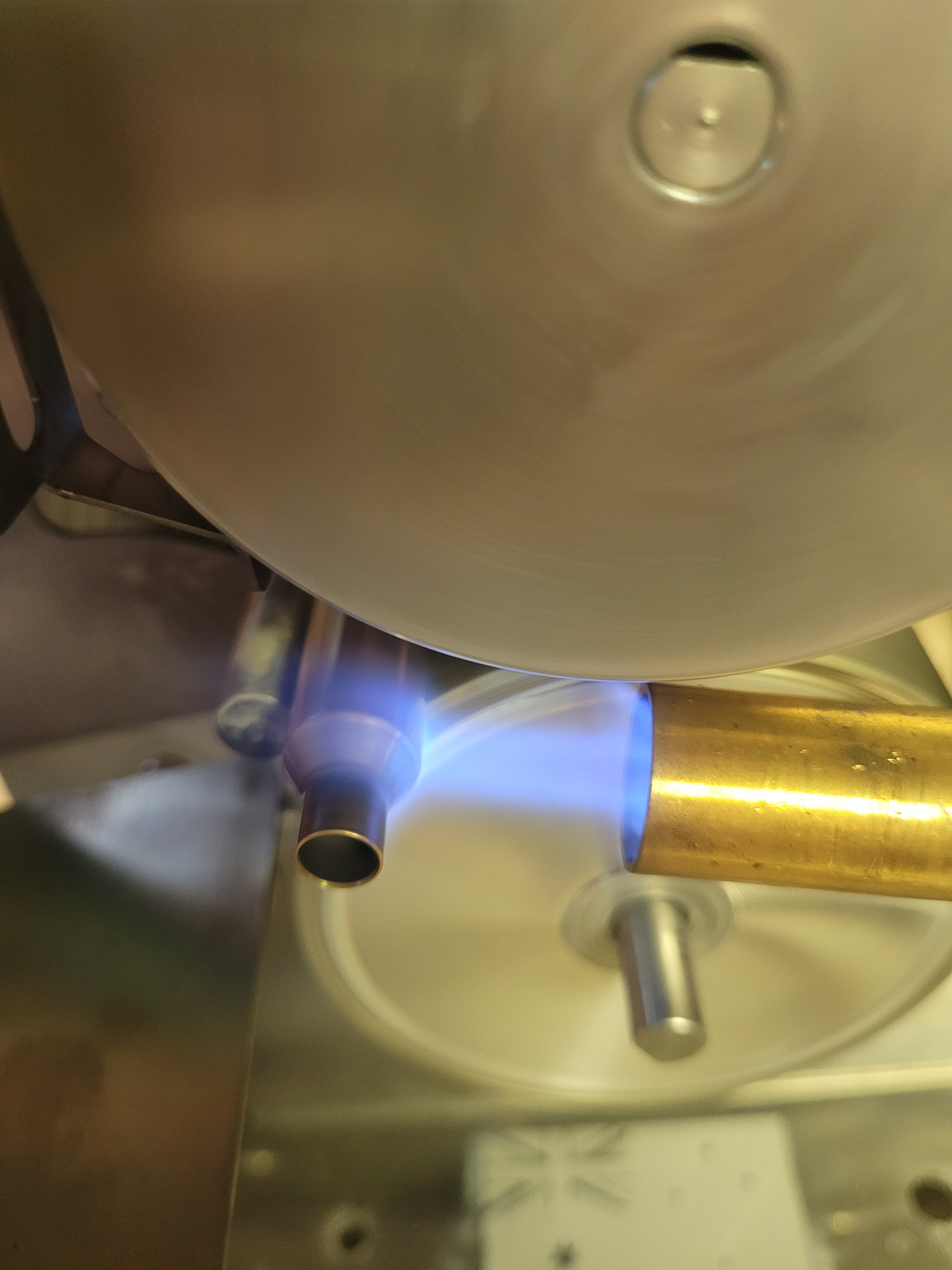

The swirl flame torch head provided some extra heat over the pencil flame, but the thing I like best about it is the flame surrounds the neck all the way to include the side opposite the torch head. That provide very even results around the whole neck and shoulder. Here's a picture of how I've got my unit set up and how it's aimed to get the annealing in the right place:

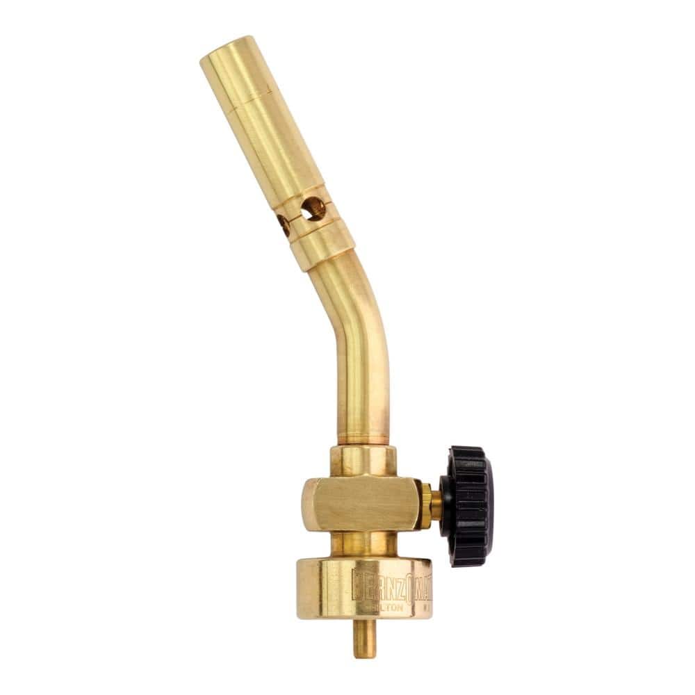

I found that using a pencil flame torch like the one below allowed for more precise heating and kept the heat away from the body.
Yes, the pencil flame is more precise, but the swirl is a little hotter and the faster I can heat up the neck the sooner I can drop the case out of the flame. And the sooner the case is out of the flame, less heat will flow down the case. That's my theory behind it. ;)
