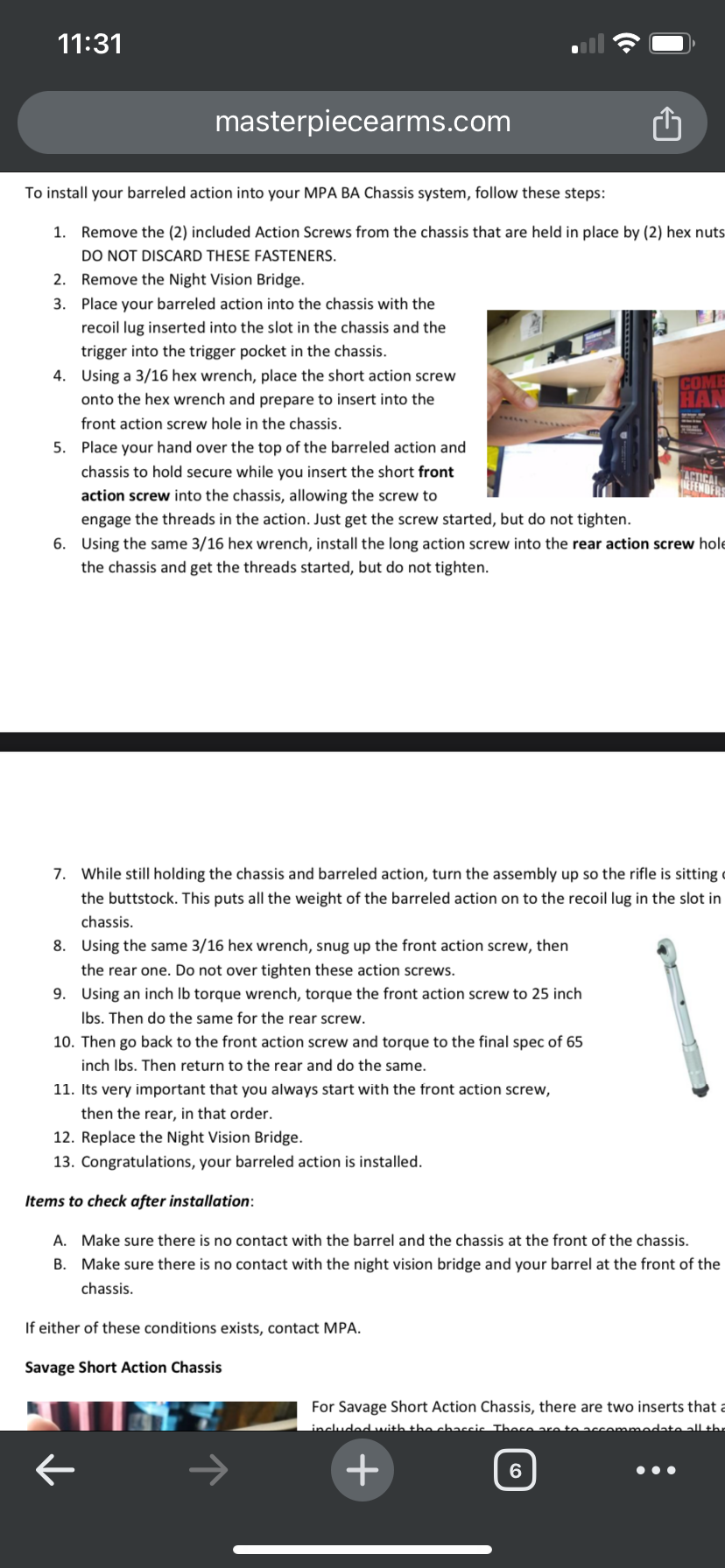

Hey all, just wanted to get some insight into what torque value y'all are setting your action screws to for your rim-x action. Getting an mpa hybrid chassis, and thinking that 40 in/lb should do the trick. Anything over that seems excessive to me...
I’m running 65 in/lbs with a manners mini chassis, but like ROB01 said run what the chassis recommends.
