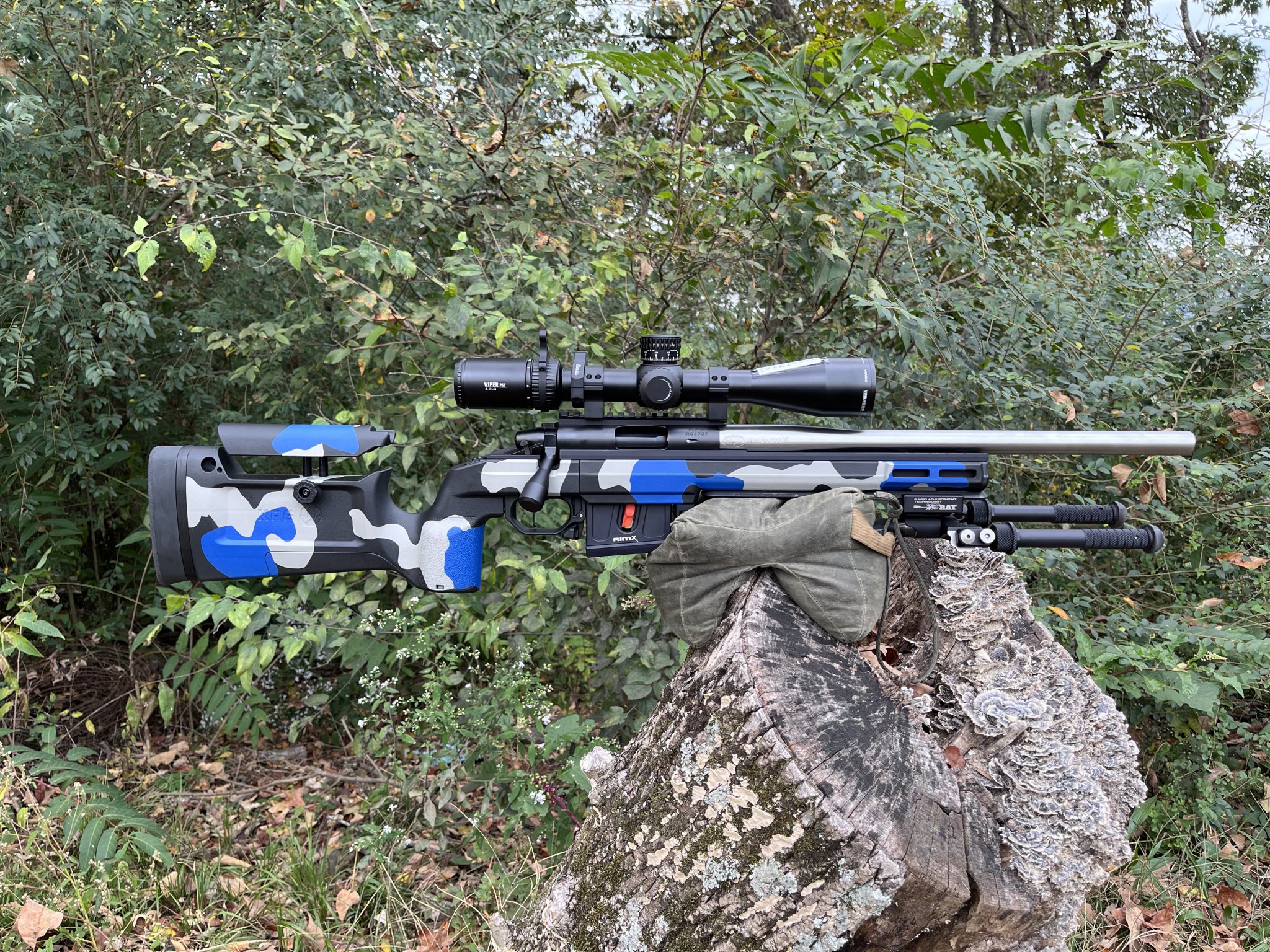

I had mine in a KRG Bravo for a little while with a 20” medium palma contour with the tuna can and it balanced alright, then switched it to the PRS1 with similar results. Then this season I switched to a 23” straight contour in the PRS1 and it now balances like a champ on most props I encounter, granted it’s now right around 20lbs but it’s worth it.
I had mine in a KRG Bravo for a little while with a 20” medium palma contour with the tuna can and it balanced alright, then switched it to the PRS1 with similar results. Then this season I switched to a 23” straight contour in the PRS1 and it not balances like a champ on most props I encounter, granted it’s now right around 20lbs but it’s worth it. View attachment 8144505View attachment 8144506
You say it not balances?
Just clarifying as I am getting a 23" straight put on my Gen 1 Vudoo now and it was in a PRS2. Glad it was a spell check error. ;)
