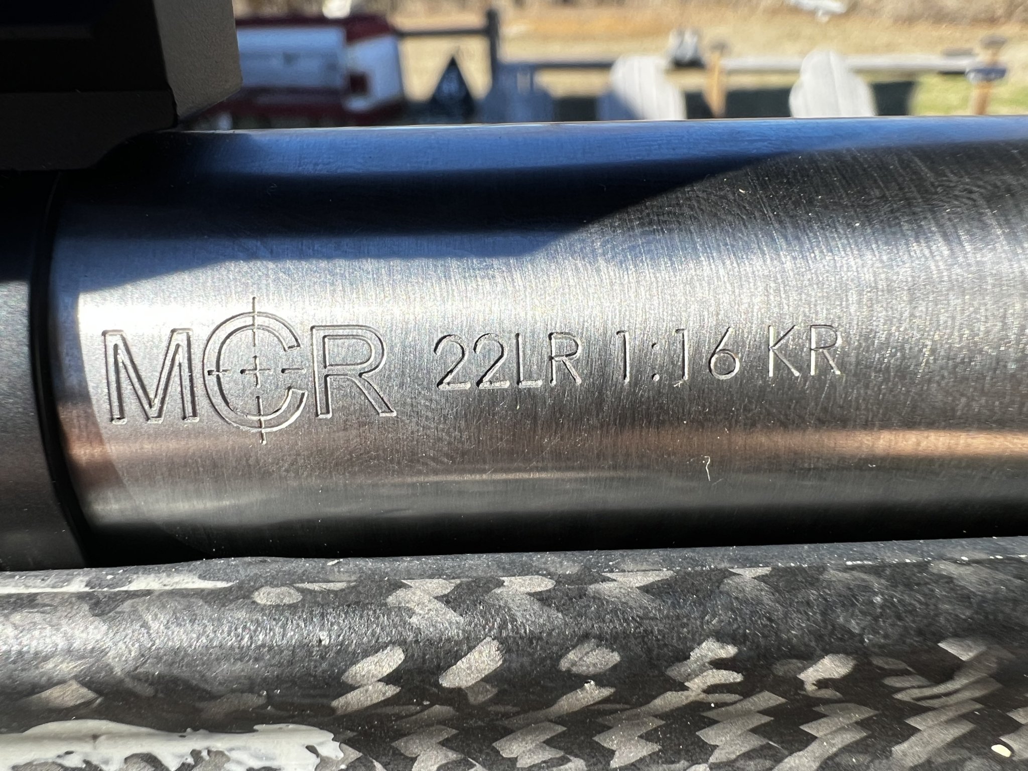

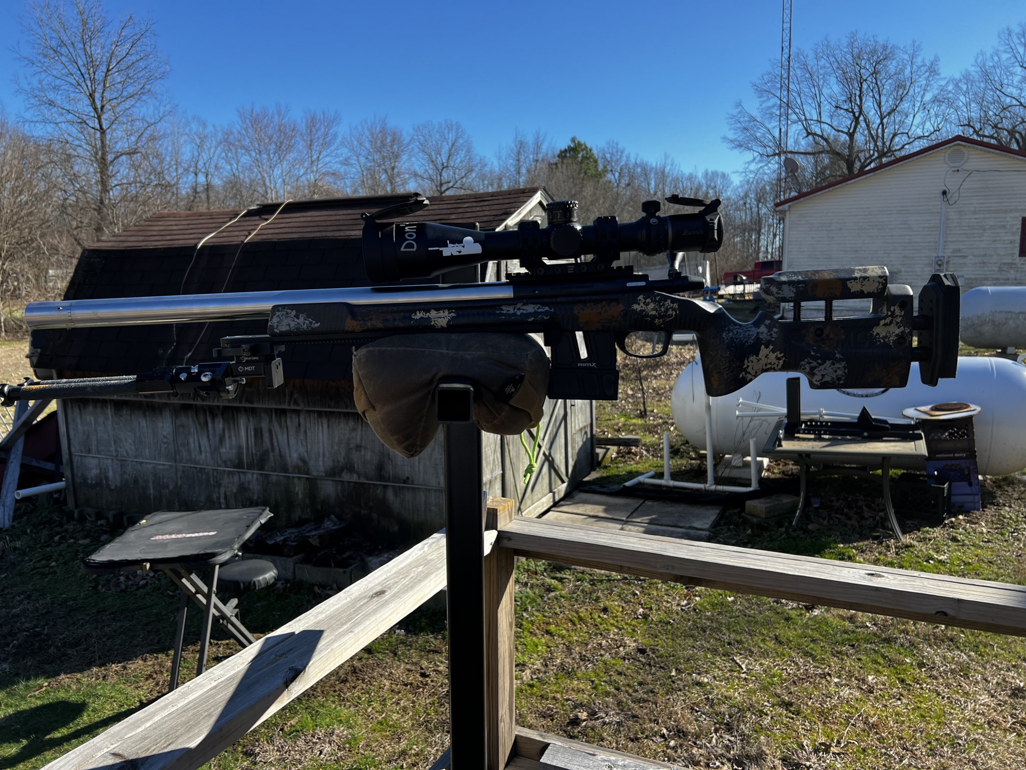

View attachment 8137606View attachment 8137607
99% of the top rimfire benchrest shooters are using Shilen and Mullerworks barrels.
Both of them are good actions, and you can build about anything off of them.
Get one and build the gun that you want. You really can't go wrong with either of them.

Barrel info for your RimX? Make? Length? Threaded? Tuner? Etc.
Thanks
