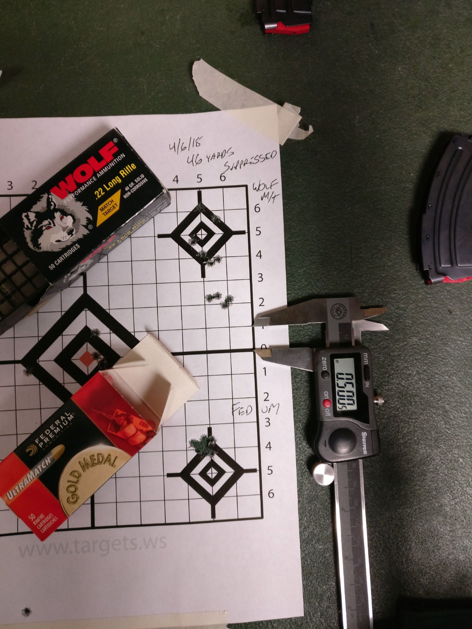

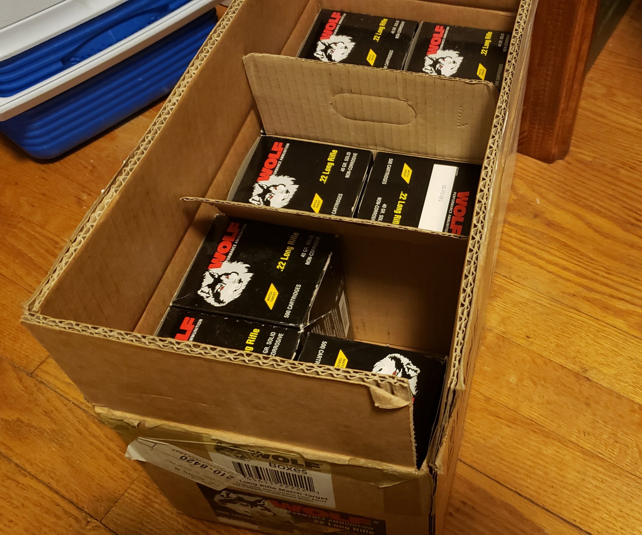

    I have an old (2007-ish) brick of Wolf MT that now shoots ~3 MOA. Always stored indoors, cool and dry.
