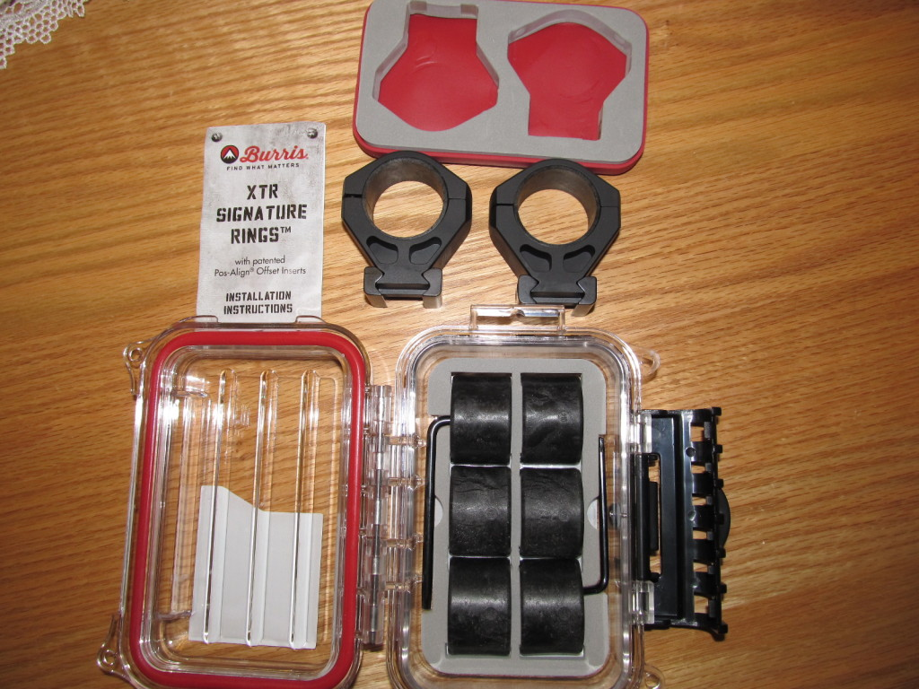

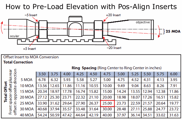

One of the great aspects of the Burris Signature rings is the ability to utilize all your scopes travel.
Not much of an issue in the average centerfire, but very useful in a quality rimfire rifle.
I zero my rimfire, and dial down to see how much travel I have left. Then adjust the shims to take up all but about 2 to 4 mils of it. I have 31 mils of elevation on my XTRIII 18x, 24mils on my 30x XTR Pro on my PRS Rimfire rifle, and 25 mils on my 300 Norma with an illuminated XTRIII 30x.
BirdDog,
I like the idea of this, so I just ordered a set of the Signature XTR Rings for my scope. But, I'm not exactly sure how to do what you said you did. Any chance you can provide a bit more detail about the process?
Thanks.
Reactions: Birddog6424

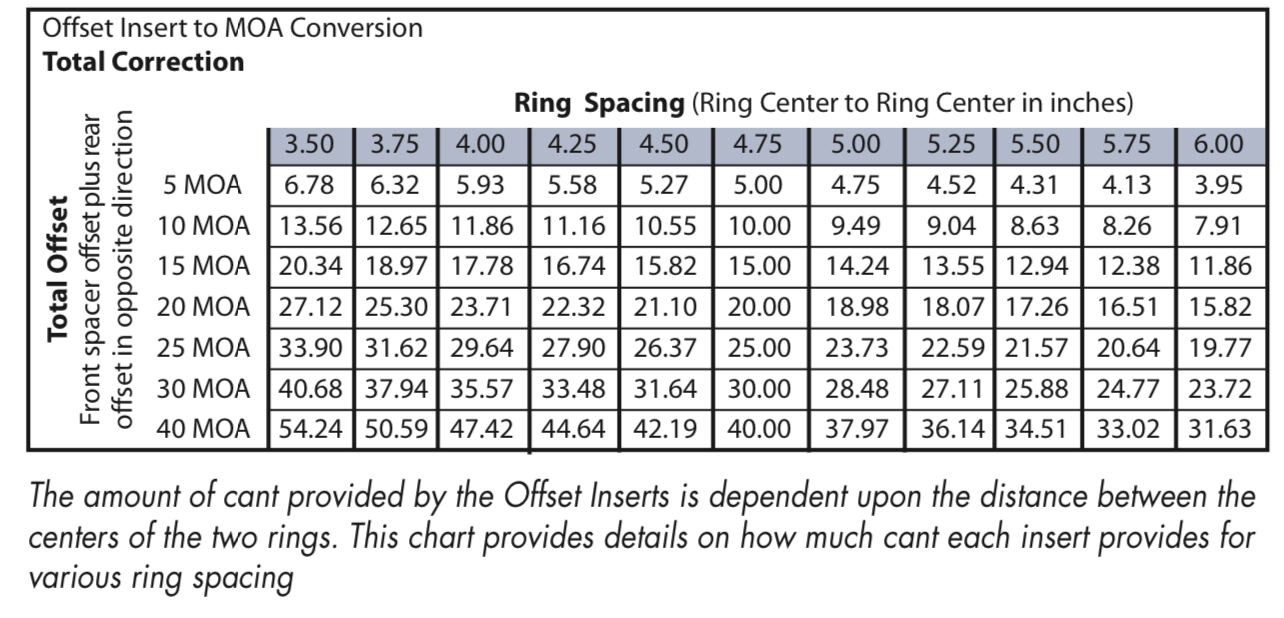

This may be helpful. You can get pretty close to the amount you need to adjust the shims and/or base with some simple math. https://www.bushnell.com/bu-blog-precision-shooting/scopemountingfordistancetakinga22lr450yards.html I'm working on getting that range extended out. I'm hoping to get that rifle out to 500 at least, maybe 600 some day but I'll have to get those same rings on it to have any chance of that (and basically zero wind).

To do? Set it up and shoot it.
Once you have shot it then see how much elevation adjustment there is in your elevation turret under your 0.
If you have 10 or 20 or however much moa below you can swap the inserts in and out to provide the additional cant into the scope mounting solution to convert what would have been downward travel into the upward travel side of things.
So to recap: Set it up, shoot it to zero, reset it up with the most appropriate inserts to achieve max up travel and then shoot it again to verify.

Keep in mind the amount of MOA that the shims actually adjust your scope depends on the spacing of the rings. I’ve used several sets of these rings. Now, on my match rifle, I run an Athlon Ares with a proper zero stop and a 50MOA rail. With a cheaper scope and crappy zero stop that would use up a lot of elevation, the XTR rings allowed me to zero less than 1 turn from the bottom of the elevation travel. The rings are not cheap though. I also found they seemed to move a bit in a centerfire boomer.

I'm shopping for a 3-18'ish scope for my Begara BXR semi-auto and am trying to decide between the XTR III and the Athlon Ares ETR UHD. They seem pretty close by spec comparison. I know the Ares ETR is made in China, but not sure about the Burris.

I got the 1" high rings in yesterday, and there is plenty of clearance with my 56mm scope.
I have a 20 moa rail on my B-14R, and I took a guess and put the 0 moa inserts in the rear ring, and in the front ring, I put the -10 in the bottom and the +10 on top. So I "think" that gives me an extra 10 moa of cant.
I sighted it in today at 25 yards, and after getting it zeroed, I am exactly 3.0 mils from the bottom, which gives me 29 mils of elevation.
I realize I need to bump my zero out to 50 yards, and I'll do that, which I think adds another 0.5 mils to the bottom.
My question is whether or not I should be trying to get closer to the bottom, or is 3.5 mils about where I want to be?

They are made to be matching pairs. Though I guess if what you have is holding then maybe it’s fine.
I see no reason to chase three mils
I thought that was exactly what I did???
I have the +10 with the -10 in front and the 0 with 0 in the rear.
I seems the Ballistic AE app is way off, and led me to believe that the 29 mil of adjustment would only reach out to 120 yards. I wanted to get to 200. But I just checked the GeoBallistics app and 29 mils gets me out to 400+ yards which is more than I’ll ever need.
Crap, I guess I read it all wrong before. Sorry for the confusion
So, I’ve reread the manual on these rings as it’s been a while since I used them (I prefer the Arc M10/Mbrace rings).
The way you did it is ok. But what you may have not taken into consideration is that the distance between the rings has an effect on the angle and thus the MOA number too. @spife7980 gave you this chart some ways above but here is it for your convenience. Pardon if you’ve figured all of this out already.
I found and attached the signature rings manual too, in case you don’t have it. I feel your pain, I used to get confused each time I set up the rings/scope.
