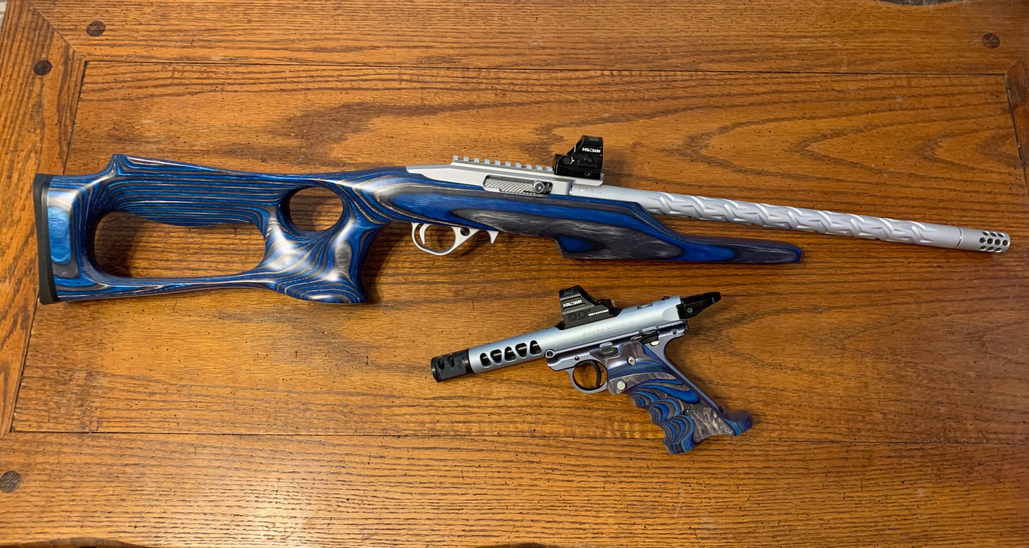

Here is the KIDD rifle I am running, not cheap but checks all your objectives. Build list is: KIDD Supergrade Barreled Action woth single stage trigger / KIDD Tactical Chassis / C-More RTS2R w/Mount / Phase 5 Universal Mini Stock / Phase 5 A2 Extention Tube / Phase 5 Buffer Tube Foam Pad / Bravo Company Gunfighter Pistol Grip / Bravo Company Gunfighter KAG Hand Stop.
It is light, fast, and fun to shoot. Good luck figuring out your build.

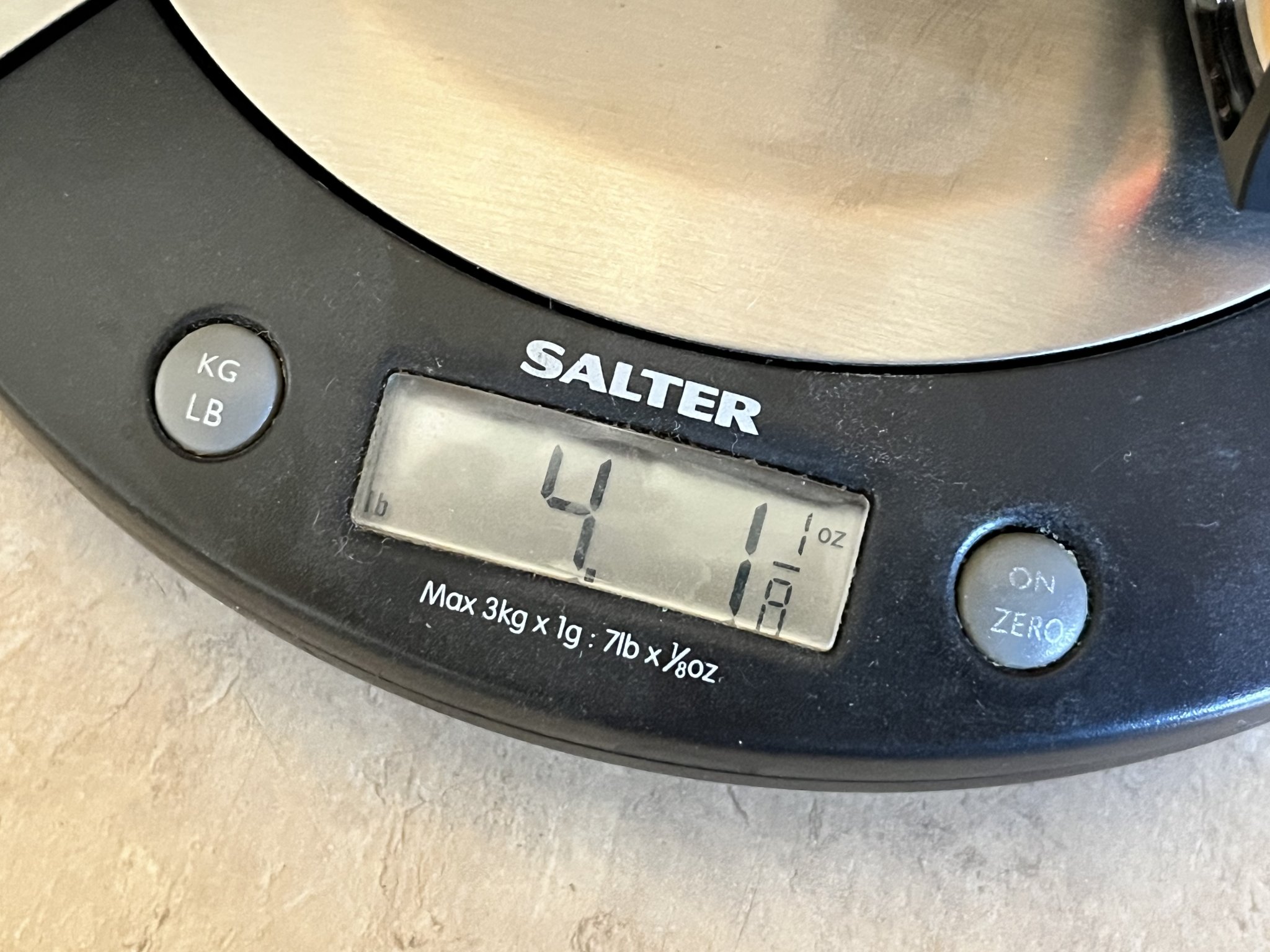

Just curious how much does this rifle weigh?

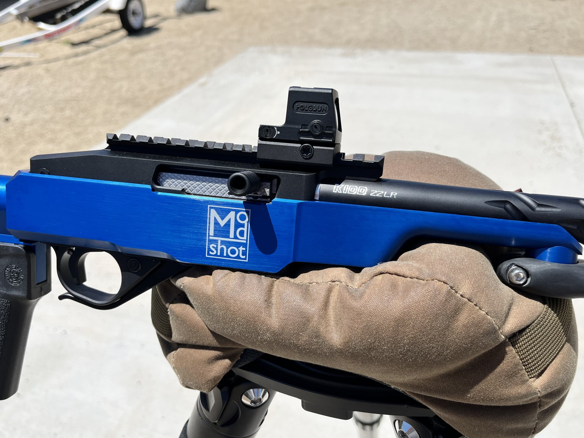

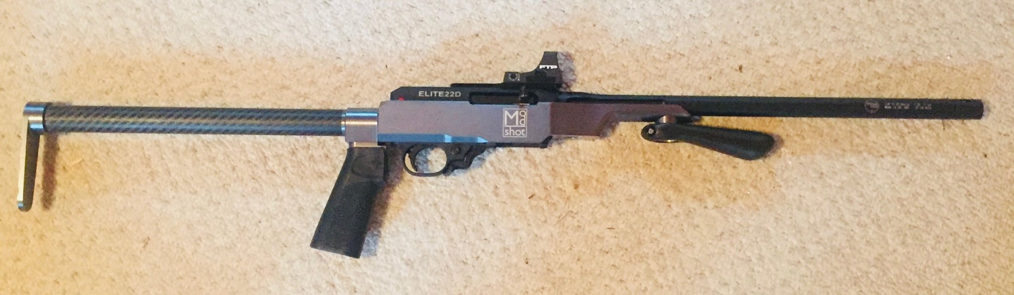

I went the buy quality parts and put it together route. TI receiver, Kidd bolt, Wiland barrel, FTP 8MOA red dot, Modshot chassis. Comes out to 3lb2oz.
This is exactly the info I'm looking for, beautiful rifle!! Are you just running factory rugger mags? Any feed/extract issues?
I look at the Modshot chassis a LONG time before I went the KIDD route, but was undecided on the forward handle. How do you like it?

Barreled action and trigger group weighs 2# 13.8oz, with stock no red dot it's 4# 13.9oz.
I am pretty happen with it. When I got it there were not a lot of options. I walked in with the goal of as light as possible...oh, and it had to look really cool. :cool:

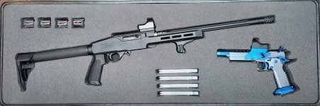

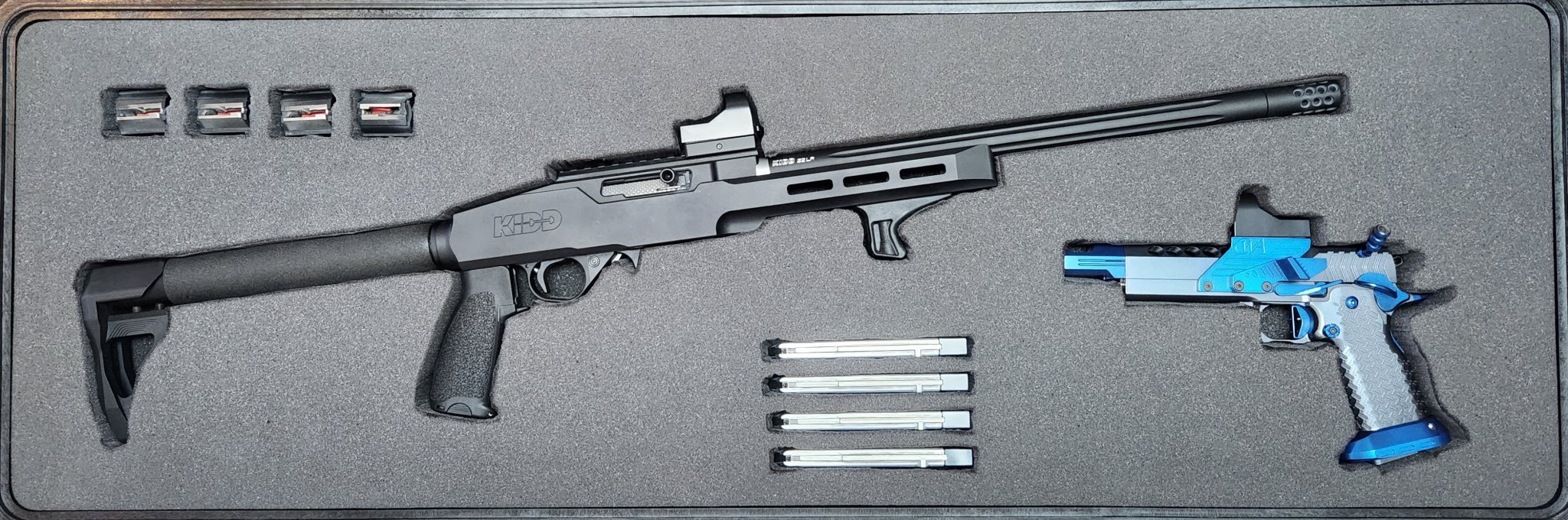

I just shot 500/2 boxes of these through my scorpion with no issues and actually shot pretty good didn’t run a accuracy test to windy here today…
Not sure, let me see if I can find a scale and update you later.
LR1845, sorry for the delay, just moving into a new house and had to find the scale, but wanted to answer your question. Rifle as you see it in the picture weights 5lbs 7oz.​

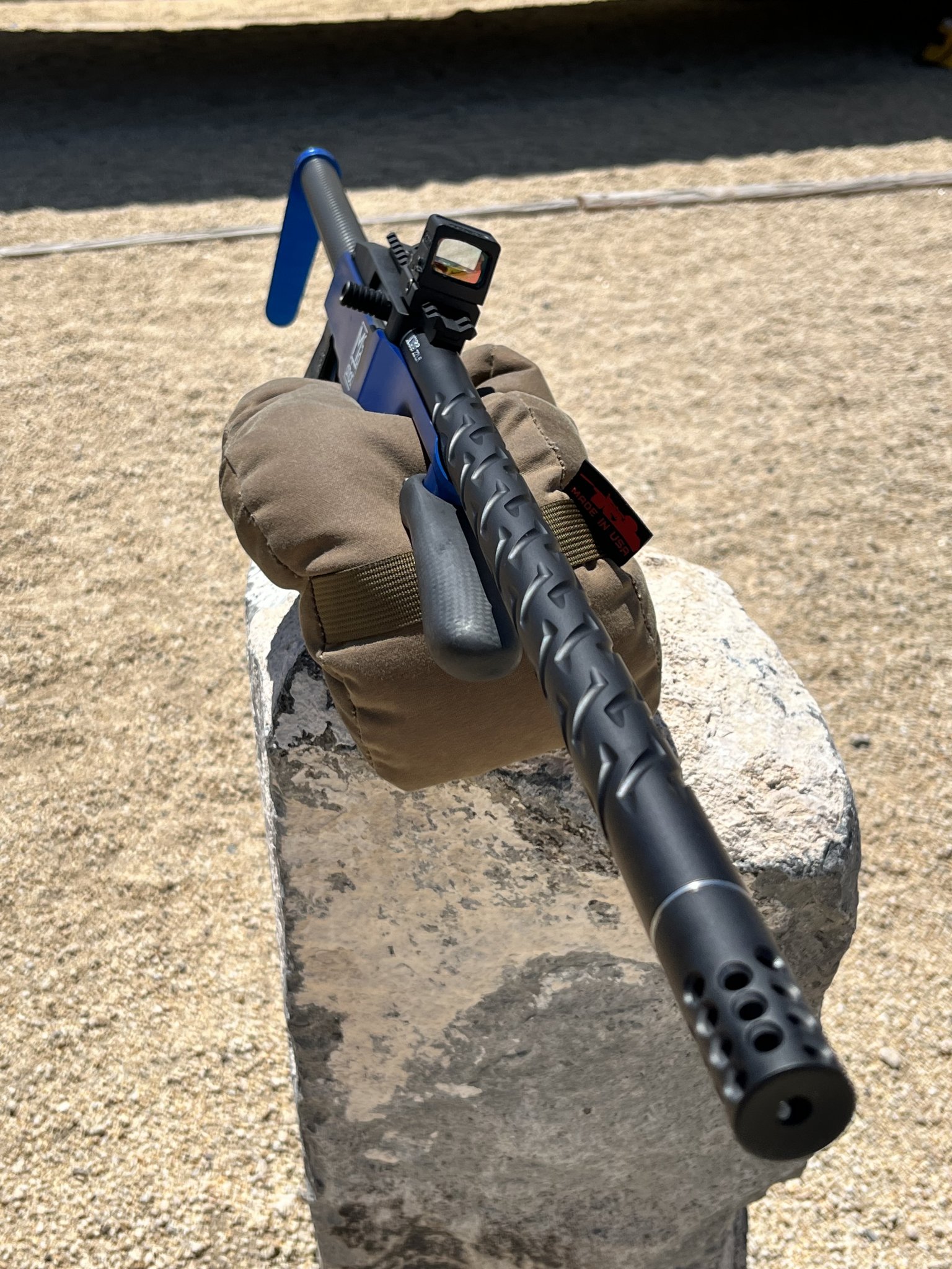

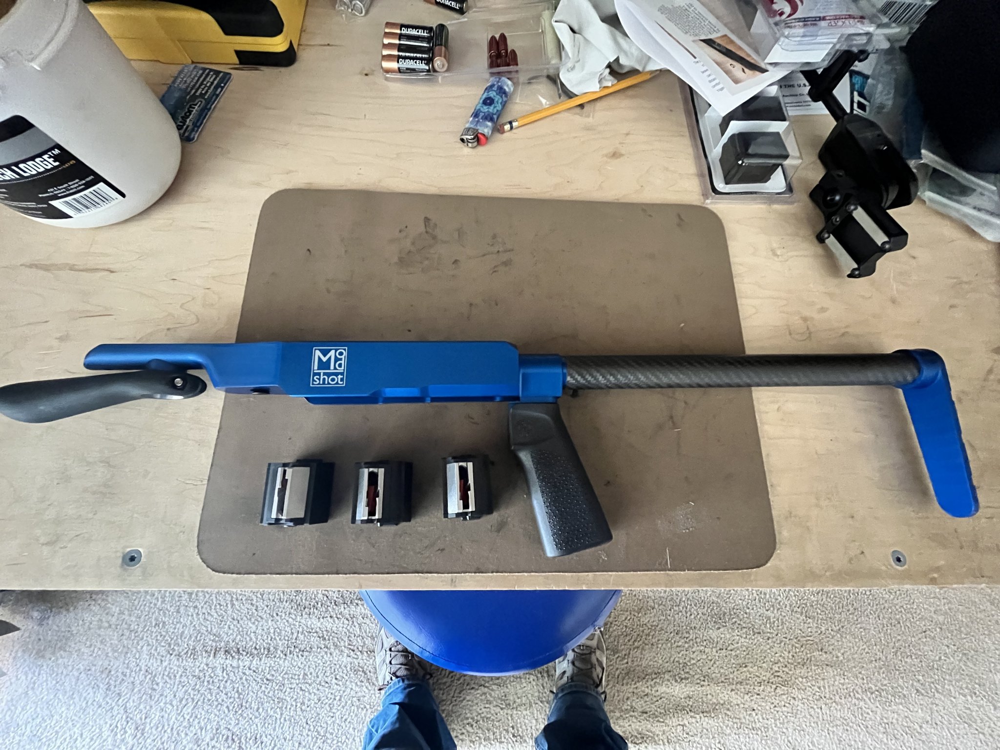

Parts starting to come in…barreled action should be at my FFL Tuesday…..I like the chassis it’s lite and feels pretty good we’ll see when I get it all put together.
Reactions: Quick1

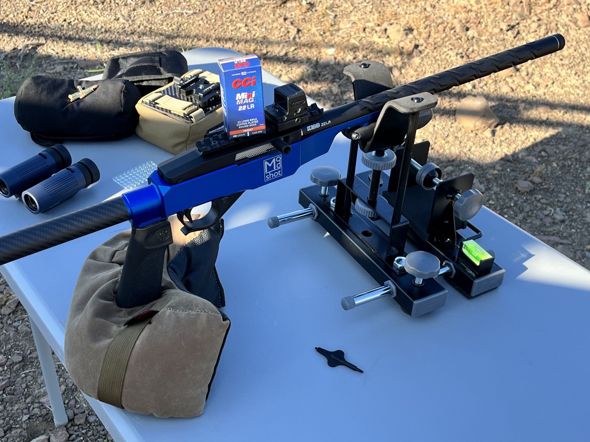

Picked up the barreled action this morning threw it together and went out and shot 60 rounds to sight in and make sure it runs.
Very happy...runs like a KIDD should and shoots great!! Can't wait to shoot this at a match!!
Reactions: 30calDeath

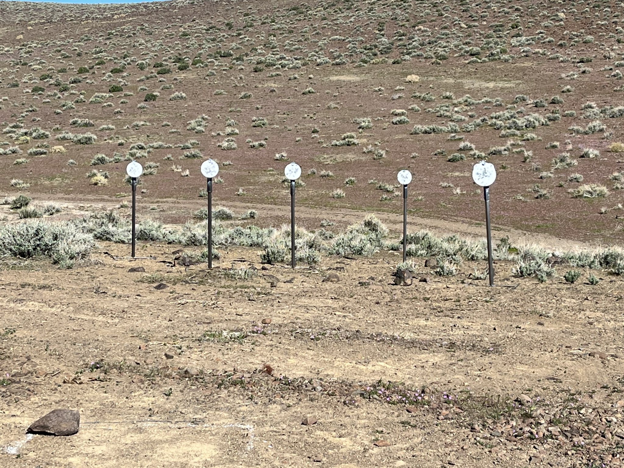

So I went out Sunday and got the Holosun dialed in and shot a couple hundred rounds...gun is fast and runs great can't wait to shoot the steel challenge this coming sunday!!
