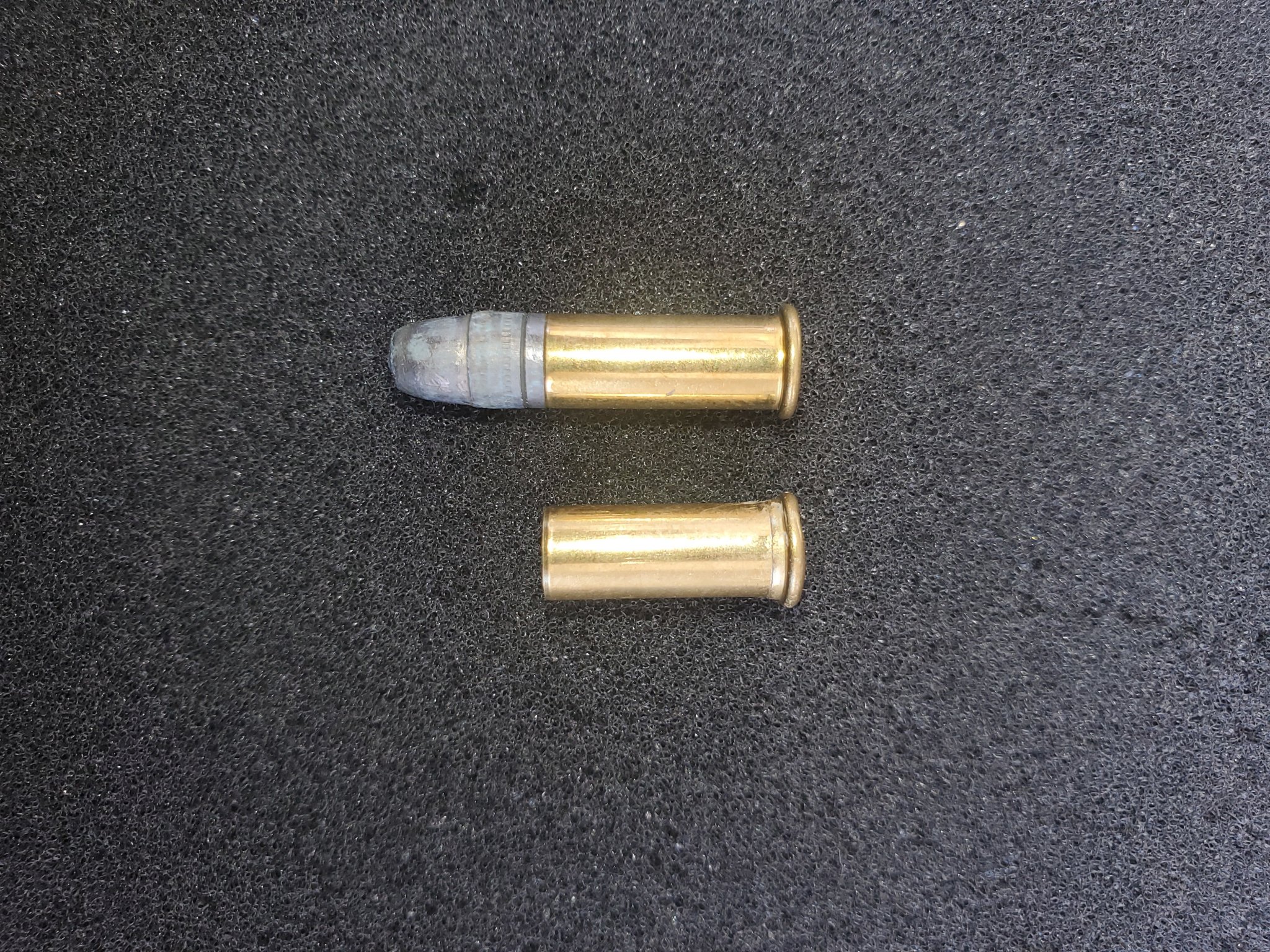

    Send pictures of fired brass, too. Specifically, the profile view of the cartridge like the attached.
    The chamber radius appears to be showing a little in these pictures which would indicate that it's slightly over sized. It may not affect 100% of the rounds, but any inconsistency in the firing pin drop or the primer compound in the brass could create a failure to fire easier than if the chamber radius were not showing in the fired brass.
    Shoot me an email and we'll talk about the options to get this remedied. [email protected]
    Thanks - Ray
    Thanks - Ray
