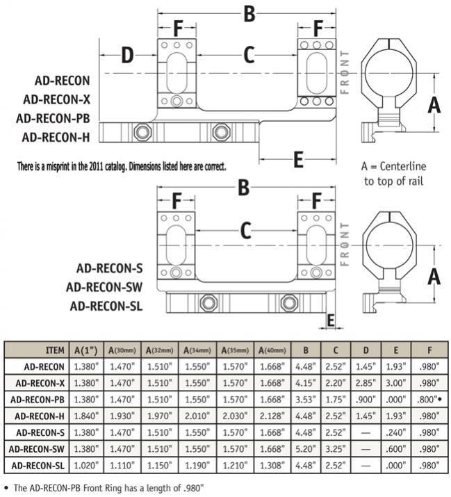

I am picking up an XRS and would also like to know the height in relation to the ADM QD mounts. I believe the SL works for the HDMR but not sure on the XRS.

The Recon SL is 1.19" from the top of the rail to the center line of the optic on the 34mm version. If we assume the external diameter of the XRS is 56mm (50mm objective plus 3mm per side bell width) then the XRS will have 1.1" from center line of the scope to the edge of the bell. As such the SL mount should fit on rifle with a long rail (such as a SCAR or AR10 with front rail) without issue (though adding butler creek flip caps would be tight). If mounted on a Remington 700 then it will gain additional clearance because the mount adds height and the barrel contour starts to drop away from the optic (on most 700 builds).
