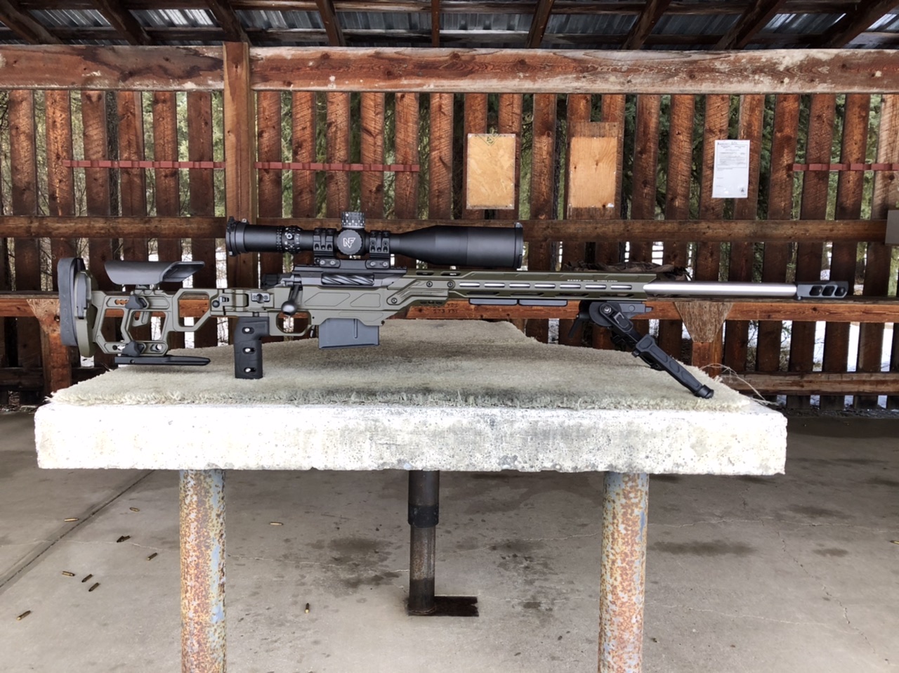

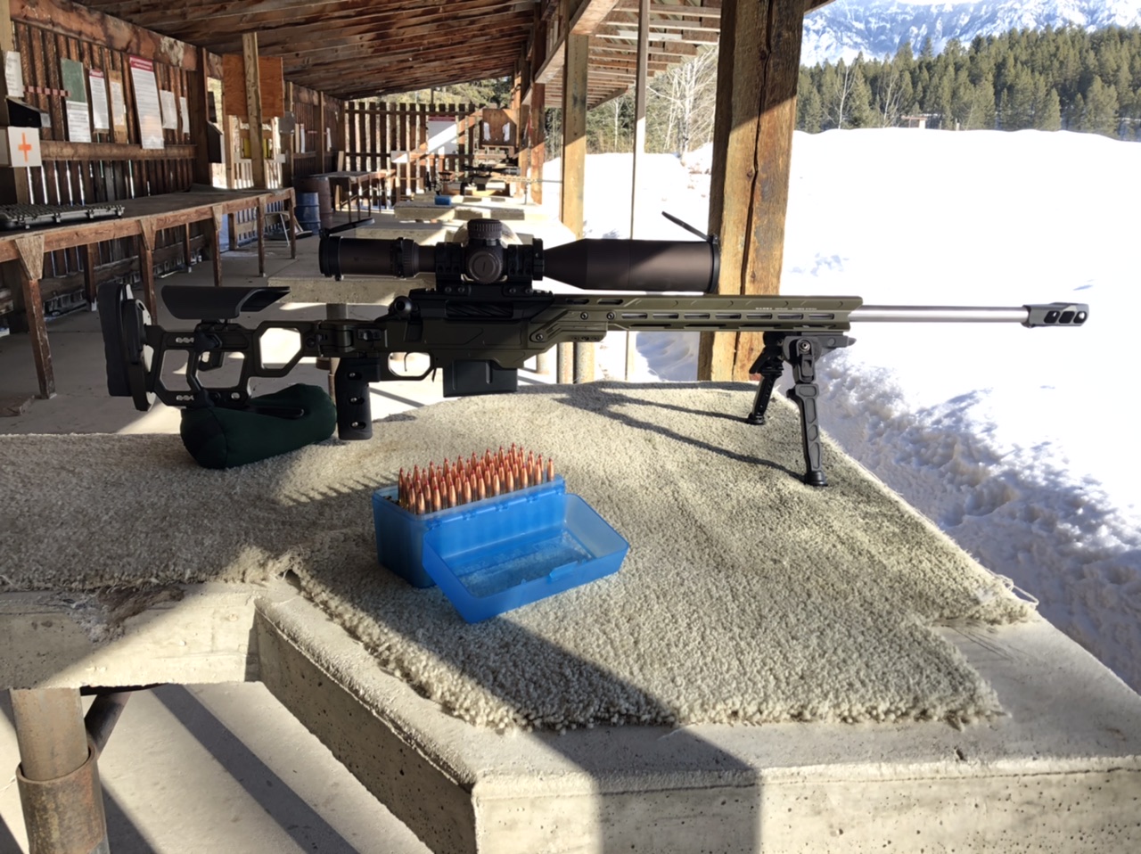

Will a 1.250” height rings work on a cadex field competition chassis with defiance action and 56mm scope with 34mm tube?
1.5” is the minimum I would recommend for a 56mm objective. Much lower and you won’t be able to get scope caps on. The top picture is a Spuhr 4902 38mm (1.5”) with 30 MOA cant and the buttom image is a Spuhr 4808 44mm (1.73”) high with 44.4 MOA cant.
