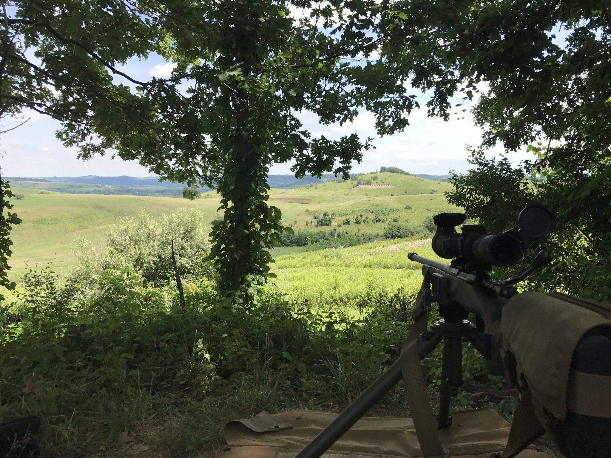

Since then I went to a 34mm tube scope and since 1.0” was lowest NF made in 34mm Ultralight rings that is what I had bought. With the 50mm objective and a light palma barrel contour I see a decent amount of room that could probably be one step lower.
Found a picture to give you an idea what the 1.0” NF looks like with a USO B17 that is a 50mm. As you can see its a lot of room.
As stated when I first got it I had a vortex AMG and tried using the seekins low which is 0.82” with and it ended up being too low. But think i eventually went with another size up either 0.87 or 0.92” ring to get good fitment. But somewhere in the 0.9x” will definitely work.
