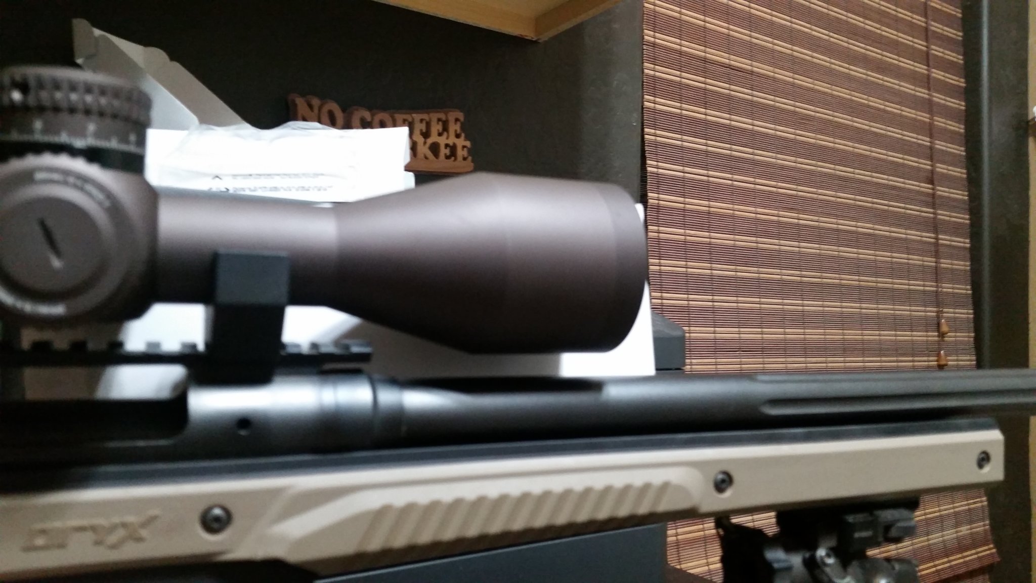

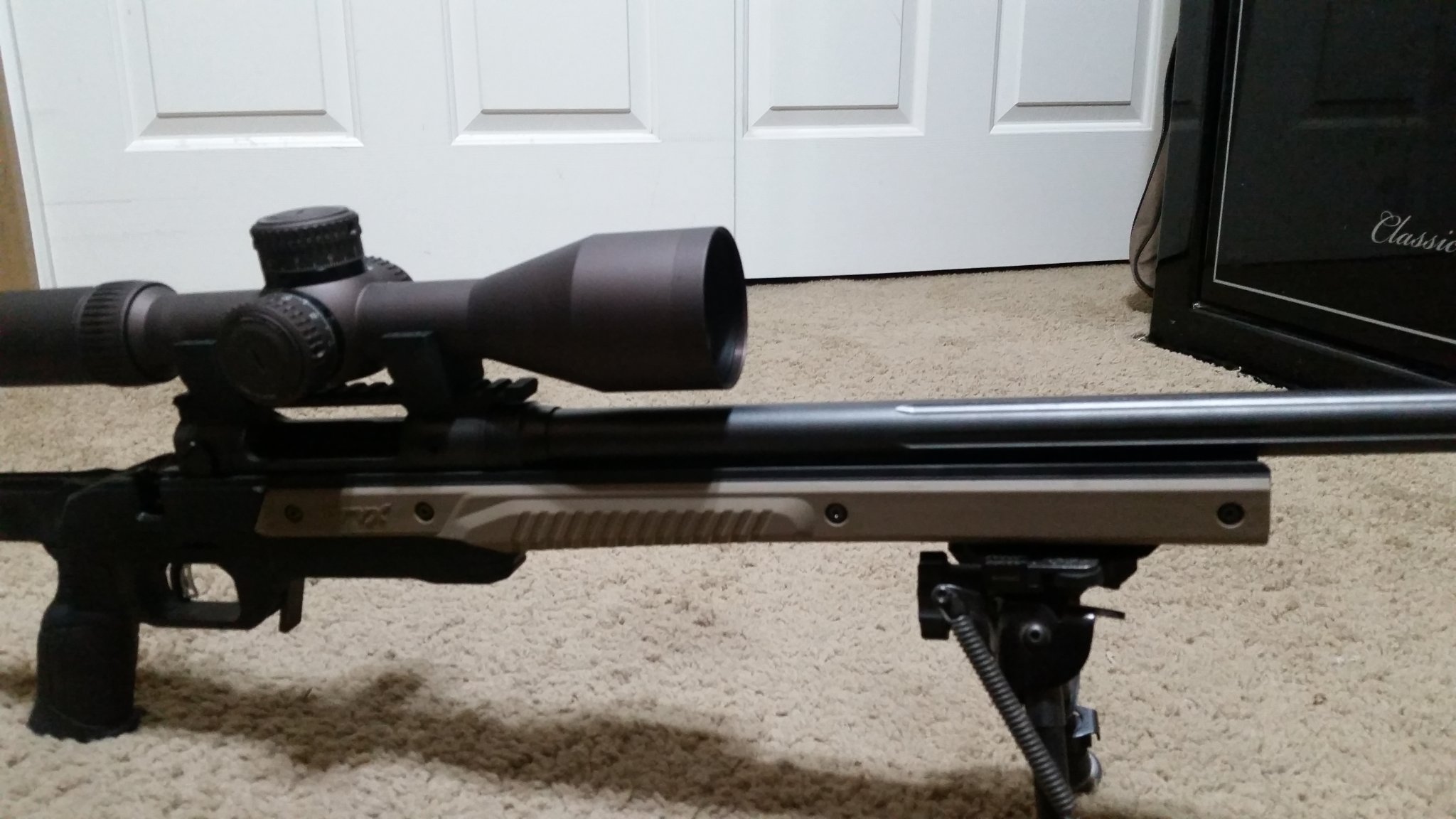

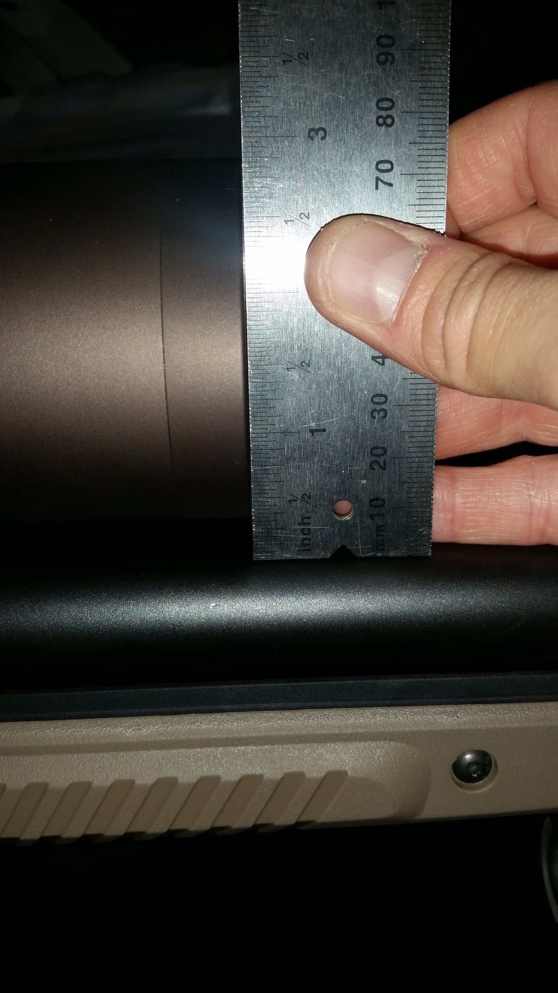

So I ordered the 1.1" rings and the gap between barrel and scope objective is just a squeak below 3/8" / maybe around 9mm. Anyone have an opinion on this?
If i drop to a 1" ring height I can get that gap down to about 1/4". Is it worth it? Is there any negative to having the scope a little higher? I've always tried to keep it tight as possible, but that was just the way I'd been taught to do it.

I think you need to check your cheek weld and let that tell you what to do next. Look through the scope with your head relaxed on the stock and find the sight picture. If it needs to go up bring/build up the cheek rest or get lower rings.

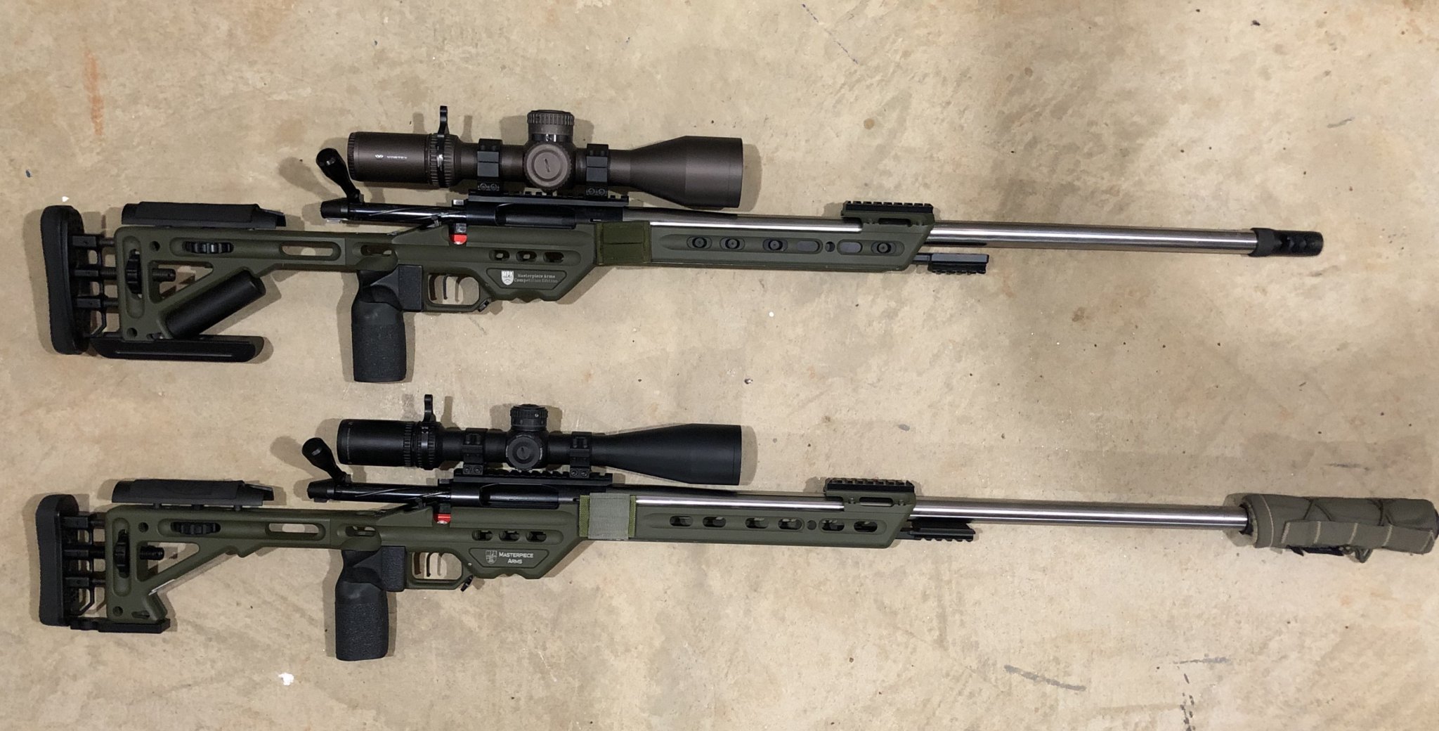

You have an adjustable cheek riser. That height is fine. Look at the guys that use chassis that have enclosed forends. There scope is much higher over the bore than yours. I think you will find that the higher scope height is more comfortable to get behind.
I do prefer a lower scope mount on a hunting rifle because my stocks have a lower comb height and I don’t have to build up the stock. I also don’t spend as much time behind the rifle as I do my target guns so comforthas no value. My scopes have 44mm and less objectives as well which also lowers the height.
