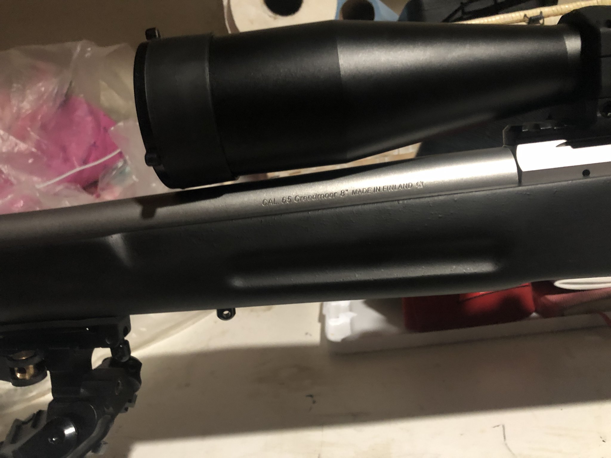

My first post. I usually am a lurker here but literally just mounted my SB 5-25x56 on my CTR with the Mountain Tactical 20 MOA rail and Seekins low (0.92”) rings. I hade the scopemounted to the factory rail with Seekins medium rings but wanted to reduce the distance between the barrel. I now have about 1/8” clearance between barrel and Butler Creek dust caps. Hope this helps!
