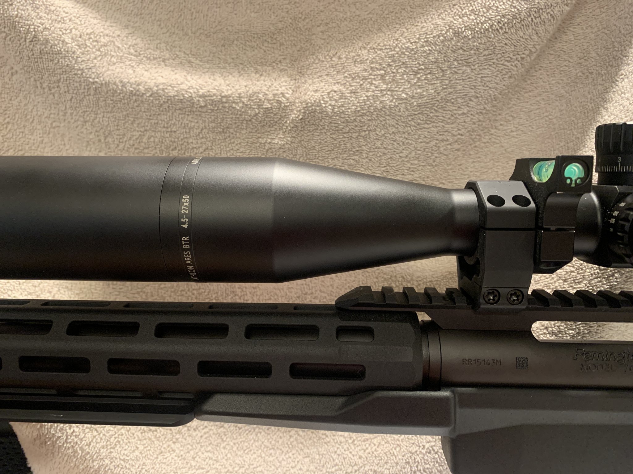

Either brand is fine. For that set up I'd go with either NF A108's (1.265" high) or Vortex 30-126's (1.26" high) to clear that extended mounting rail and handguard.

The Vortex (or Seekins) 1.26” will give you just under 1/2” clearance.
Correct, Athlon Ares BTR 4.5-27. Good eye! I am not a Remington guy, but I really like the PCR. I replaced the craptastic trigger with a trigger tech but otherwise it is GTG.
I got Vortex 1.26 rings for the same scope on a Lone Peak Fuzion and M24 barrel, as per Vortex CS recommendation. It appears to be OK
