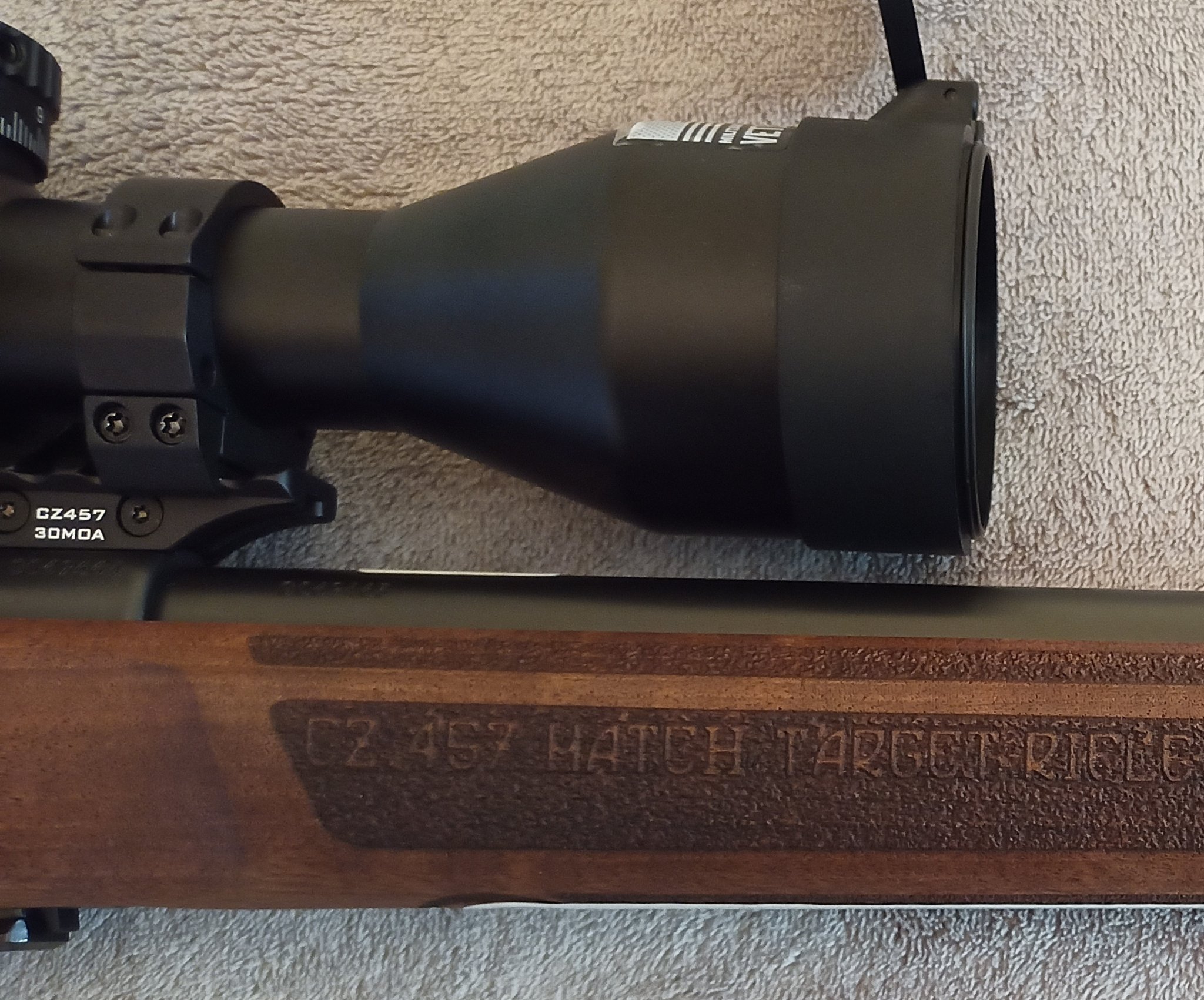

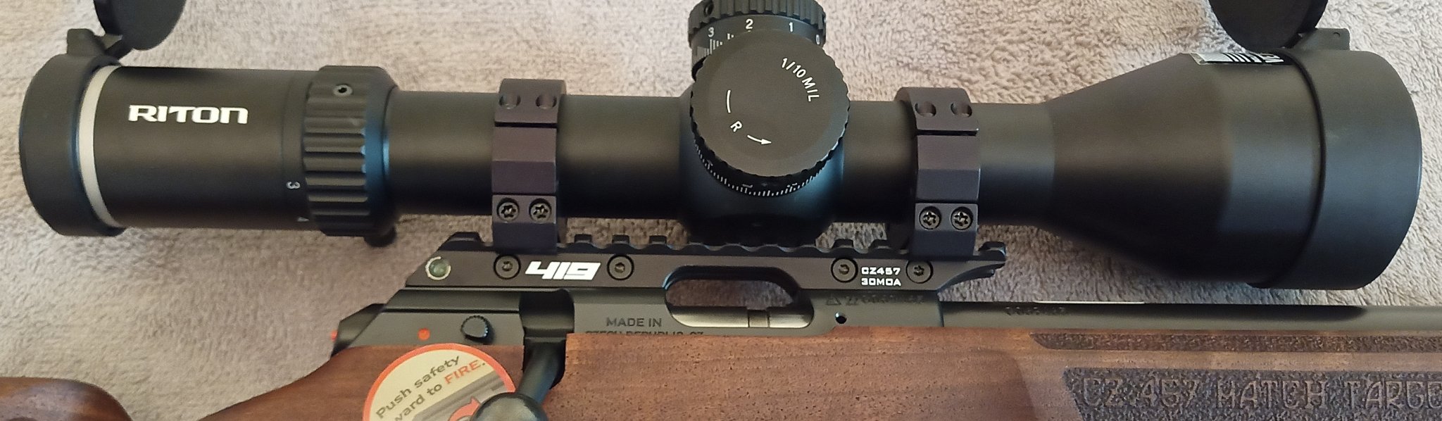

I have a CZ457 Varmint coming in and have also ordered an Area 419 30moa base. I currently have an Athlon Cronus 4.5-29x56 that I want to throw on there that also has a 3" sunshade and Aadmount caps on there. Looking to order a set of ARC rings before everything gets here but does anyone know if the 34mm low(0.94") rings would clear or would I have to go to the 1.1"s? Every setup I can find on Google with lows and 56mm obj does not have a sunshade on there.
CZ 457 varmint mtr.
Low rings, 30 moa Area 419.
Riton 7 Conquer 3-24×56
34mm tubes.
56mm obj.

It depends on how low you like it. You can’t get rings that won’t clear the barrel, because the 419 rail is pretty tall compared to the other rails.
I have the Cronus on a 419 rail on a CZ. I don’t remember what rings I have, but I know I bought the lowest I could find and there was still plenty of room for flip up scope caps.
