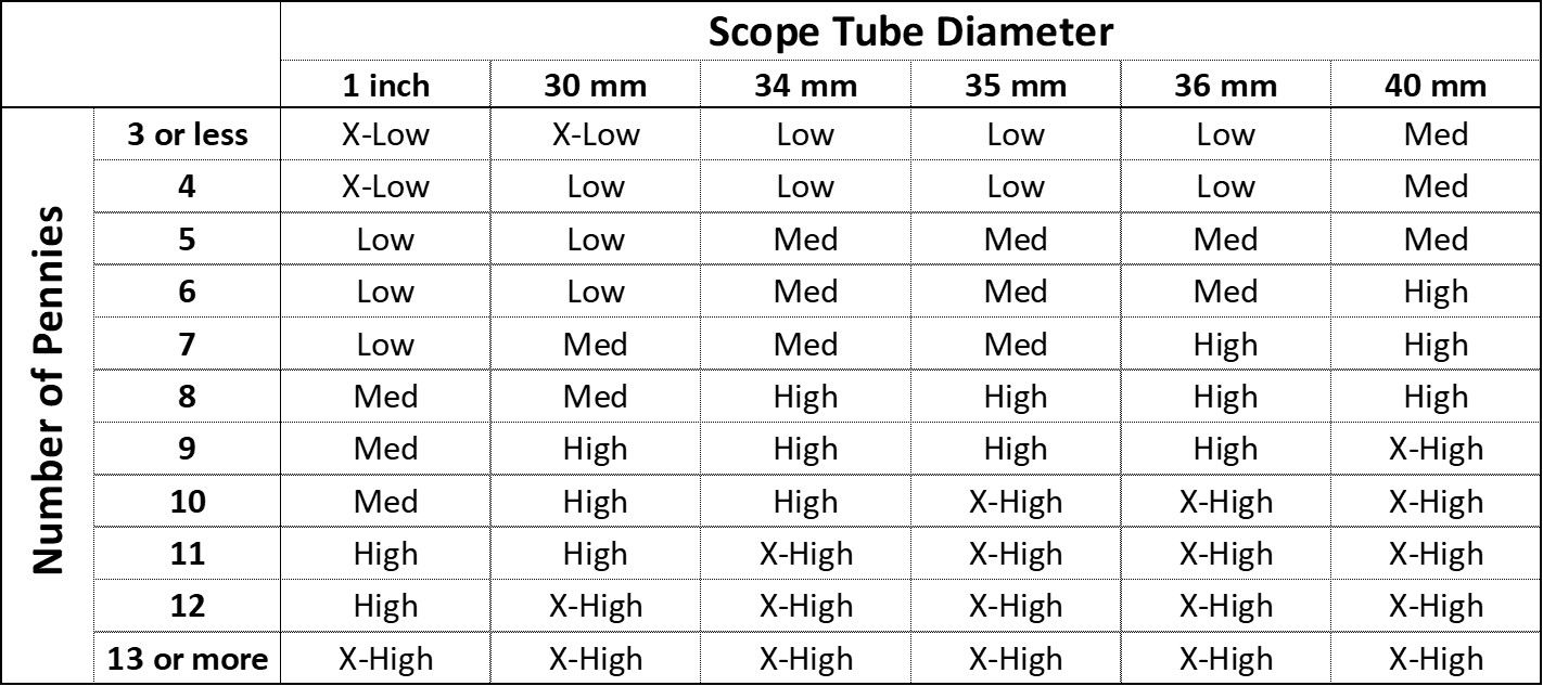

Problem with that is those are generic terms and different heights for low, medium etc from one ring/mount maker to another. Would have been better with actual heights.
its the ARC table so it applies to their stuff
im with most people here though. 1.1-1.26" will be fine. i prefer the ARC M Brace 32mm/1.26" myself
Reactions: Rob01
That’s good as there is a reference point even if you don’t use their rings/mount. They should put their name on the chart though.
