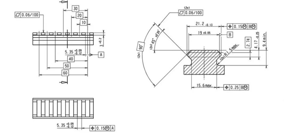

It’s 2025 I’m sure they could machine it better than 1/8 in slop in ring to base fit
Because if it wasn’t that spec then it wouldn’t be picatinny.
And it doesn’t matter how wide the slot is, you should slide the rings forward in the slot until contact so that there is no empty space in front for them to slide to under recoil.

Vortex pro rings are made to fit weaver or picatinney bases. The slot in a weaver base is not as wide as a picatinney base.
The lug to slot slop doesn't matter because the lug gets pushed forward until it contacts the rail.

I’m using Talley piccatiny base and Vortex pro rings why do they not fit tight I can move the rings in the base considerably
Completely normal. There is always a little play with any ring/mount. As mentioned a few time you push forward so the cross bolt in the ring is pushed up against the rail so under recoil there is no chance of movement and then tighten. It’s simple.
