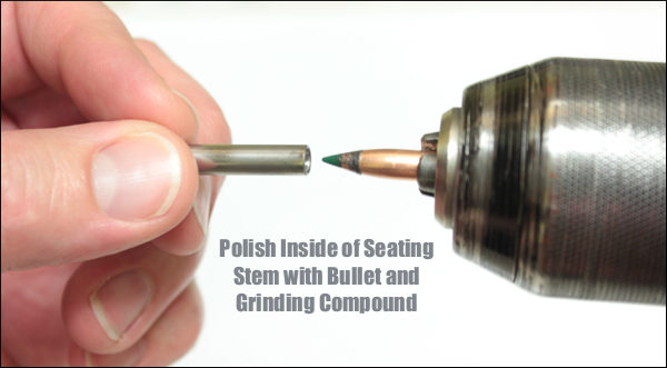

I am working up loads for my new 6.5CM Rem 700 ADL Varmint (26" HB, Bravo Stock, TT trigger, Vortex optics). One odd thing I've noticed is that when I seat the 123 gr. Hornady ELD-M bullets, after seating there is a light ring around the circumference of the bullet about 1/3 of the way down from the tip. I'm using the std. Forster benchrest seating die to seat the bullets. I use a similar Forster die seating my 75gr. BTHP bullets in .223 and have never seen a ring. Any thoughts as to what this might be from, and if it's an issue?
Take the top half with the stem off the seater and see where it hits the bullet. Supposedly you can send ti to forster and they will polish it for you. Or you can give it a try yourself

I figure once I seat enough bullets with it, it will lap itself.
