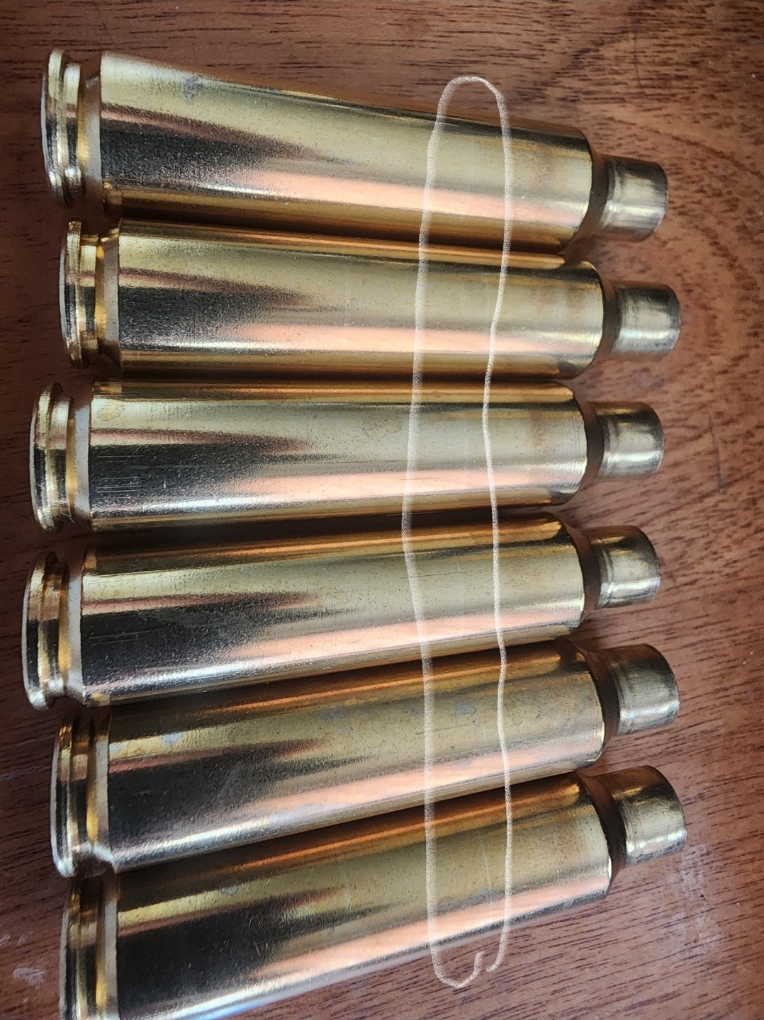

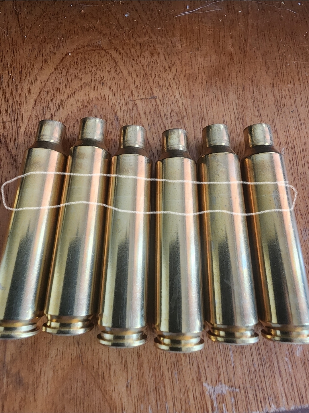

I recently got a bunch of used Peterson 284win brass. I am not sure how many times they have been fired.
Naturally, I inspected them and out of 90ish, I found 3 with a crack in the neck. Discarded those.
Out of the remaining, in about 8 cases I see this ring a little below the shoulder. From my understanding, this is too high to be an indicator of a case head separation. Is it safe to shoot? I felt the inside with a paper clip and I don't feel a ridge forming on the inside.
I am fairly new to reloading, so please feel free to tell me if there's something else that I should be looking for.
Thank you

I wouldn’t worry about it, personally.
Did you or the seller resize them before you took this pic? Do you know any history on them? Were they annealed? Full length or neck sized only? I can’t readily explain that line but I don’t think it’s indicative of any safety concern.

You're at a bit of a handicap, not knowing how many times they've been fired or whether they've been annealed or not (probably not if necks have been cracking). I wouldn't use them unless I annealed them properly first, else you're probably going to see a lot more cracked necks.
As for those rings you're concerned about, I don't think they're anything to be concerned about. Like it could be just a burnishing mark from the sizing die. Being previously fired an unknown amount of times, you'll want to keep a close eye on their condition as you use them.
Agree with above on annealing first. That could easily be an fclass gun if you bought used running several cycles of max load
As per the lines than can be anything and appears only cosmetic. Possible someone spun the round on a concentricity gauge even. I do that with my match rounds to check run out
But based on the split necks if you don’t anneal you probably won’t see much life from those casing.
If there’s that much life out of them the primer pockets may be loosening up as well anyways. In which case retire them
Reactions: UndFrm and Baron23
Does the mark on the case line up with where the case sits in an ammo box?
Around here, .308 Win cases get what we refer to as the "Rattlesnake Ring" when you put them in a green MTM 100rd box. The fine talc dust from the range ((www.tcsa.info) tends to coat *everything*, but in particular it tends to leave a shiny ring right where the case sits in the ammo box. If the cases are mouth down, the resulting line just *happens* to be right where a case separation line would appear - which has freaked a lot of shooters right the f$ck out, the first time they get home and open their ammo box after a weekend match ;)
