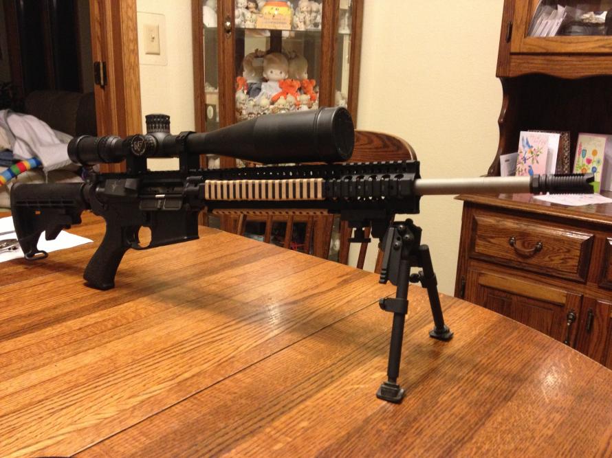

Just to give a follow up. I ended up going with TPS 1.400 x-high rings. On the NF 56mm bell they work great. There is a very slight gap between the quad rail and the scope bell. Needless to say, I am happy and thank you for the advice. I hope this helps someone else in my similar predicament. Hope you all like how it came out. I DO!
