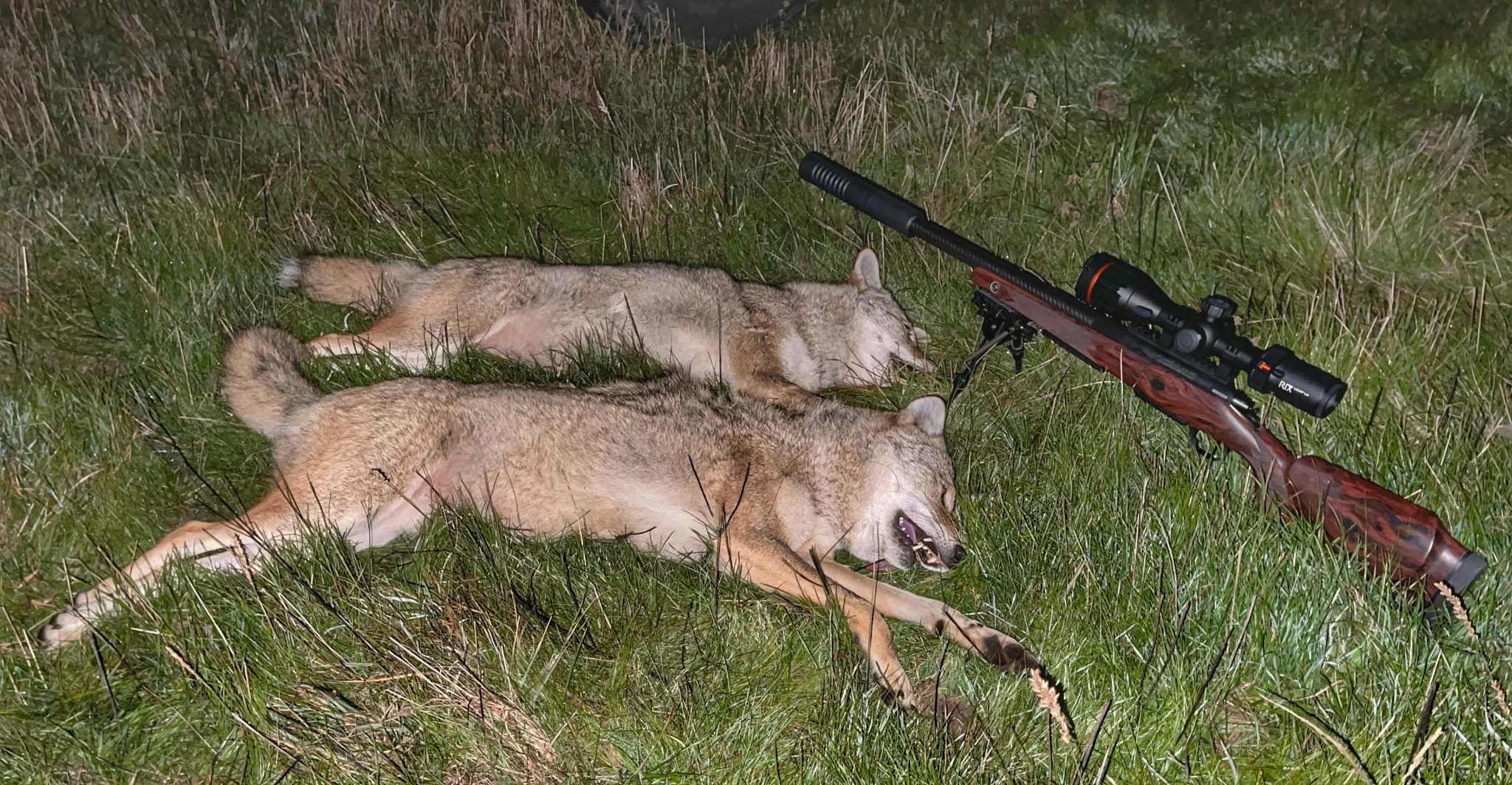

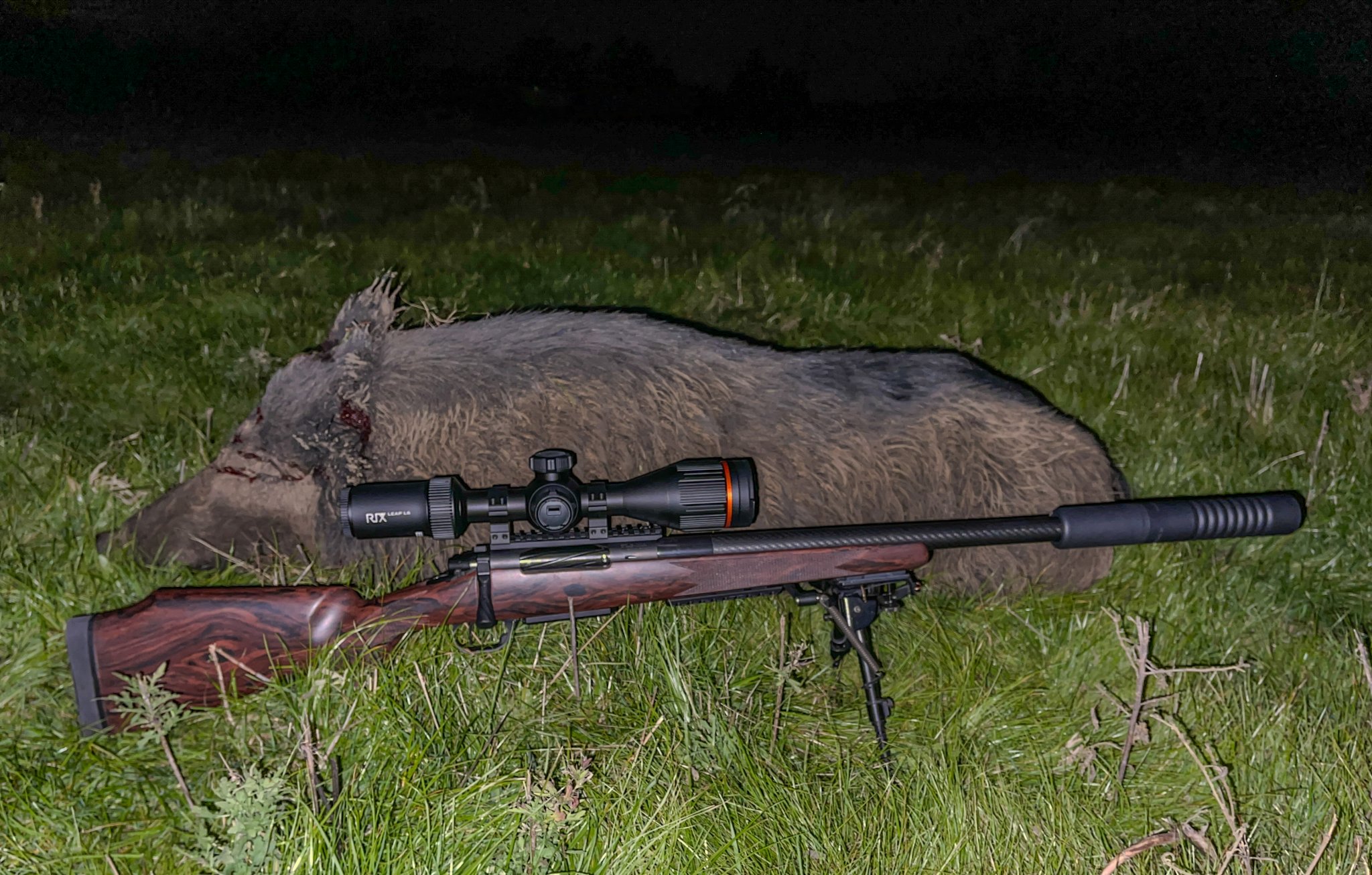

Just picked a L6 up to demo and it’s an impressive unit for the money. There is a definite difference compared to my TH50C V2.
I love the first focal magnification and the fact it uses a 18650 battery. It’s living on my 7SAUM right now and we’ll see how it holds up.
I love the first focal magnification and the fact it uses a 18650 battery. It’s living on my 7SAUM right now and we’ll see how it holds up.View attachment 8316218View attachment 8316219
