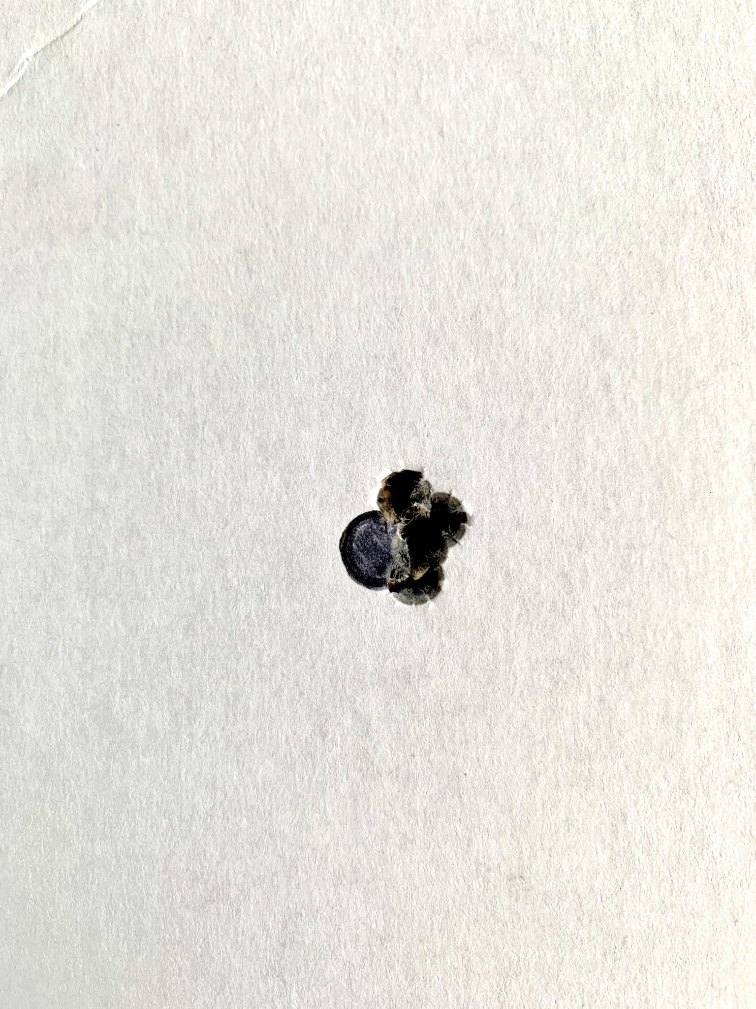

I know the quest for H4350 has hit a lot of places and that quest has resulted in empty shopping carts. I also know a lot of people choose it for their 6.5CM as I did. I also know I’m probably beating a dead horse with this, but I just wanted to share my real world experience from this morning.
I have H4350 that I was lucky enough to obtain the other day. However, trying to feed a 6.5 and 6mm Creedmoor, the 16 lbs I have won’t last long as I’m having to break in the new 6.5 barrel and I wanna stretch this powder as far as I can.
So I purchased some RL16 to run in the 6.5 because I’ve seen others have success with it. After this morning I believe it’s gonna work. I loaded up 20 rounds with 42.0 grains to see how it was gonna do. The bullet was a 140 ELD-M seated 0.020 off the lands with virgin Lapua small rifle brass.
After a few shots to get zeroed, this was shots 6 through 10 outta the barrel, which is a Hawk Hill, chambered by Bugholes.
Now the load may go to shit after I get more rounds down the barrel, but right now, it’s looking like a winning alternative.

I really liked rl16 in my 6xc but I have loads developed with h4350 for too many rifles now so I’ve just been stocking h4350 but for someone new with no time invested already I think rl16 would be the better choice between the two.
Was it 109 FPS faster or slower than H4350?
What he said.

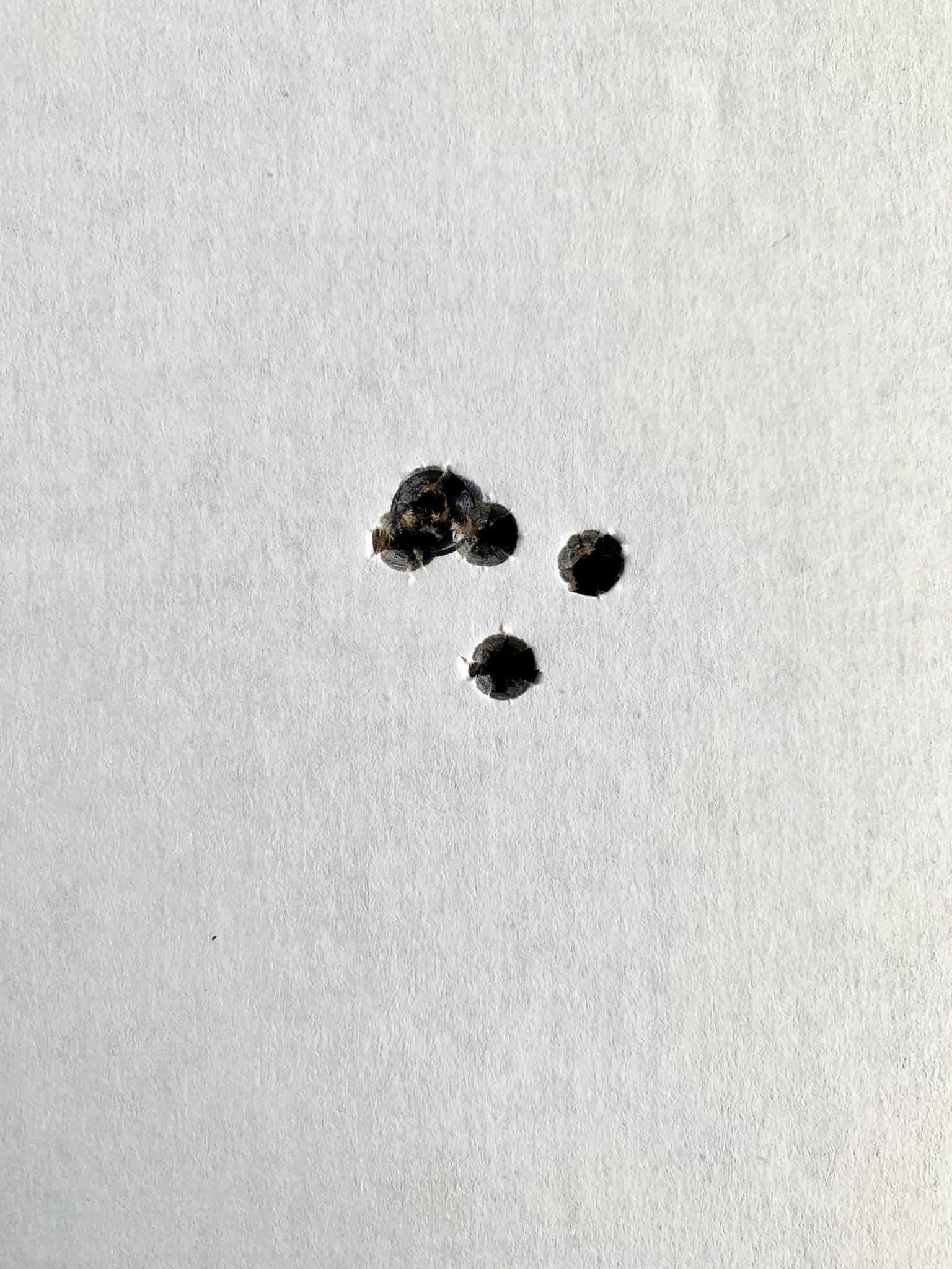

On a side note, here is 5 shots with some H4350 loads I had left over from my previous 6.5 Bartlein. These were loaded with 42.2 of H4350. I used these loads as zero loads. 3 through 5 are in the black. 1 and 2 was off to the right during adjustment. Shot the low one, came up then shot the 2nd one off to the right a little.
Once zeroed, these two loads shot almost identical. Will put a chrono on around 80-100 rounds and do a ladder test to find a node.
