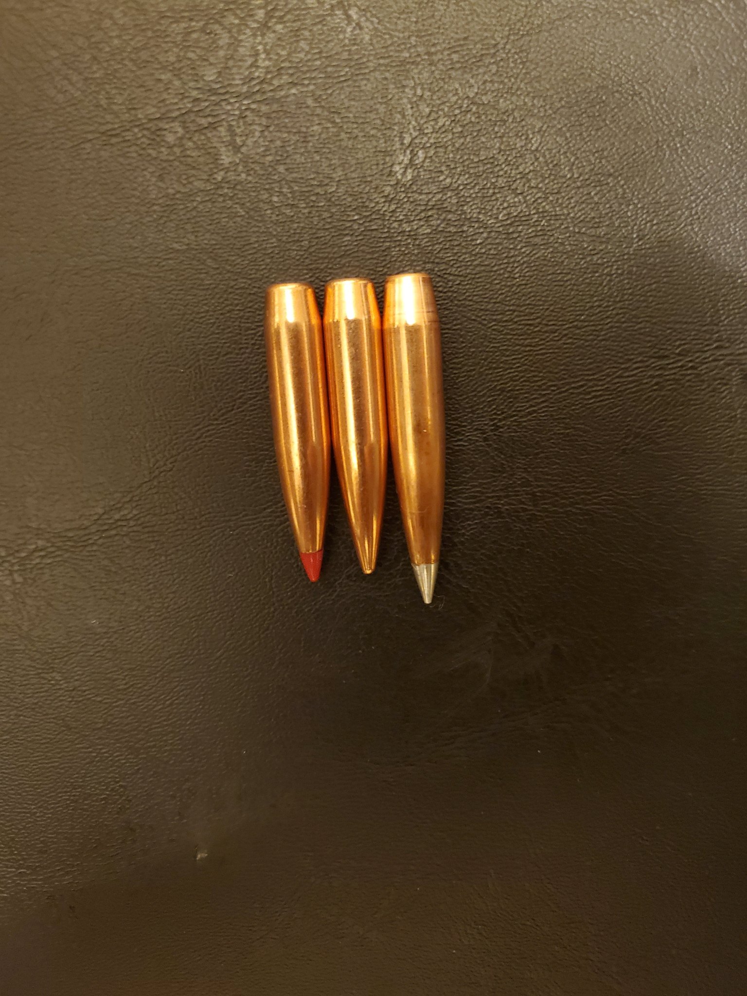

I’m just getting into hand loading and I’m going to be loading rounds for my 27” AXMC 1:10 300 win mag. I bought 16 pounds of RL 23 because H1000 is unobtainable. I’ve heard of rl 23 working really well in 300 win mag but not a lot of people online are talking about it. I have a bunch of 215 Bergers and 225 ELDs that I want to experiment with. Is anyone running heavy bullets using rl23 with success? Any suggestions? Thanks

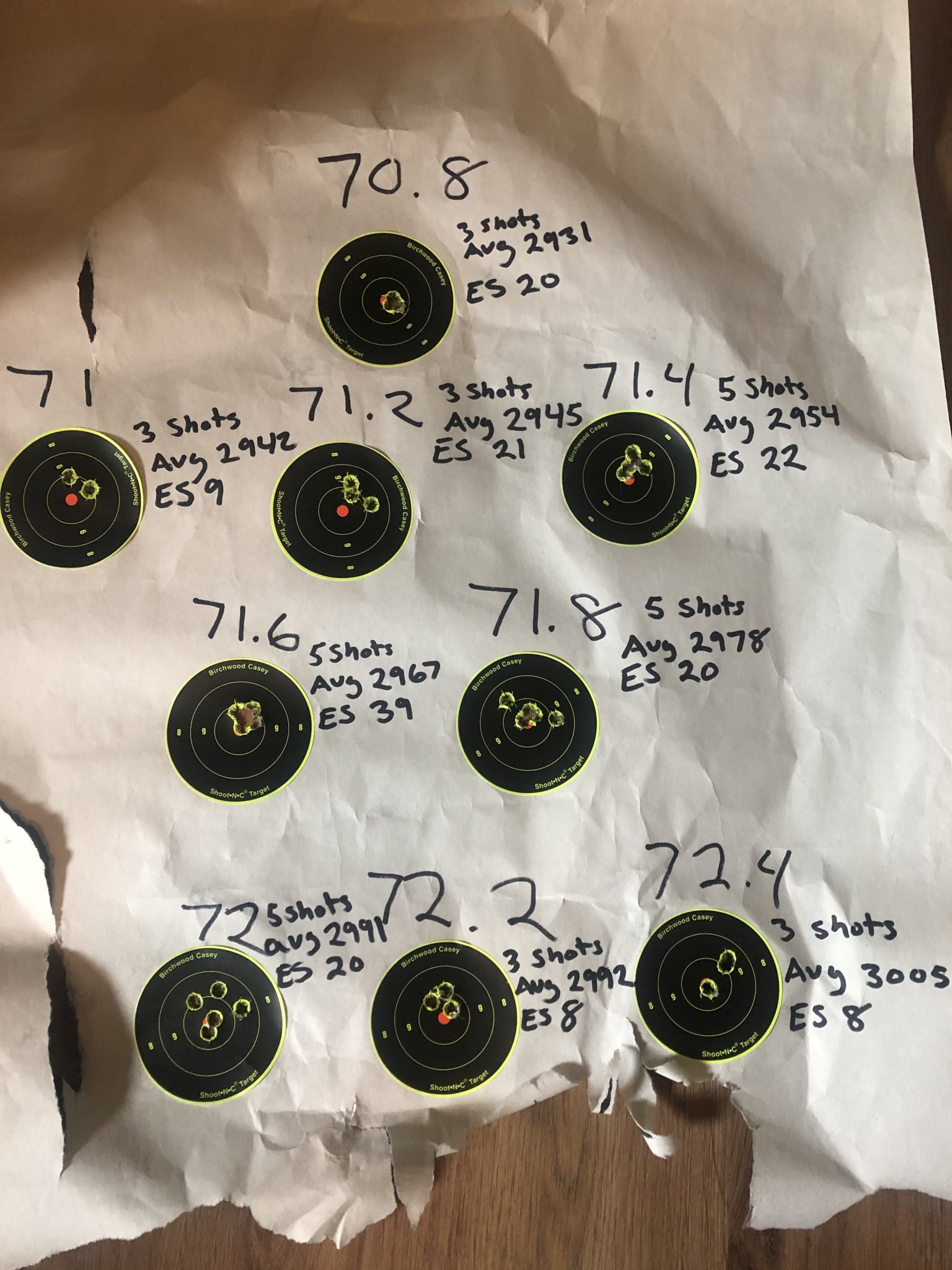

I went out and did a ladder test and went all the way up to 72.4 before I had a lot of pressure signs (heavy bolt lift, primer crater and extractor mark). 71.8 appears to be in the middle of a velocity node. 71.6 and 72 are within 5-10 fps of 71.8. 71.8 had an average velocity of 2950 and a SD of 7. I went back out and shot groups from 71.6-72 grains. 71.8 had the best groups shooting about .5” With 5 shots with a .025 jump. I tried the same load with a .015 jump and my group opened up a little to .7”.
Next I think I’ll make a bunch of 71.8s with different seating depths in .005” increments. Any suggestions?

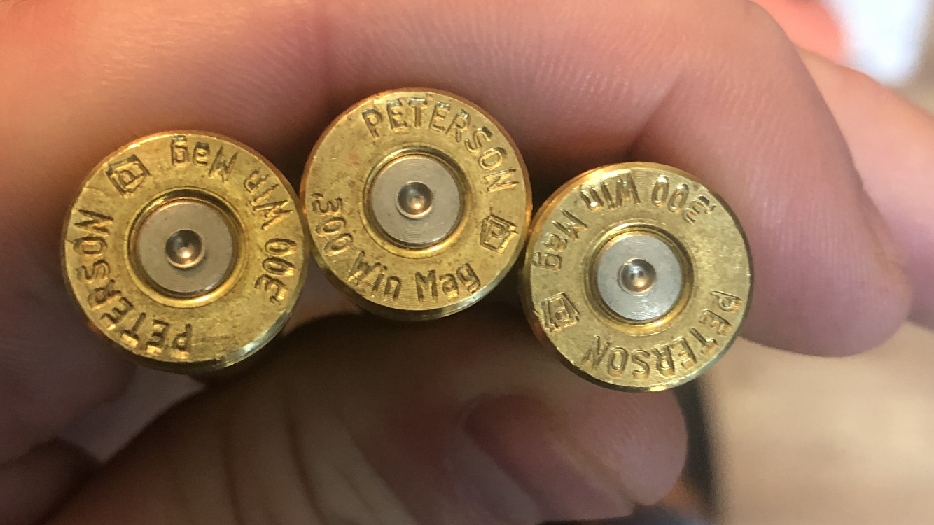

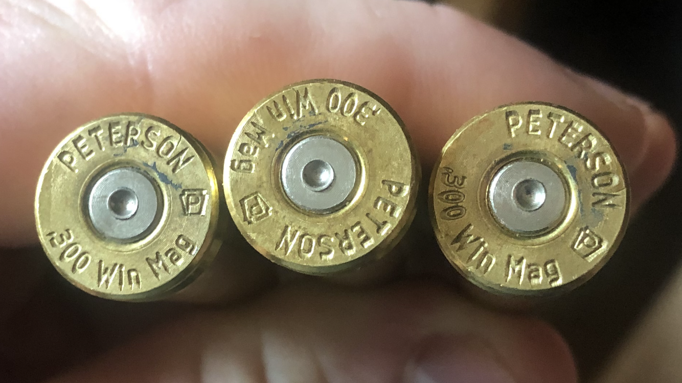

I switched to Peterson brass from federal and went out and tested 70.8-72.4 grains of RL23. Any suggestions on where to go from here?
