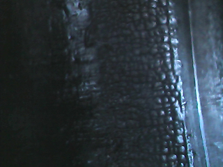

    Ive put a pound or two through my 7mag with no issues until i screwwed around and got a borescope. Holy shiz do I have a carbon ring from hell. Ive been running 180gr range in various mfg bullets, mainly ELDMs, was getting great case fill, no pressure, and 3050fps with single digit sd's. Not entirely sure on rl33 being the culprit on the carbon fouling, but now my work is cut out for me in removing the ring/fouling and experimenting with retumbo or rl26 maybe.
    Buy yourself some Boretech C4, carbon dissolver, works good. I thought you had posted this pic elsewhere here, you also may need some JB paste, please ask for assistance before you start using it. You very well have hard carbon laid in that area.
    Ya I started a thread in the exterior ballistics area, and then got to searching rl33 and issues with fouling and this thread hit. Definitely going to try avoiding abrasives at first, so thanks for the heads up on the c4, just ordered a small bottle.
    I’m sure this will be one of my many hard learned lessons and won’t forget it once I get this rifle straight. I’m grateful that I found it prior to depending on the dam thing and have it fail, it shoots great.... or “shot” great! I’m not taking it anywhere until this is fixed.
