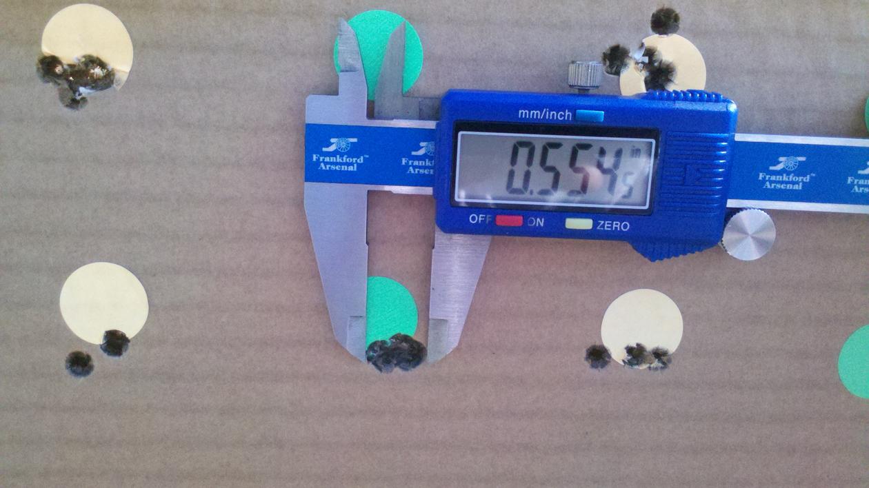

I posted this in another thread too, but here you go. Using all the same components you have.. I'd have to look in my book to find the charge weight, but they were compressed loads. Chrono'd right at 2800 out of my 8 twist krieger. The ES and SD was worse than using the H4350, but they still do alright..;)6 shots..100 yds2013-08-31_10-37-46_128.jpg Nice looking rifle, good luck with it.
