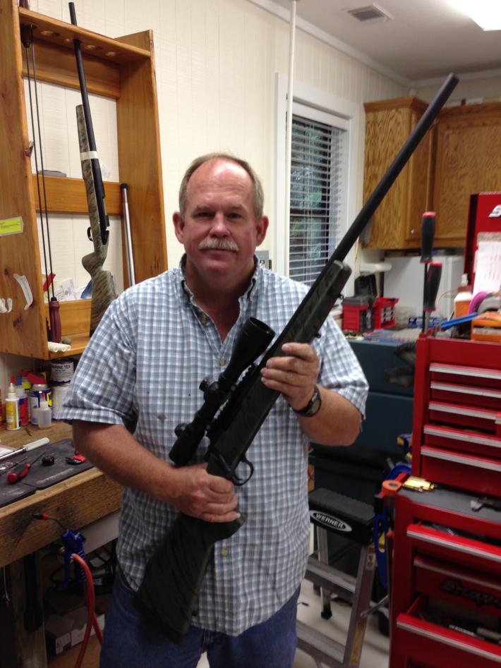

Thread moved from general reloading section: I recently took delivery of a .260 Remington made by Robert Gradous. It was a joyous day. 24" Rock, 8.5-1, #5 contour, Surgeon Action. This is my second Gradous rifle, the first was a .308 that spoiled me as it was happy shooting 168FGMM - one hole all day long. I have reloaded some in the past but do not claim to be an expert by any means. The primary use of this rifle is for hunting white tail deer. Perhaps getting involved in 600 yard competitions at the local range as well. Wanted to get the thoughts of the resident .260 experts to see if I am headed in the right direction with load development.

Don't worry, I will add more pics and a range report soon.
