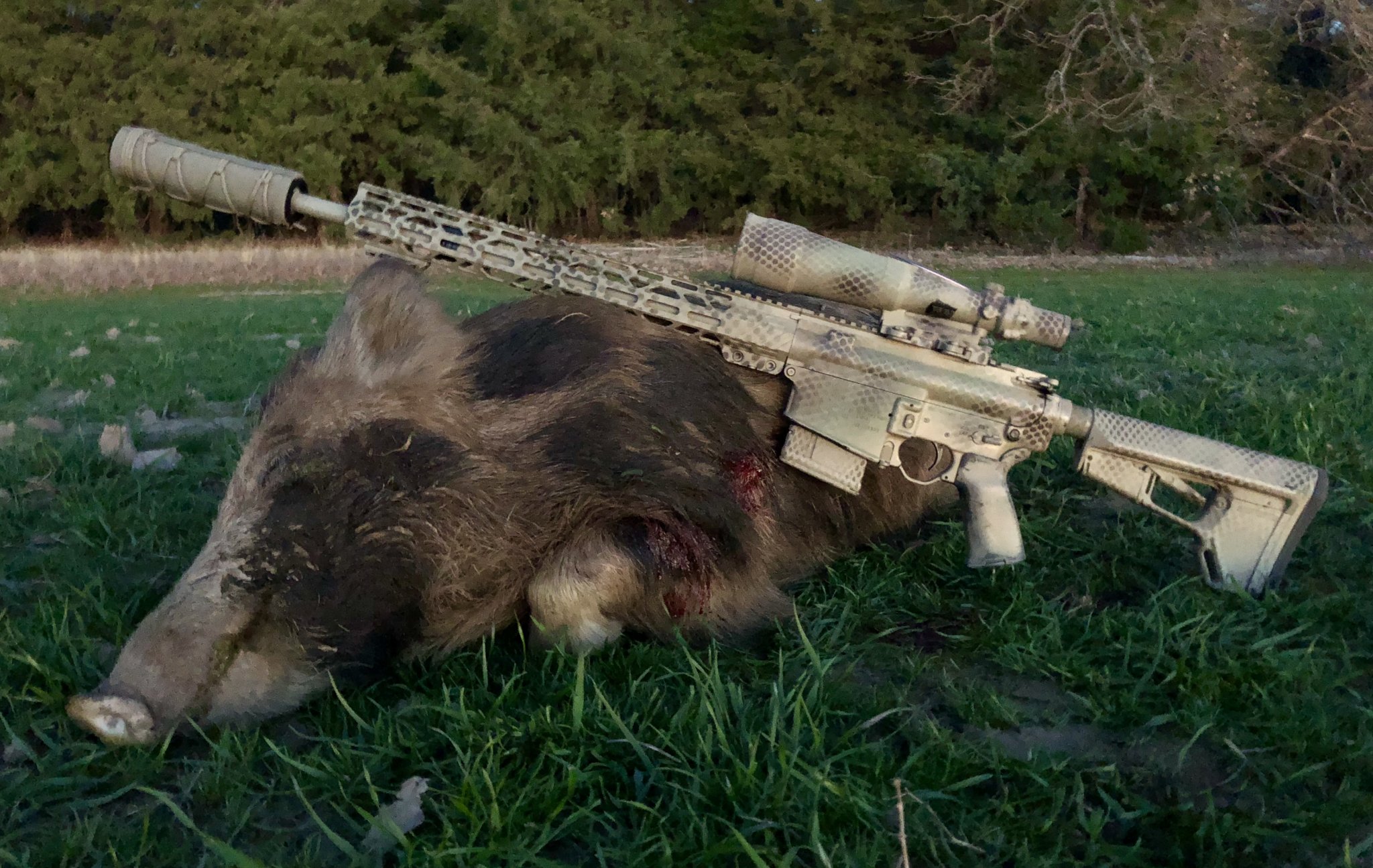

MTRMN’s response pretty much nailed it. Well built rifles for the $$ but lots of proprietary parts. I bought an LAR8 off another forum mainly b/c I got it for a little more than what the Acog that came on it was worth. Haven’t shot it a whole helluva lot (my 6.8 gets the thermal/nighttime duty) but it’s been a good shooting gun, probably a bit more accurate than my REPR at half the cost. Sent it back to RR so they could replace the Magpul MOE hand guard with a RR free float hand guard and an adj. gas block since I shoot with a can. Work was done quickly and at a very reasonable cost, so my customer service experience with RR was pleasant.
.308 will DRT a hog…
