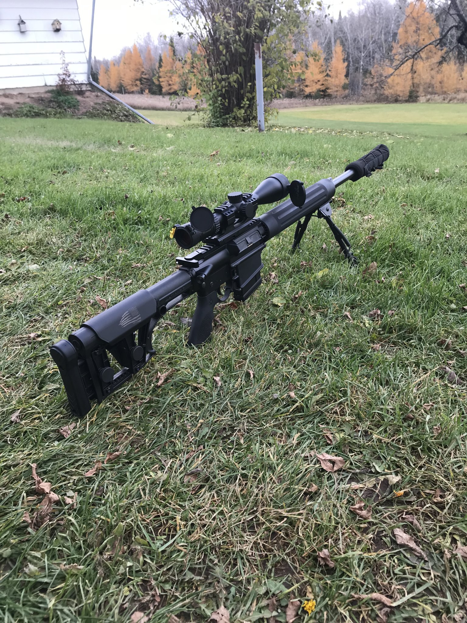

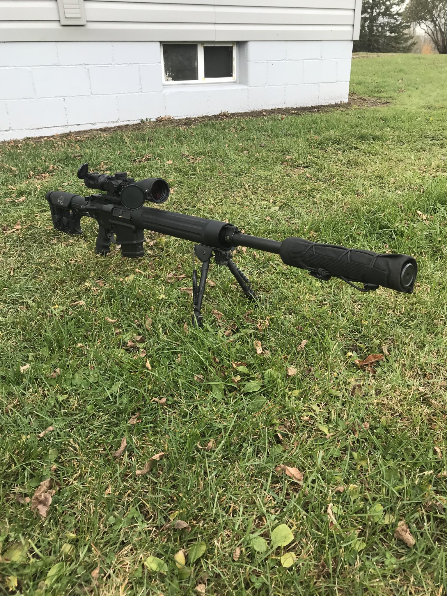

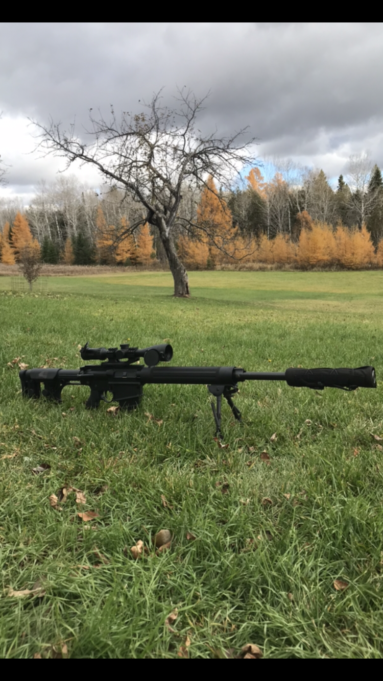

I have one. Not sure the exact model your looking at but mine does have the 20” barrel in 308. It’s a decently heavy profile - .936” at end of muzzle. I switched the Buttstock out to a Luth MBA 1. It came with a standard M16 style non adjustable stock. I also had to switch the gas block. This is a Superlative Arms adjustable bleed off block. Was servely over gassed with the suppressor on normal block. Works like a charm now. The rifle came with a brake. Think they call it the operator brake. With the teeth on the end for messing someone’s day up or Breeching I’d assume. I took that off right away because I like my gun cases and that would cut the crap out of them. The barre threads are 5/8-24 but did have a slight shoulder at the base of the threads. The brake fit over it but the suppressor did not. Had to remove those as well.
If you plan to leave as is this is a great rifle. Shot 1/2 MOA at 100 with some duty ammo. Federal GMM in 168 SMK. I did reload for it but could not get the action to not cause bullet movement. When it slammed shut on the next round it worked like a bullet puller and moved the bullet about .010”. My other rifles are bolts guns and I don’t crimp those so maybe I wasn’t using enough crimp but I set it as tight as I could and with a cannelure it still moved a bit. I just use the rifle for hunting so I switched to 165 hornady sst factory rounds and just let the brass fly.
If I was to do it again I would have gone with a build my local custom shop had for just a hair bit more money. That would have fit my suppressor without modifying the rifle which cost me more because I had them knock the shoulder off the threads etc.
But now that’s it’s set up I love the rifle. A bit heavy if your going to carry it but shoots like a dream. It always get shot suppressed. Not sure it would cycle Unsuppressed without adjusting the gas block.
It’s getting a Burris xtrII very soon. I’ve shot to 500 with the setup you see pictures, just a drop reticle Burris Fullfield E1 and it will hold MOA and drop any critter at that distance with the SST.
Some stuff for RRA is proprietary so swapping out stuff can be an issue. But everything you see here works on mine. The mags are an FAL pattern of that matters to you.
Again I’m very happy with the rifle but had to do a bit of work to it to get to what you see in the pictures
Edit: I also love the trigger on it. It’s not a jewel by any means, if I remember correctly it’s a 2- stage actually. But it’s the smoothest stock AR trigger I have (3 AR’s total).

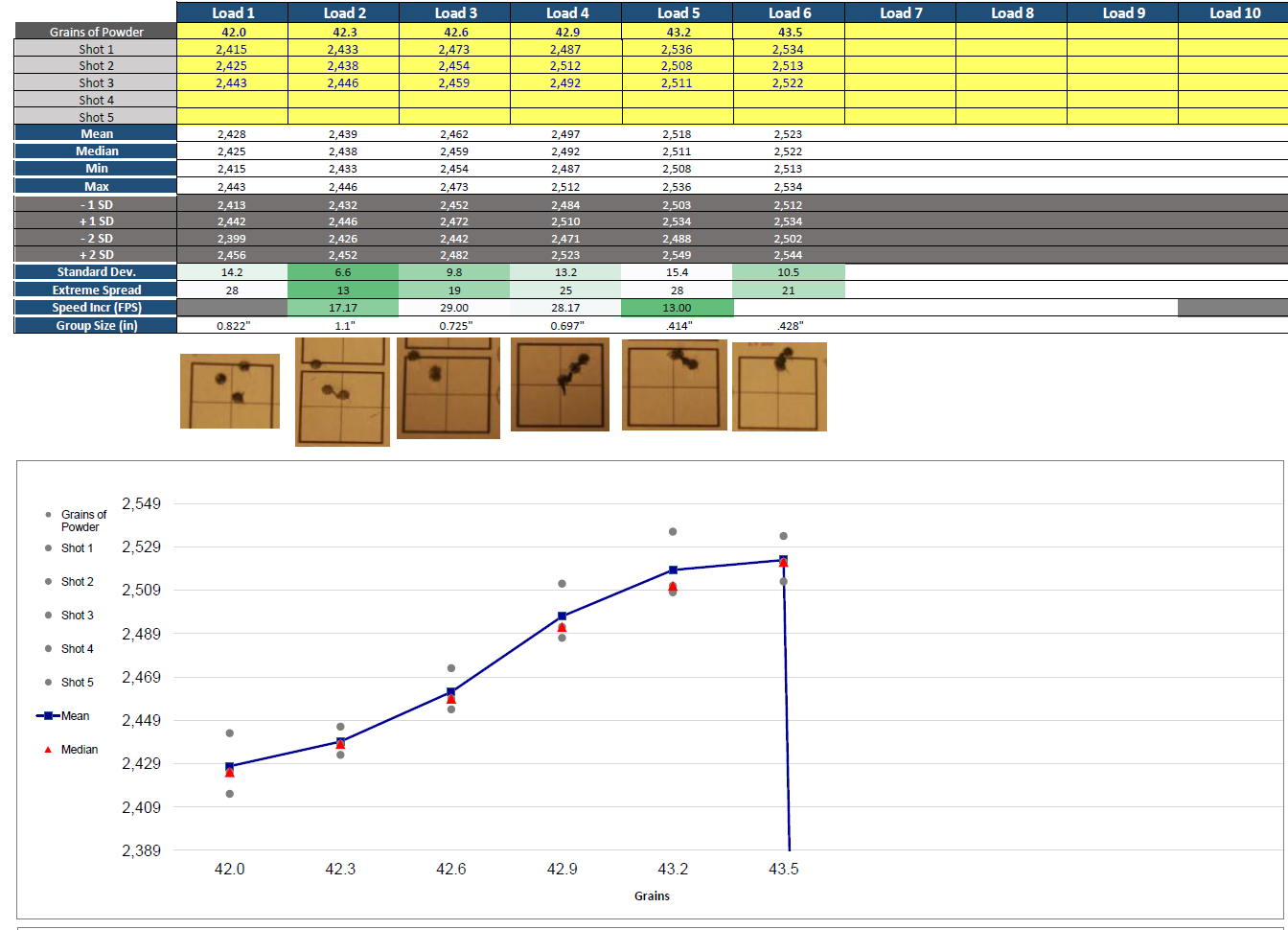

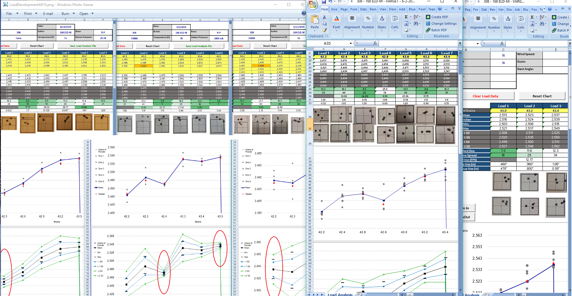

Here are a few pictures of load development I did with the RRA LAR-8 X1 with 18" barrel @ 100 yards. Tests are using 168 ELDMs over Varget, the pictures should give you a decent idea of the groups you can expect. Once I started loading at the node it produced repeatable 3/4 MOA or better 3-shot groups out to 375 yards, which is the furthest I have taken it. This has held up for ten 3-shot groups so far. I couldn't get the 178 ELDXs to a decent velocity, but had similar group sizes. It has functioned flawlessly over the 500 rounds (at least) I've shot. I'm not a fan of the adjustable stock... too wobbly.
