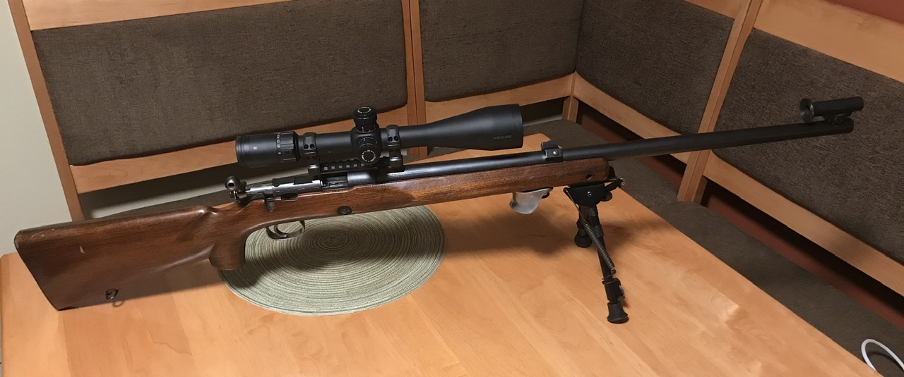

Had a decent break in the weather here in Kentucky. 40's and light wind. Decided to pull out a few .22's that needed their zero confirmed. On the list; 40x, CZ 457 ProVarmint and a Winchester 52B Bull Barrel. I zeroed at 100 as I can shoot up to 250 yards at the house. The 40x just got a 20 MOA base, the 52 got a new set of rings and the 457 was upgraded to an Area 419 base and Vortex Viper PST Gen 1 6-24x. I've had the 52 for a few years and it's been a good performing rifle. The Thomas trigger has given me some fits. Adjusting it is a process and it will still fail to fire once or twice in a shooting session. That being said, I was once again reminded that the rifle and the trigger are well worth the effort. From the bench at 100 yards I ran a 6x5. First 3 targets were with Eley P100 (1044 FPS), and the next 3 with Eley Match (1045 FPS). With the type ammo and velocity closely matched, I typically don't have to adjust the scope when shifting from P100 to Match. It make life a bit easier as I can practice with the P100 and when I want to step up my game, the Eley Match delivers. Which is the point of this post. I am constantly amazed at the consistency and accuracy. Of the three Eley Match groups I shot, two were less that .5" at 100. When I stepped back to 200 yards, the 52 with P100 shot a 3.2" group. I am certainly a proud Vudoo owner, but vintage .22's still hold a sacred spot in my safe. I know there are some other 52 shooters on this forum, as I did a search to see what 52's guys were shooting. Unfortunately, a lot of the linked photos are blurred out. But from what I did see, there's a pretty good cross section of vintage .22 shooters hanging out on the Hide. Good on ya!

Near Elizabethtown. I have a couple 52’s with iron sights and have shot them at 100 yards, with the NRA 100 yard bullseye. The 52 pictured is scoped using the Nightforce 20 MOA base. It’s not the prettiest but it’s been a good performer.
