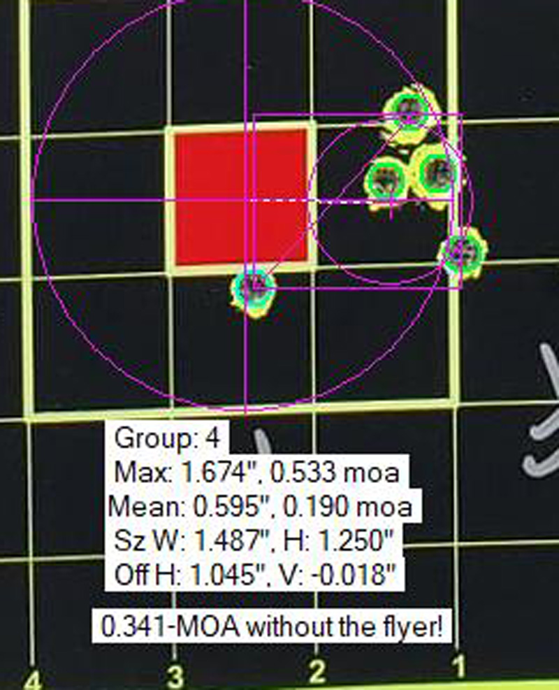

The picture below was a few weeks ago I'm a big guy and was uncomfortable on a short bench and was open or slightly bladed to the rifle on the top group or two then squared up on the rifle but was it wasn't perfect and then at the bottom group was square and had the butt pad on my collarbone where I intended to be. Then I shot the small dot in the upper left to confirm.
The results shocked me personally. Aimed to exactly the same spot each time no adjustments done to the scope. These different groups were created by very slight variations in butt pad interaction with my shoulder.

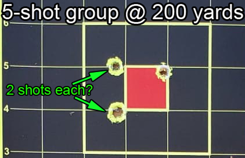

But, a week ago, I had one odd group at 200 yards.
In the end... it's the shooter (me) making the mistakes.

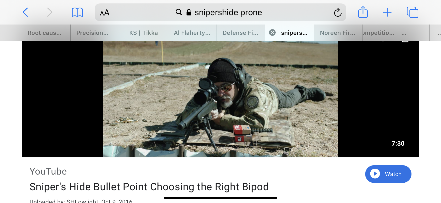

Phil's video of what I have been trying to emulate, Frank has a similar vid in his training area.
Watch his right elbow in that video. When he uses his right hand to load rounds his elbow is clearly not supporting any weight. His bipod is no more than 1 notch out.
I know the video you are talking about and I’m quite sure what @lowlight is saying is don’t lay totally flat when you shoot. You will see some new shooters do this. They almost lay ontop of the stock with the stock in the dirt.
To me the tell is where the shoulders are. If you are up on your elbows it will shrug your shoulders up. If your core is on the ground the shoulders stay neutral.
