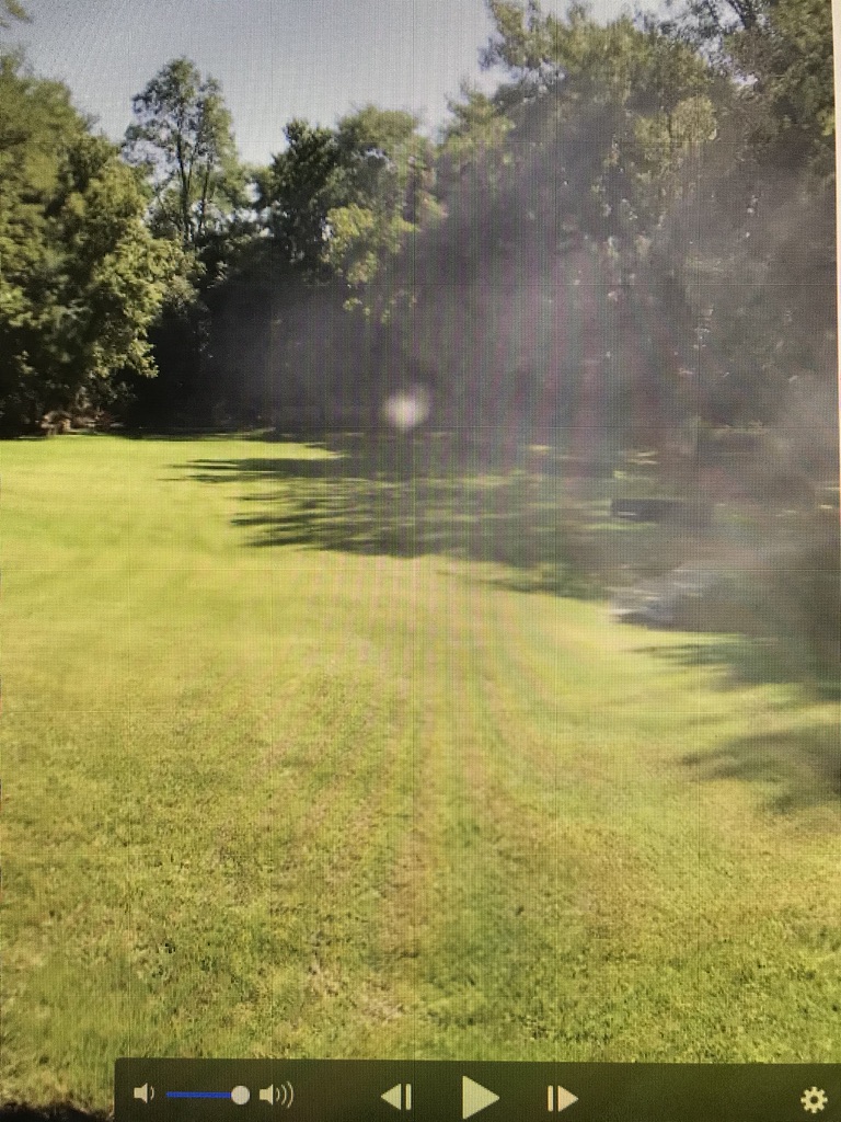

When I contacted Berger about the problem, was using their 90g.
They said to keep the RPM's below 300,000
This was a video of a 90g blowing up, wouldn't load, so stopped the frame.
The white dot is it going poof.
