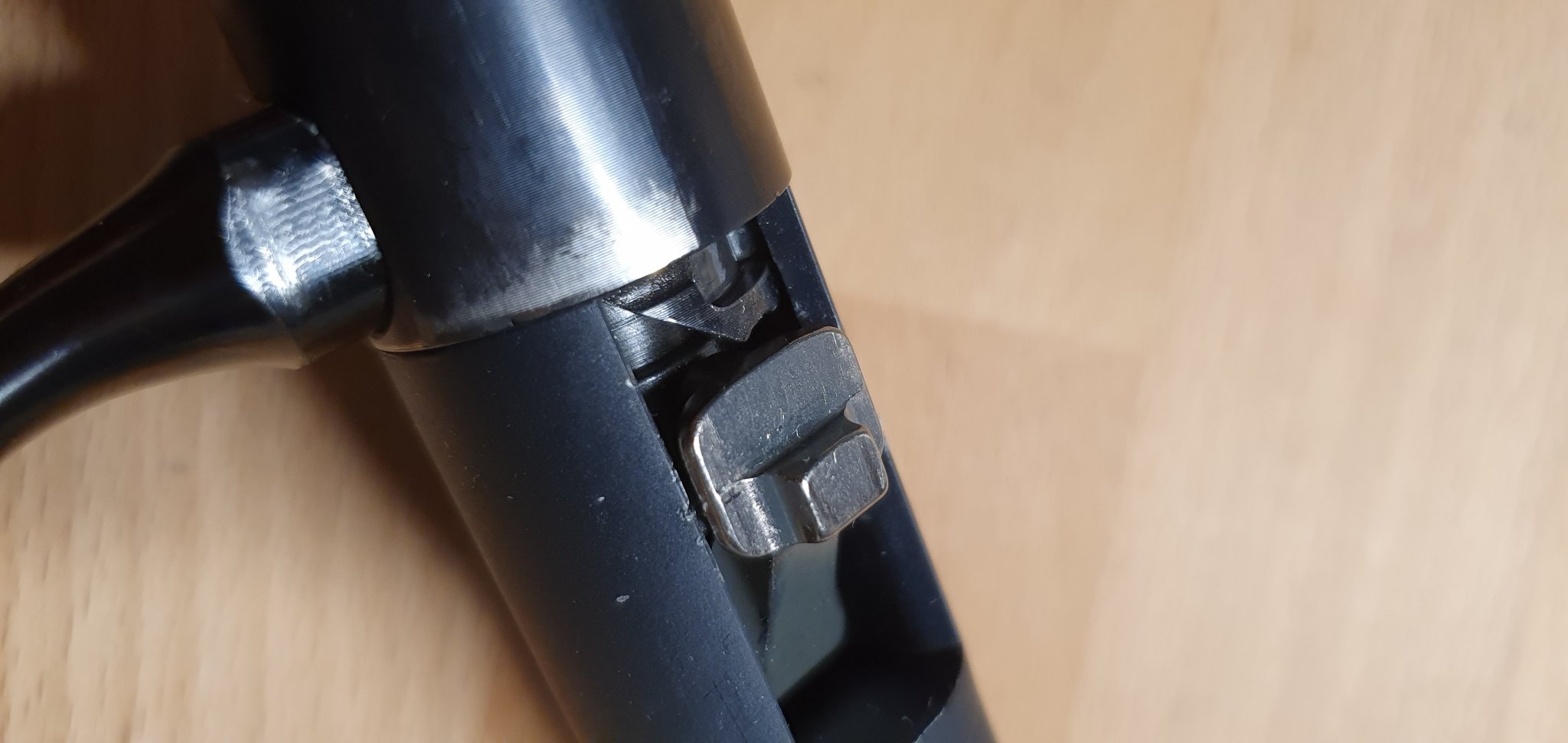

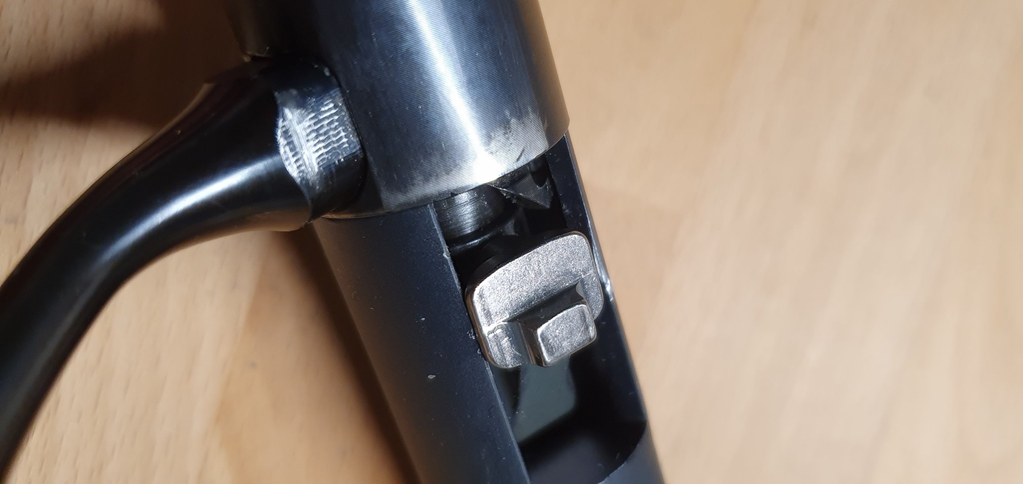

the first 2 pictures showing the firing pin with its "head". they are completely loose. they move if you shake the complete bolt.

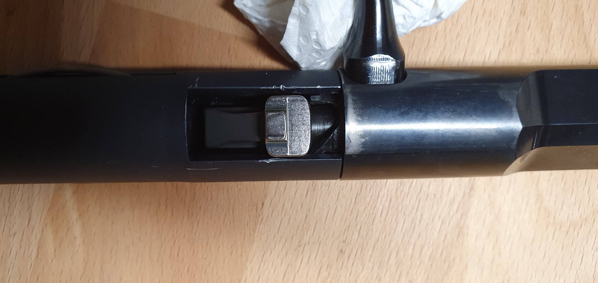

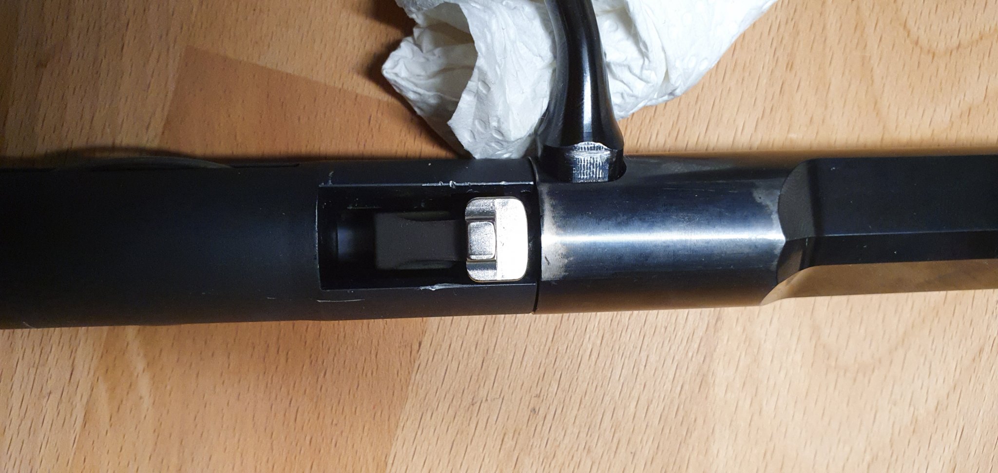

the next 2 pictures show, how far i can rotate the head on the firing pin using the bolt schroud. i tried to fix the firing pin head on a table and push the bolt down to keep it rotated. the firing pin spring is a bit compressed but this doesnt work with full success. it rotates a bit more then....but not enough..and snaps back (no picture of this status)

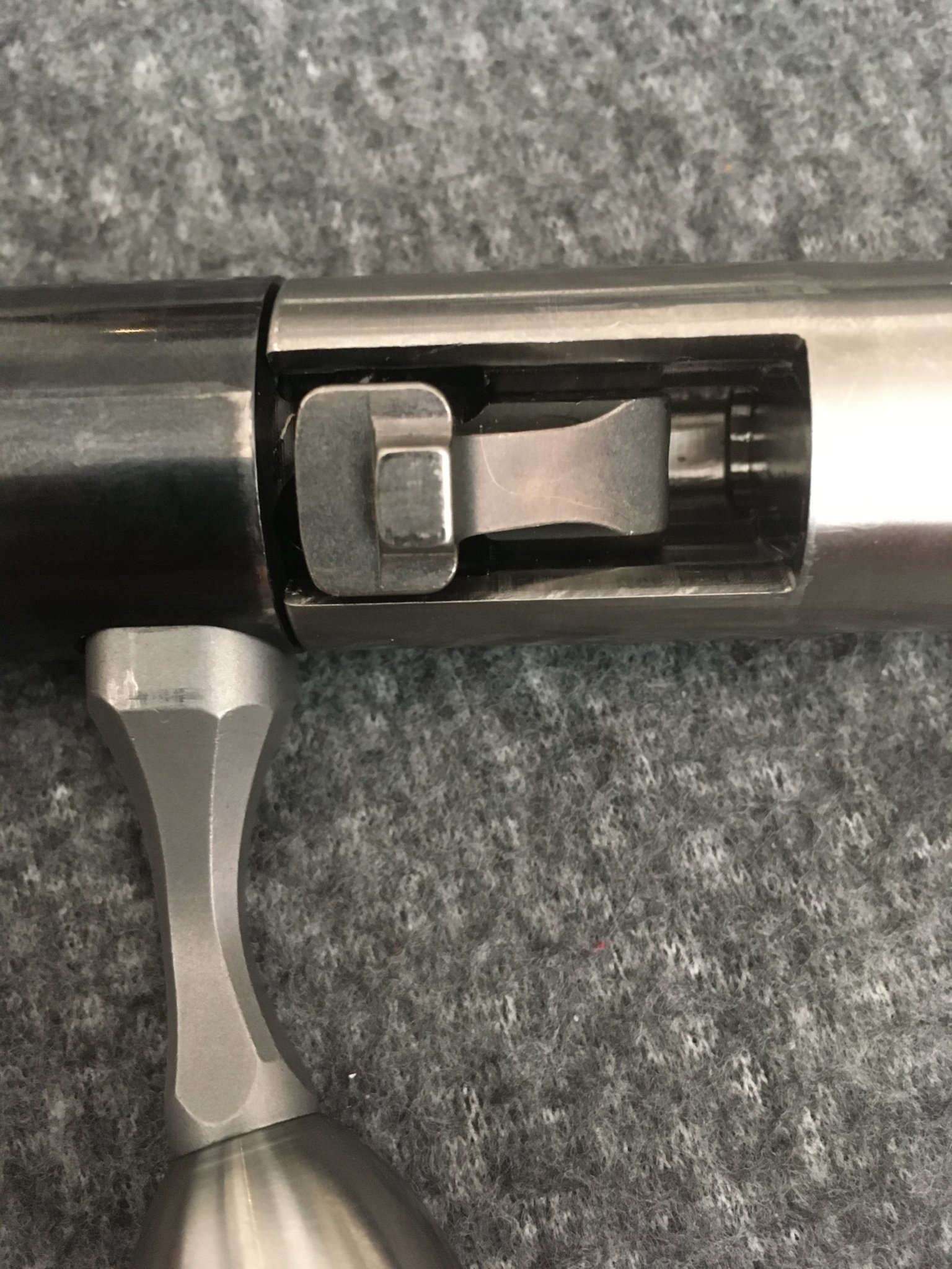

Hi everybody,

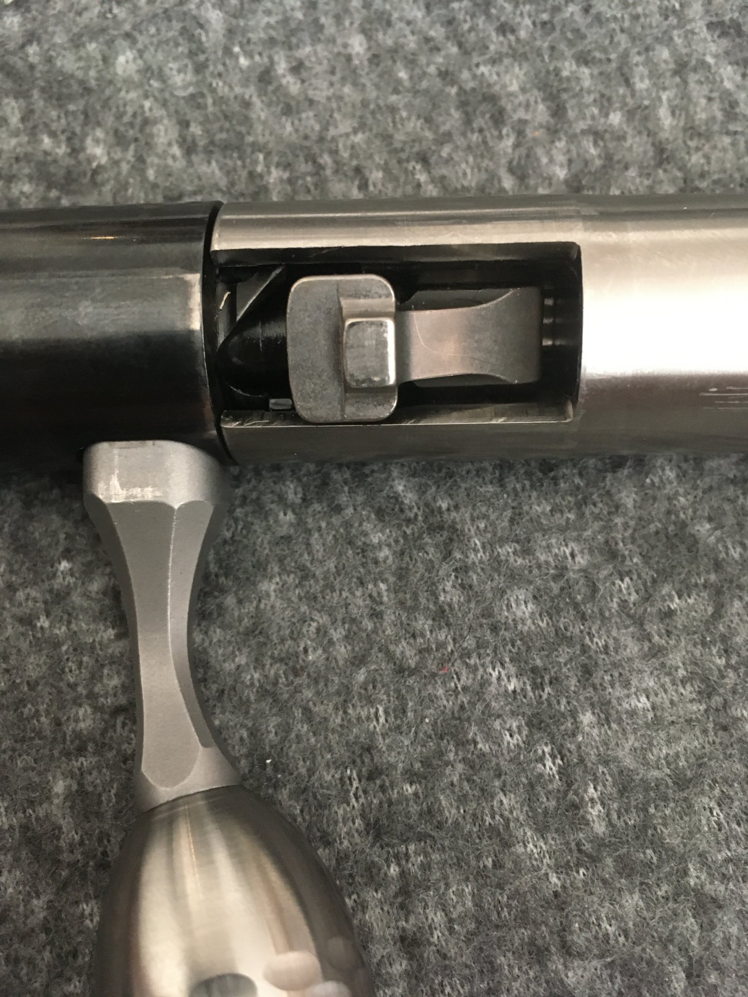

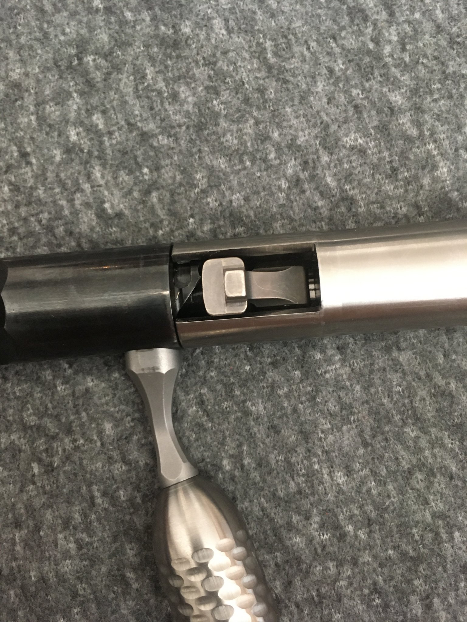

unfortunatelly I am next with same situation. New RPR 338 LM. I fired 18rounds today and...problem. Rifle has 33 rounds together!! I have RPR 6,5 CR as well and I am happy with it. Do somebody same experience with our RPR Magnum bolt problem? I am from Europe. Not easy to send it to Ruger.

I have a fix.
with the bolt shroud pointed up and looking at the cocking piece. Turn the cocking piece as far counted clock wise as it will go. It should be in the fired position with the tip of the firing pin protruding from the bolt face. Now In this position you should be able to compress the spring by using a flat head screw driver to force the cocking piece straight back by rotating it between the front of the cocking piece and the rear of the bolt. Be carful as it could snap back. Once it’s pushed back into the cocked position you will need to find a way to keep it there. A quarter inch squad rod did the trick for me. Now looking down in the shroud you will see the a gap between the cocking piece and the spring retainer nut (the part that is causing all the trouble) insert a flat head screw driver into that gap. Hold it there and Remove the item keeping the cocking piece back transferring the spring load to the flat head screw driver. now rotate the bolt shroud to disassemble the unit while maintaining pressure on the screw driver to maintain that gap.
It’s not the best write up but if anyone needs help feel free to pm me.
