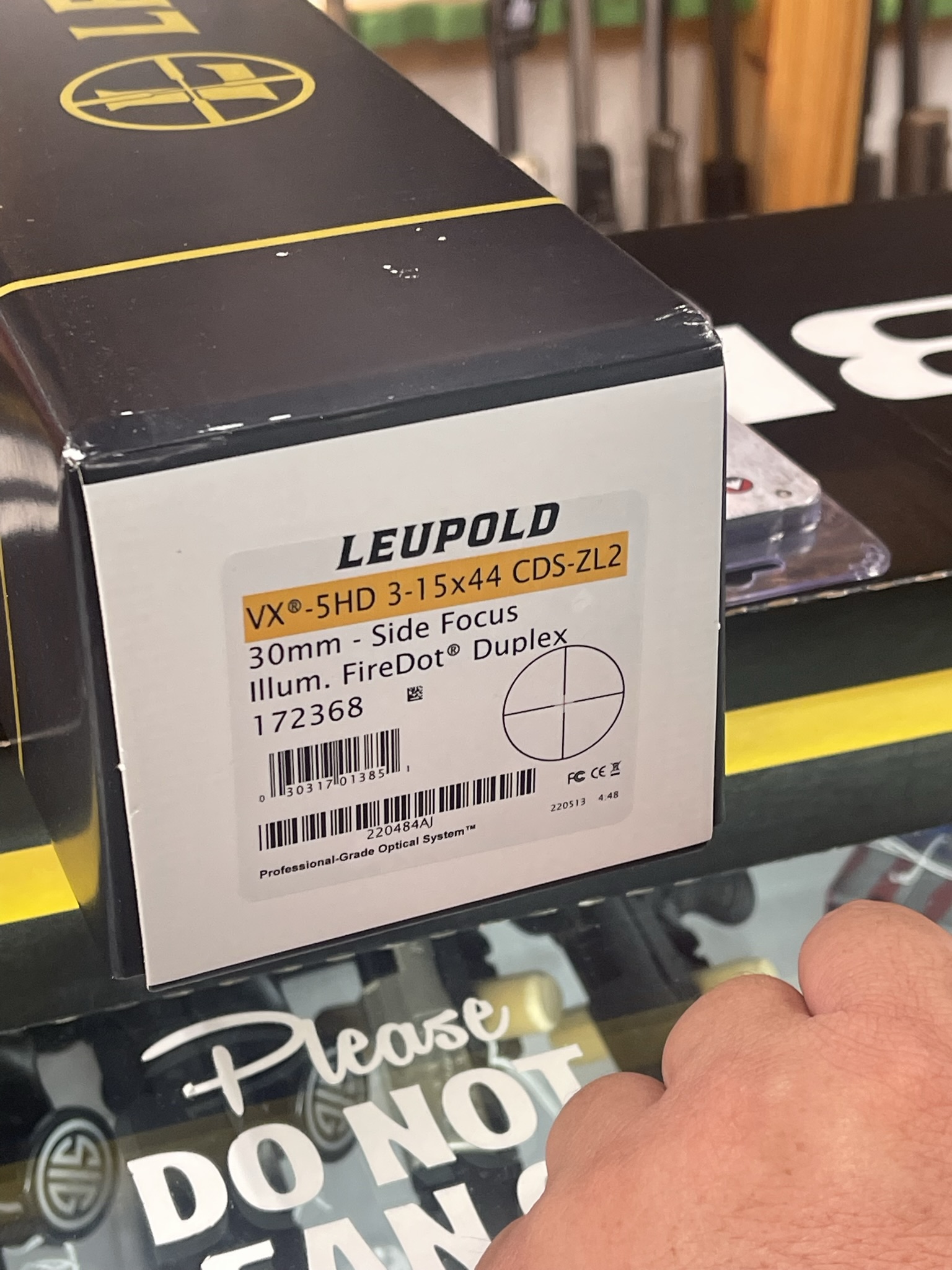

I have a leupold vx 5 on the hmr. Paid as much for the scope as I did the rifle.

So, it's not my intention to malign your purchase, but that scope/reticle combination is not well suited for longer distance shooting. Even if you dial all your elevation correction, you really need something with a reticle that allows you to hold for wind consistently or learn/correct yourself from misses. This only becomes more important the further out you're shooting.

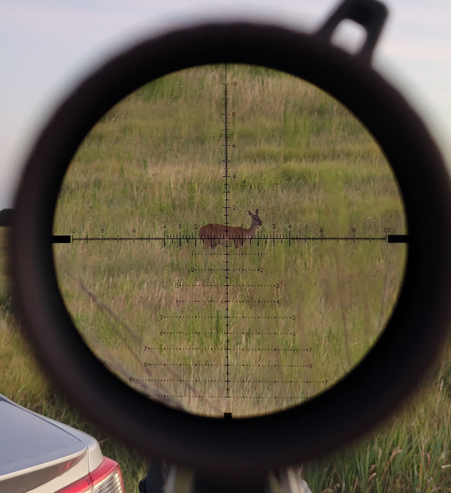

Something like the below tree style reticle might not be the best hunting optic, but allows for a lot more capability in precision shooting.
What would you suggest? I went off recommendations from the local gun shop. Supposedly one of the best scopes they had in the building and there were quite a few.

The VX5s are known to have nice glass, but the duplex reticle is really the issue. You can check if leupold will switch thereticle, but then it would be a second focal plane scope which isn't great either.
Most people on here would suggest something with a tree style reticle, first focal plane. MRAD or MOA is a personal choice, but MRAD makes a little more sense as it is in groups of 10 not 4 when counting.

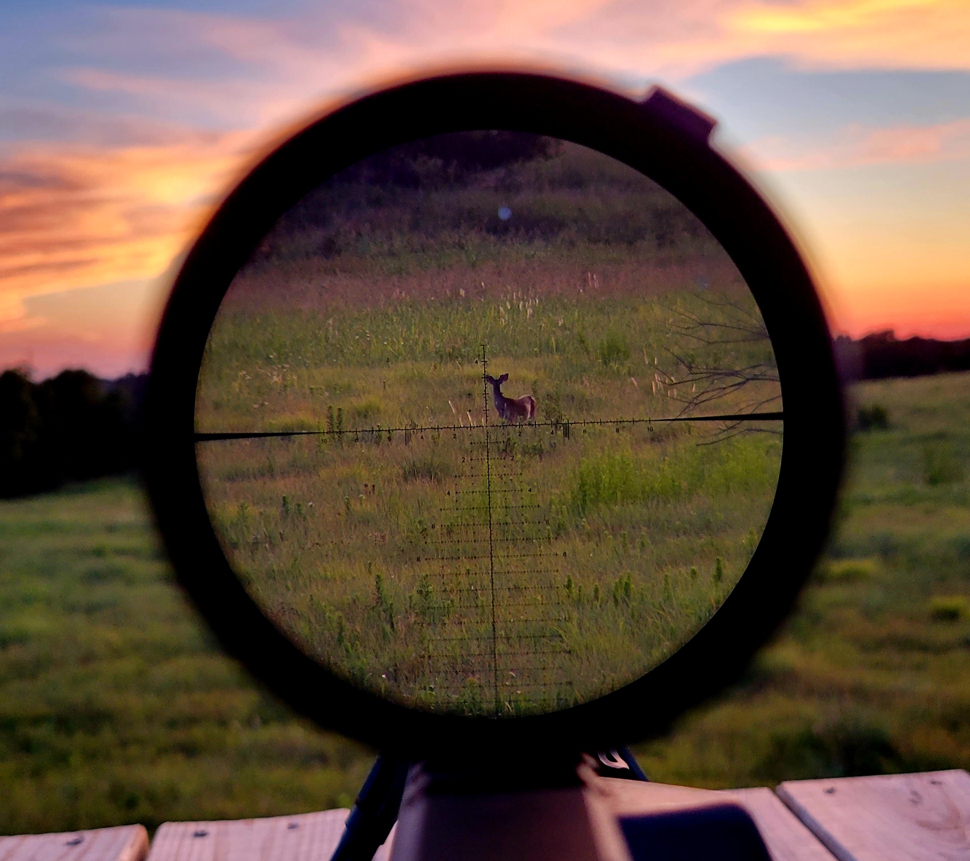

There are lots of solid scopes out there around the $1k give or take some. The Burris XTR3 scopes are excellent for the money. But it really comes down to your budget.
The pic below is through my 3.3-18x XTR3 with the SCR2 reticle at sunset at around 7x I think.
