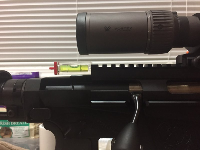

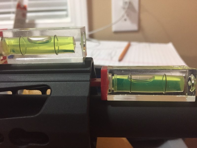

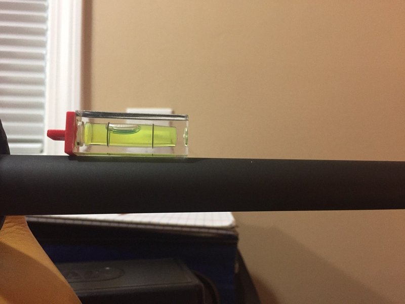

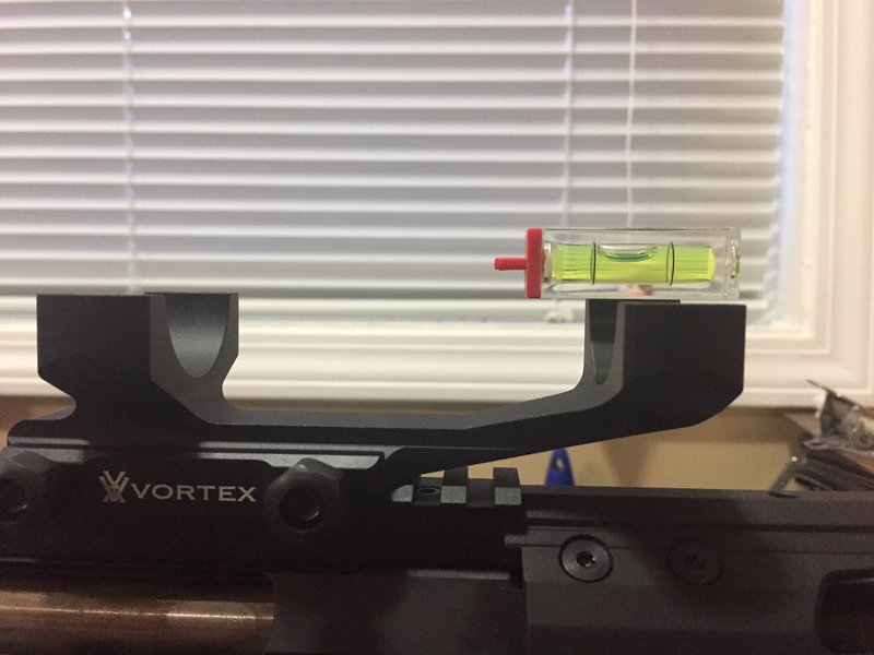

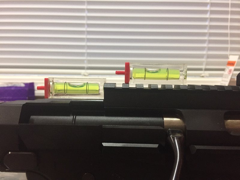

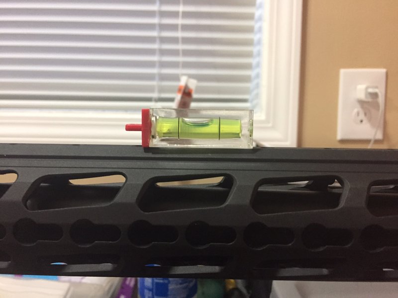

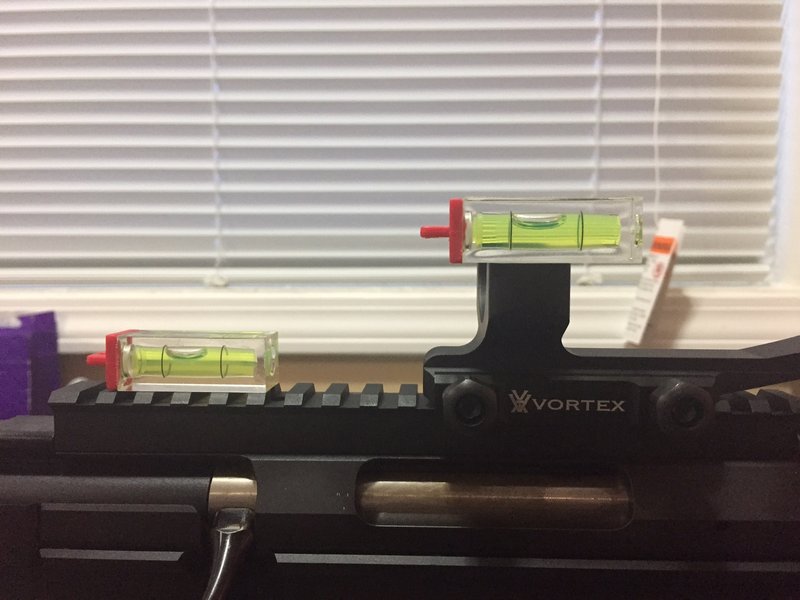

I reinstalled everything torqued it down and and used bubble levels to get everything at close to square as i could. The one picture that stood out to me is the forearm to barrel.
The rear of the receiver and forearm are both square to each other the rail is just off square but the forearm to barrel seems quite off. which is then not square to the rear of the receiver.

The external contour of the barrel is not parallel with the bore axis. The slight taper of the barrel likely accounts for the discrepancy in the levels.
Ok I purchased a 20MOA mount so that should be my solution and bring me back up another 6 mils
I will post results when i can get back out and test it out.
