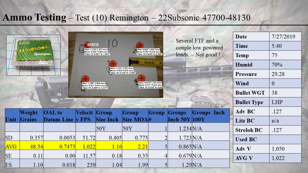

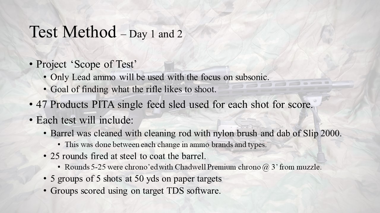

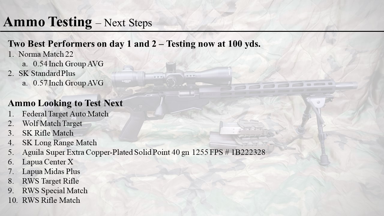

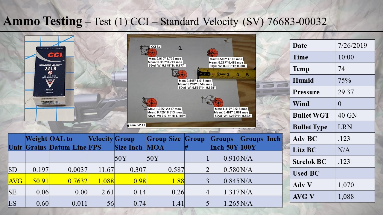

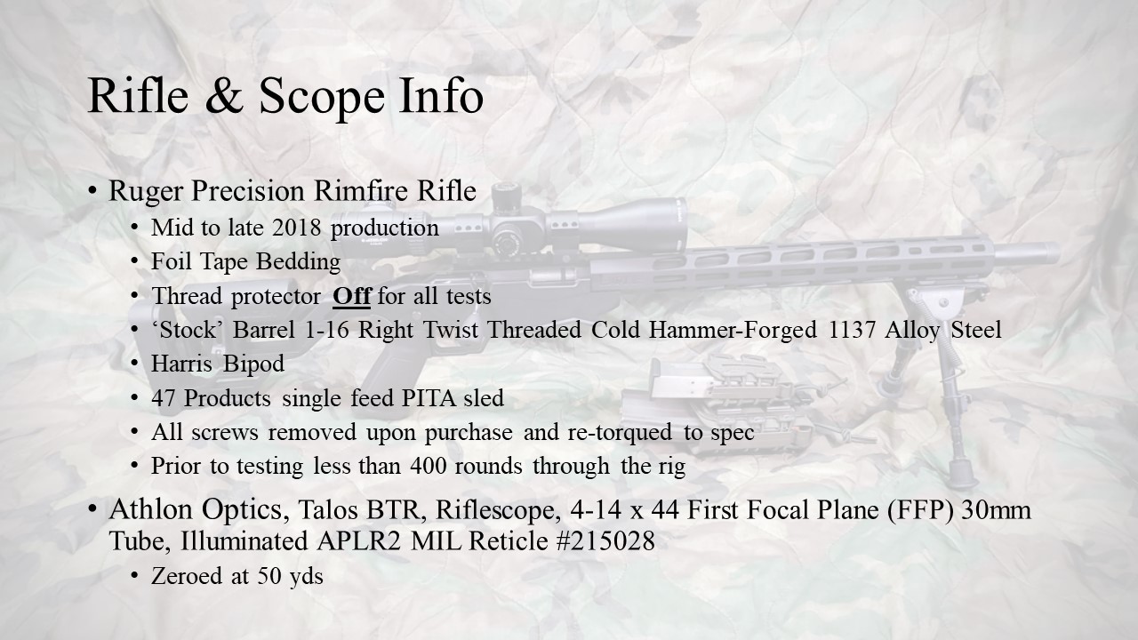

I'm conducting an ammo test with my newish Ruger Precision Rimfire.
Plan was to test at 50 yds to see what the top several were then use them to do the 100 yds plus.
please review the slides and let me know if i'm missing anything.

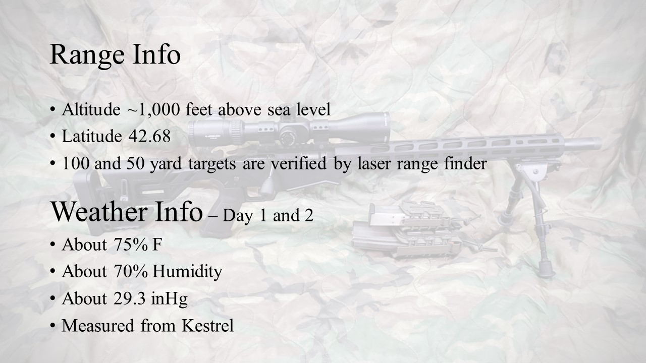

You have less than 400 rounds through a factory barrel. In my case, it took many more rounds then that before my factory barrel began to perform as well as yours does. Mine was made in the first month of production with a less than stellar reamer. I've got over 8,000 rounds through it now, and the problem has been lapped out Lately I've noticed reports from newer owners that seem to indicate the Q. C. at Ruger has perhaps improved. I hope so, the RPR has turned into one of my favorite guns, even, or maybe because of the work it took to get her to shoot.
Your report---
I don't understand the data in the collums under "weight in grains" and under "oal to datum line" and I see this info is not in the grid in the last slide.
Are you shooting off a bench or prone, rear bags, time between shots, etc. I'm not criticizing, but if I were to replicate your test with my gun at my range,, how would I set it up.
How are you coming up with the BC info?
You said for the tests on day 1 and 2 will only shoot lead. But you're going to use some copper washed Aquila in the next test. Why? And if you do, maybe you should shoot it last.
I like what you're doing, and I would be happy to donate a couple of boxes for testing if you can't get them locally
Reactions: RackOpsTactical

@Eoddave27 thank you for the feedback. I do understand the lot to lot variation. I'm looking forward to the next tests assuming i can find a couple more of the better types of ammo to shoot.

@Booner1334 thank you for the feed back! that is interesting on your factory barrel. thank you for your question as I now suppose I should add an explanation of that information on weight and datum line.
1. Weight was measured using my RCBS chargemaster Lite. what I did was measure 10 samples of the box I was going to shoot. then looked at the stats related to that. the running theory in reloading and ammunition in general is that the more consistent the components, powder charge, and especially in this case the primer charge, the better the ammo with perform. this is what leads people to weight sort their components (arguable benefits) in center-fire reloading.
2. Datum Line Testing. I measured the case from base to the datum line with the hornady comparator (on 22 cal) on a caliper. this measurement allows for an apples to apples measurement of overall length of cartridges with different bullet shapes. showing approx where the bullet will touch the rifelings. Also it's an indicator of quality of manufacturing, and another theory is that certain bullet heads or heads with certain lengths may do better with different barrels.
these two were not on the last slide for test 11 because that was a retest of a different lot of CCI SV.
Also a fair question about the shooting setup. All tests at 50 yards will be from a bench, with rear bag, supported by the front bipod. All tests at 100 yards will be prone, with rear bag, supported by the front bipod. i'm not using a lead sled for this test. Yes that will put in a small amount of variation into the process but that's why every test will be 5, 5 shot groups and not less than that.
I researched the BC's from the manufactures website. If the website didn't provide a BC but did provide velocity numbers from 0 to 100 yards (Which most did) I used their velocity numbers and JBM ballistics BC calculator.
The other BC info i got from the Applied Ballistics Phone App and the Strelok Pro phone App. Both of which have been very helpful for Rimfire try dope on my initial (non documented) 100 yard tests.
As to the lead vs copper question, You are correct and I missed the fact that that particular one wasn't lead.
As I stated I live in an area where I am having a hard time sourcing most of the better quality ammo, and i'm limited to what i can get online. I'd welcome any help in that area!
Thank you guys very much for showing interest in this testing. I'll be posting more soon!

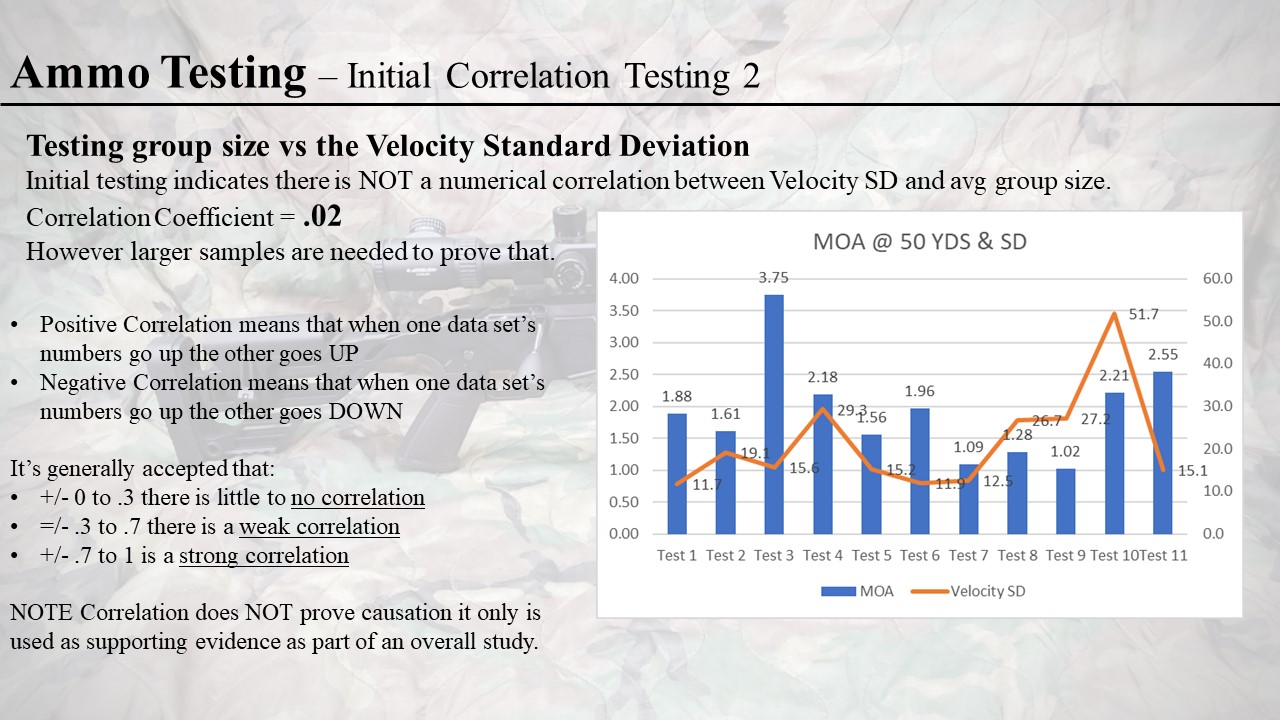

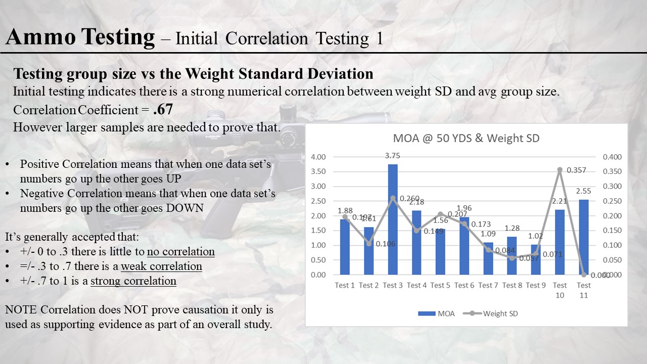

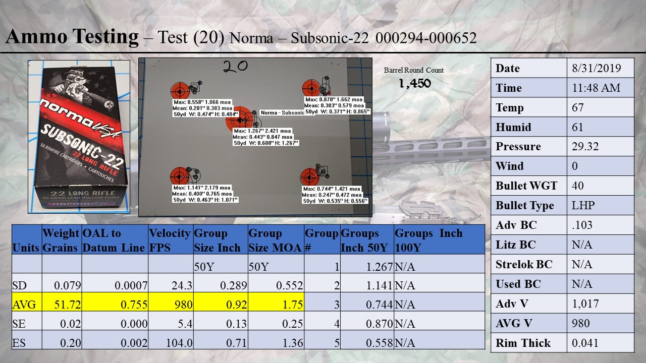

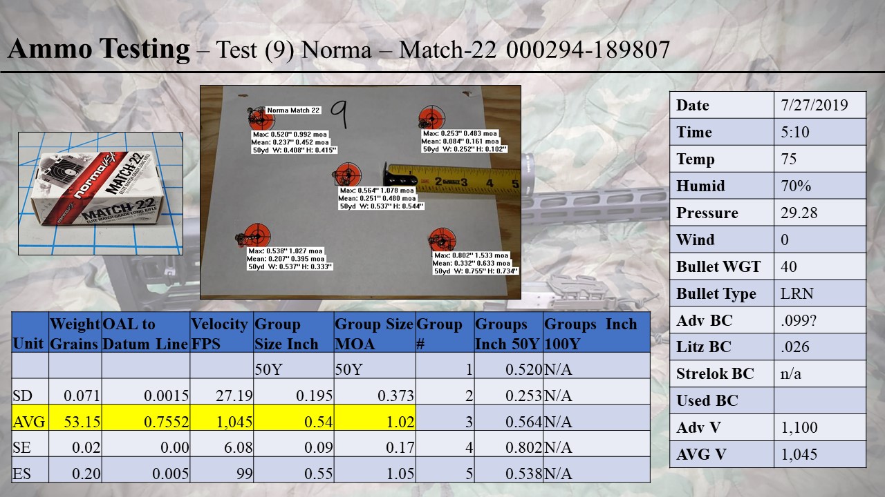

The following initial data analysis is very interesting. Of course it doesn't prove anything yet but still interesting.
Let me know what you guys think.
Yes, it is interesting.
For me, any time we look at data involving MOA/group-size in judging ammo performance, I can't give much weight to it as there are factors included having do do with a shooter's proficiency as well as environmental effects. . . and then there's the difference on how ammo performs in one gun vs. another. So, in taking those factors out, I'm left with looking at the ES and SD numbers to get an idea how some ammo "might" perform in my particular gun. Even then, when just looking at ES's and SD's, I must consider method and quality of instruments used to produce the numbers. Now is one is able to use a very controlled environment and really high quality equipment, along with massive amounts of data, then the numbers would have some real meaning (kind of what Lapua does in their testing facilities).
However, for the ES and SD numbers, I find it great in seeing the data that many shooter's provide here and adding it to my own that gives me a good sense for how various ammo compares to each other and what I might expect of certain ammo.
I really appreciate the effort and the insights that shooter's like you provide with publishing the results of testing like this. It really does help as I add such info to my collection.

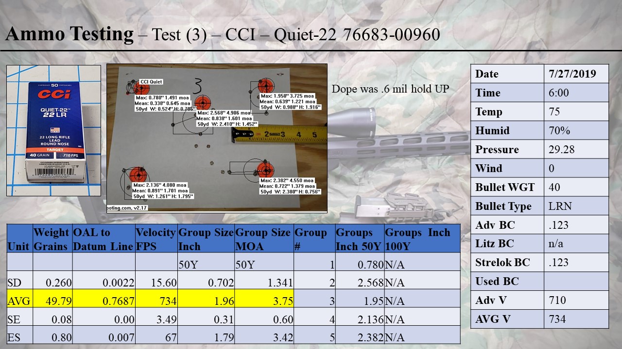

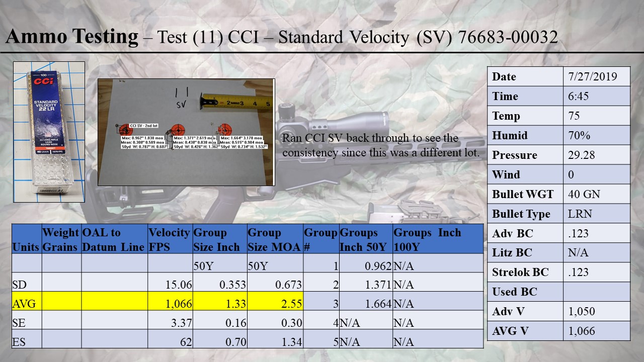

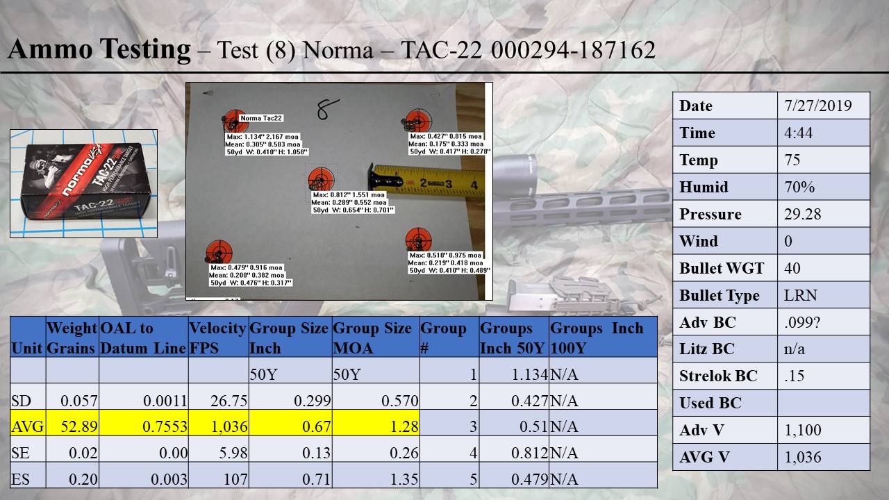

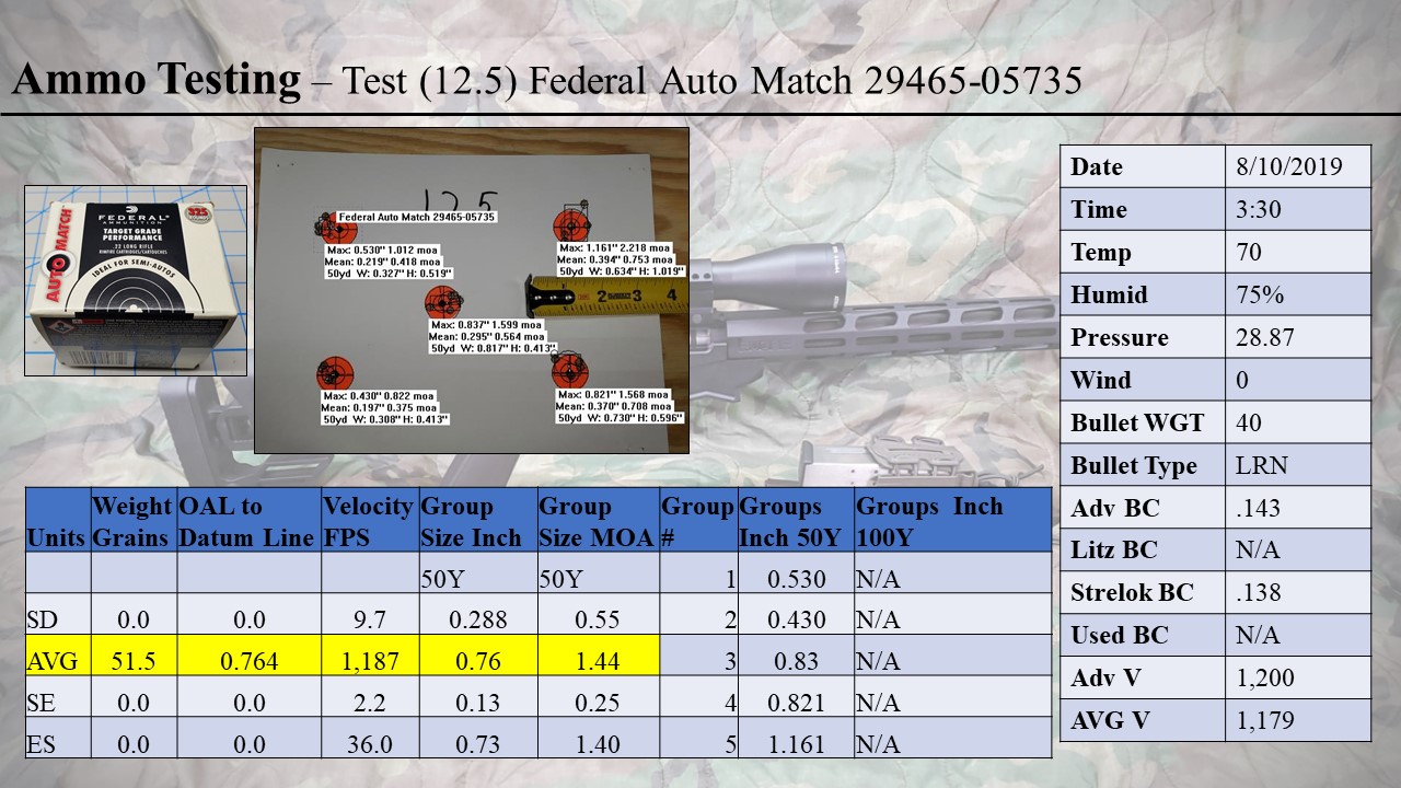

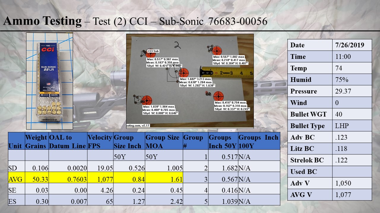

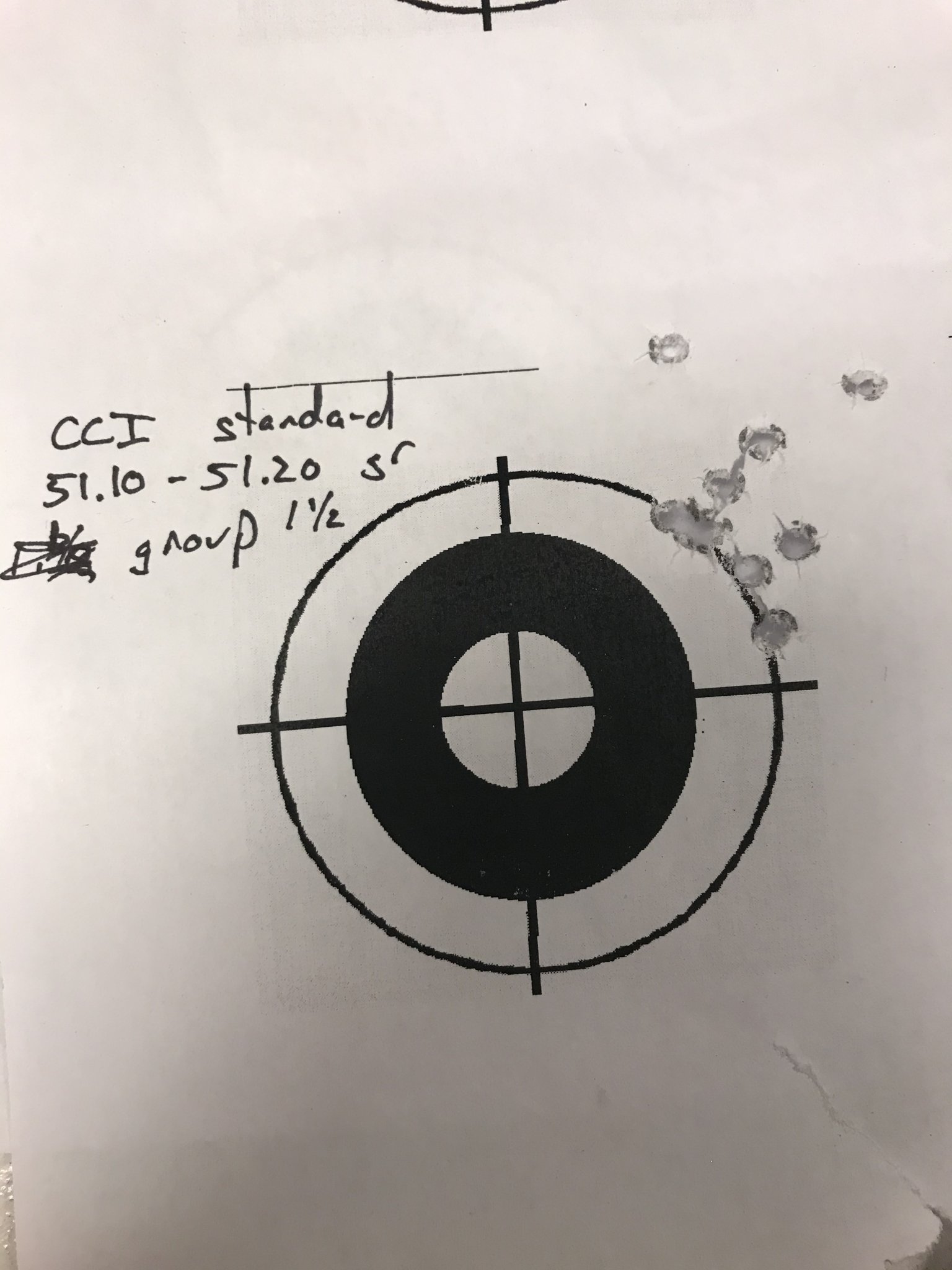

Got a couple more tests done this weekend.
I did the Federal Auto Match 2 times as I've seen some good feedback from people using it and "Sorting" through for the "good" ones. I sorted out the center of the weight and then of those the ones with the same OAL. I did the ones weighing 51.5 grains, and OAL to datum line of 0.764".
As you can see the Fed Auto Match didn't do any better sorted, but overall it did fairly well given the price and availability.

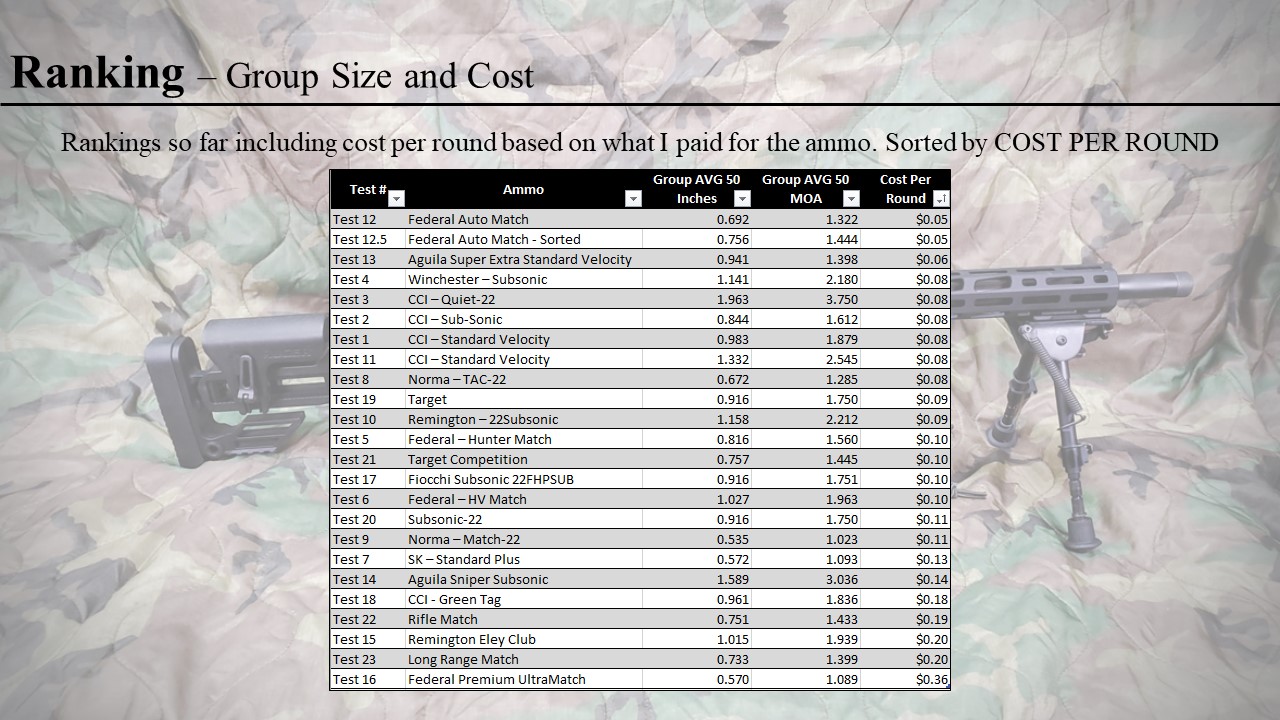

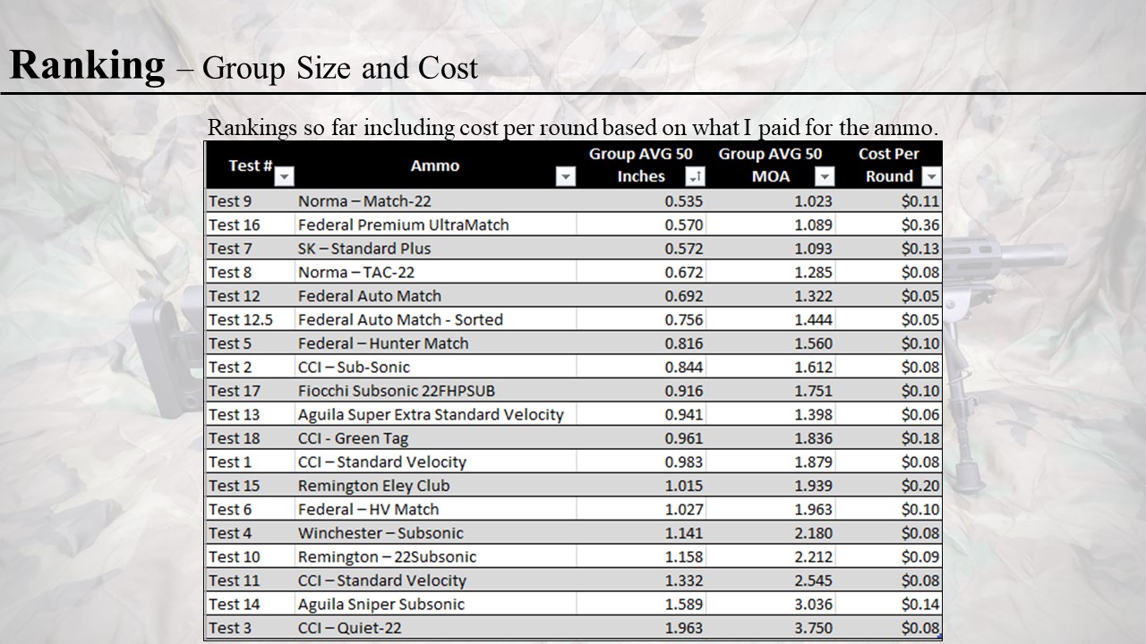

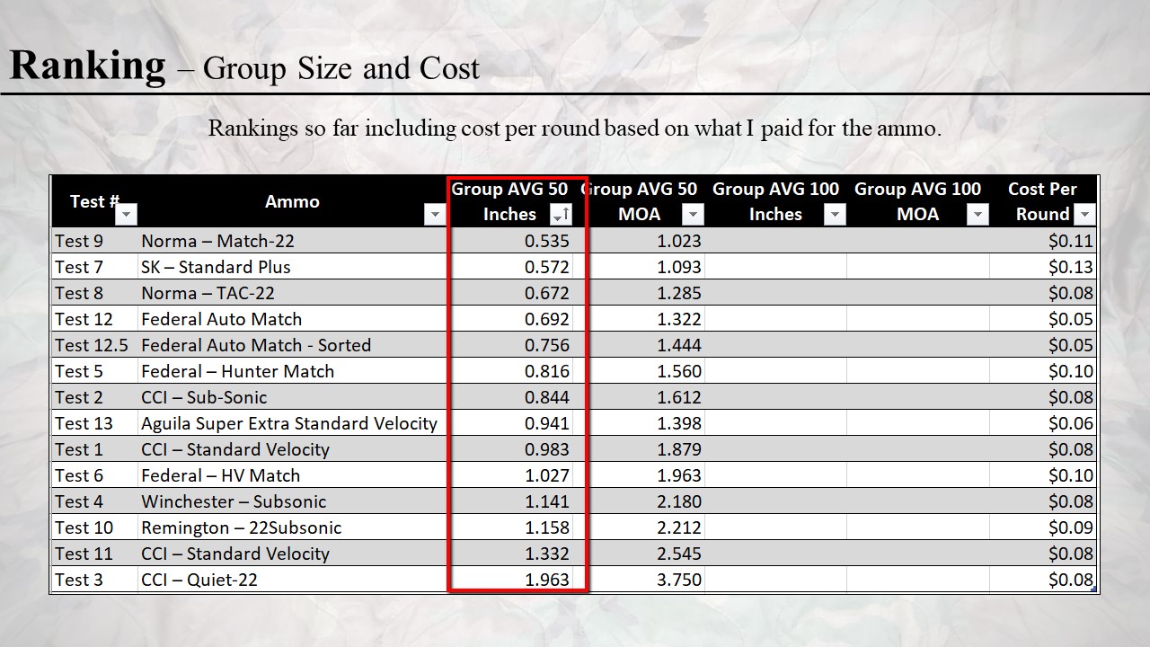

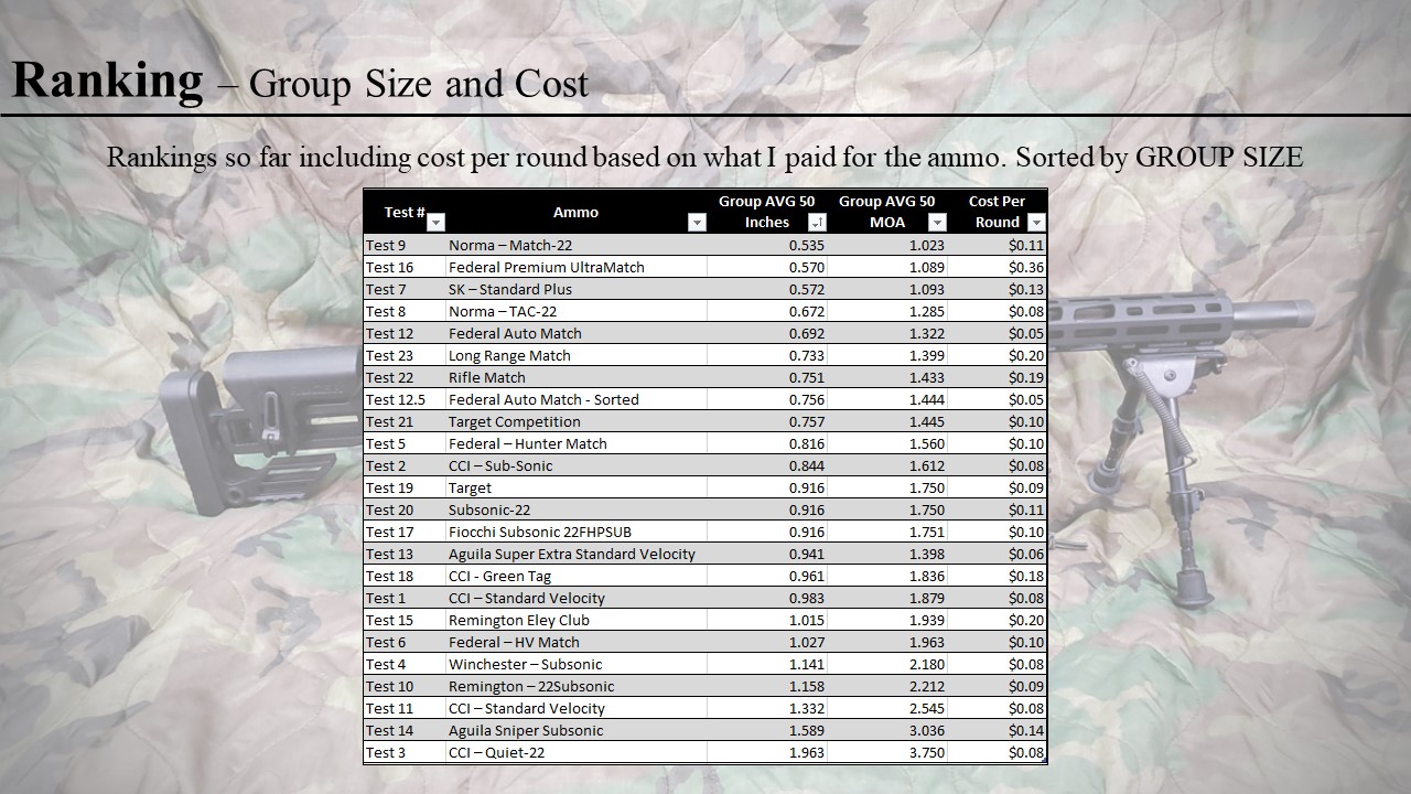

This is the current rankings based on my testing. Remember once I get a few more done i'll take the top contenders and do 100 yds.
i've had the same experience with Federal's Auto Match. It was quite a surprise to me for such bulk ammo to do as well as it did. In fact, I found it did better that other Federal ammo I've tested (e.g. Range Pack; Champion . . . though Champion is at a higher velocity). Federal Ultra Match has been top dog out of my RPRR with Center X close behind; even rivals the likes of Eley Tenex and RWS Premium (though price is in their range too ;)).

So my immediate take away with your testing is, at least at 50 yards, your best groups are with ammo that is more consistent in their weights, verses ammo that is more consistent with it's velocity. This is a little surprising to me. One would think that ammo with the lowest spread (SD) would have the tightest groups. Perhaps this is a function of range? The longer the range that one shoots, the more important velocity becomes to a tighter group...….Sounds like you have a lot more testing to do!
And how consistent the weight of the round is (lower S/D), perhaps is an indication of how well the round was constructed? And perhaps this is more important at a shorter range and as you extend the range velocity become more important...…..Sounds like you have a lot more testing to do.
I did like where you did an analysis of cost vs accuracy, as I'm always looking for this. For me right now that's SK rifle match. I'm trying to decide if going to an after market barrel will help in this regard.
We need to keep in mind that Standard Deviation is a statistical measure of probability. You may or may not get groups associated with a particular SD and depends on the size of the sample taken to get the SD figure. But, I think we can make some reasonable conclusions in comparing SD's between various ammo. Just don't be surprised when one doesn't get the grouping the SD might suggest. One could get tighter groups or wider groups for a particular SD (particularly given a small sample) given that just one way out of the norm cartridge can throw things off.
This is pretty much proven in the precision shooting arena. One of the key things in their load development that they're after is getting their velocity as high as possible within a good load node . . . not just to to reach out further, but to flatten the trajectory as much as possible and have as little flight time as possible . . . all to produce as small a group as possible.
Yes . . . IMHO, I'd say that SD's of a sufficient number of rounds are the best evidence of how well particular ammo is constructed. That's how I look at SD's and only to that extent.
Looking at it as cost vs "accuracy" is really hard to determine . . . since accuracy involved so many factors outside of the manufacturing process. Cost vs consistency, seems to me to be a better approach. . . ??? :cool: :giggle:

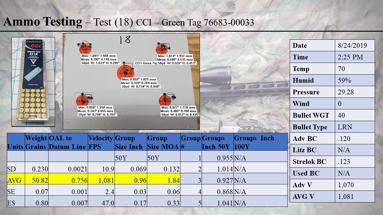

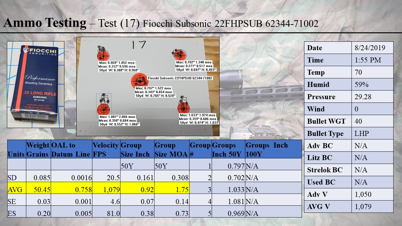

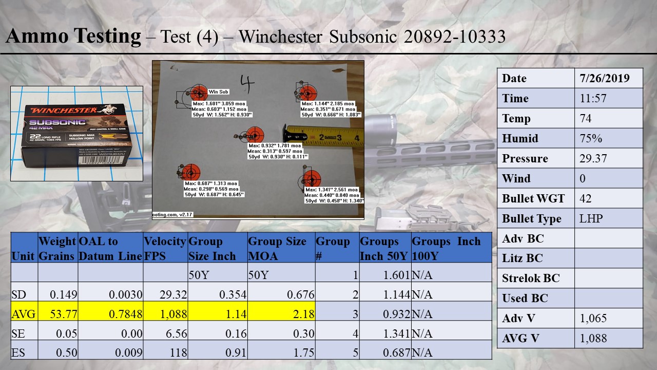

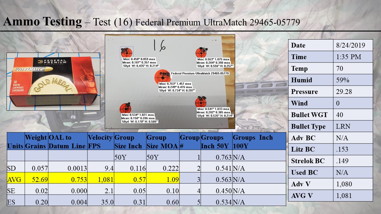

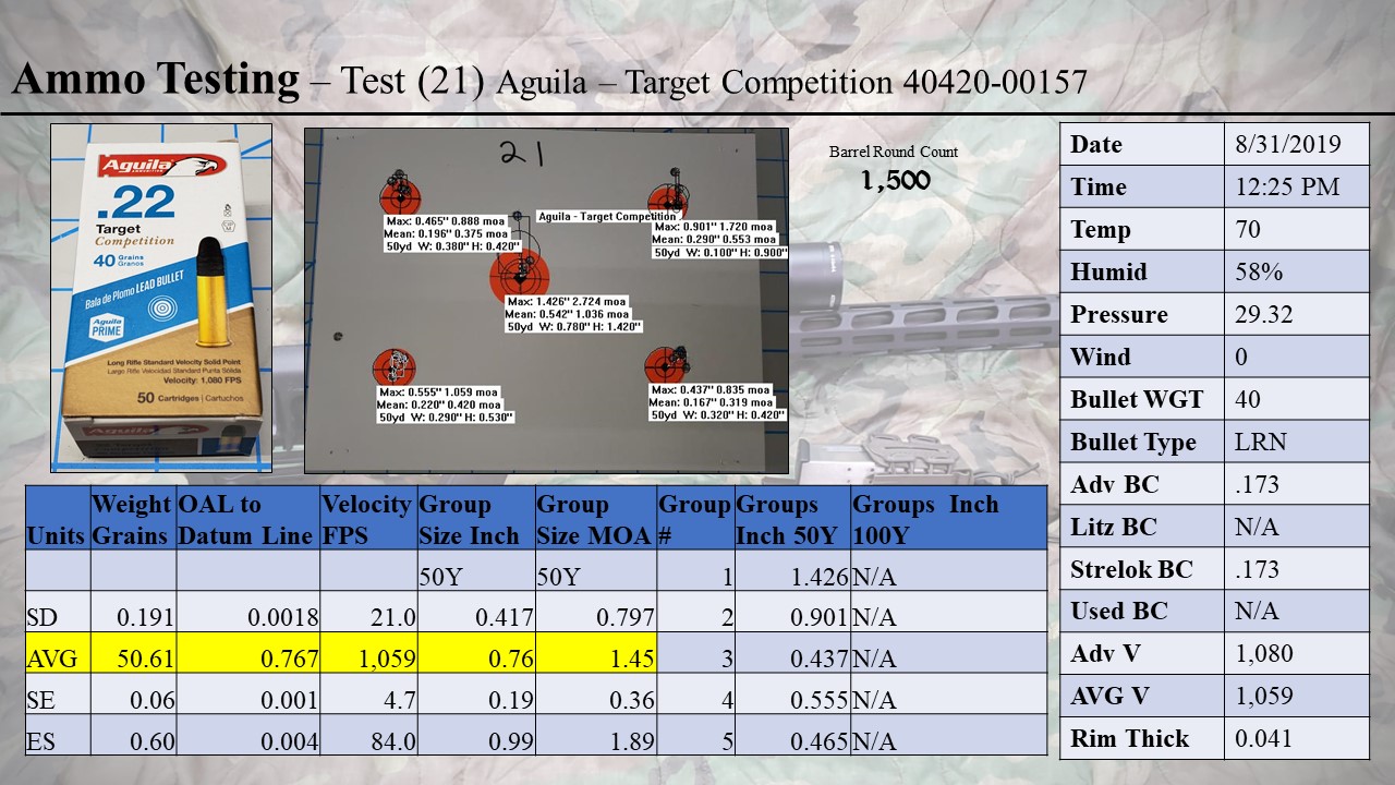

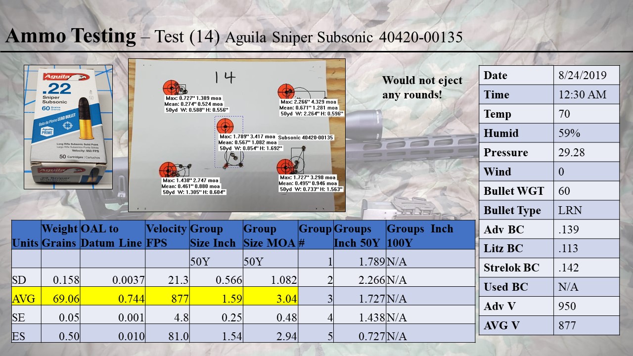

Did some more testing today. Tested 2 very expensive (at least to me) brands.
The Federal Premium Ultra Match was very expensive and did OK'ish...
Was very disappointed with Green Tag performance vs cost.
Updated the rankings with latest performance vs cost.
Reactions: JBattles

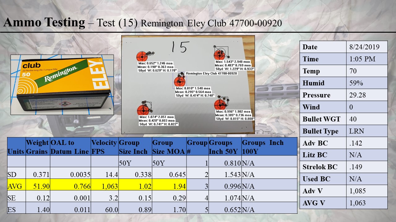

While I've had very similar results with all of these, my ranking typically has to do with ES and SD's in order to take the variable of shooter skill out of the equation. Interestingly, if I were to set up a list like this, it would be very similar. For MY RPRR, the Federal Premium UltraMatch is the one that does consistently well in my rifle and would be at the top with Center X a close second (followed closely by Midas and RWS R50).
One of the surprising things to me was that CCI Green Tag doesn't really do any better for me than CCI SV's and at the price one pay's for Green Tag . . . it's very disappointing. In fact, it mostly did worse and I'm sorry I bought a brick. I just didn't think it'd be that bad.
For most practicee, the CCI SV is what I like to use most followed by Eley Club (which does somewhat better than SV's and is good practice ammo that doesn't cost as much as what you've paid. . . like I get it for around $0.12 round. see: https://www.brunoshooters.com/mm5/merchant.mvc?Screen=PROD&Product_Code=10852 ). Am surprise you had to pay so much for Eley Club; must be due to having the Remington label on it. . .???
Federal Auto Match and Norma Match 22 has also done well for me, but not as consistently so.
@straightshooter1 I agree with your point about the ES and SD that's why I spend so much time collecting the data on that stuff. I am honestly a bit surprised that there isn't a stronger correlation with velocity SD and group size. My experience with center fire is almost the opposite of what i've found with rimfire.
on the remington Eley club i'm not sure if there is a difference in this one vs the normal Eley club. I bought it at a local Bass Pro shop. It looked like they were not going to carry them any longer.
on the green tag I was disappointed, i wanted to love it. I'm still going to test it at 100 yards.
the CCI SV has also not done too well overall. although I do plan on testing a couple other lots. I know everyone raves about it and I understand for the price point why.
I was also surprised and disappointed that sorting the Federal Auto Match didn't pay any dividends. However for it's price I do have to say that it did good enough for say when my kids are shooting.
On the Federal UltraMatch I was hoping for better because all of the "numbers" were very good for how consistent. And for the price at least I have a good reference point for where they best is on this rifle setup. After all we've got to remember that I'm into this setup for $650 for both rifle and glass.

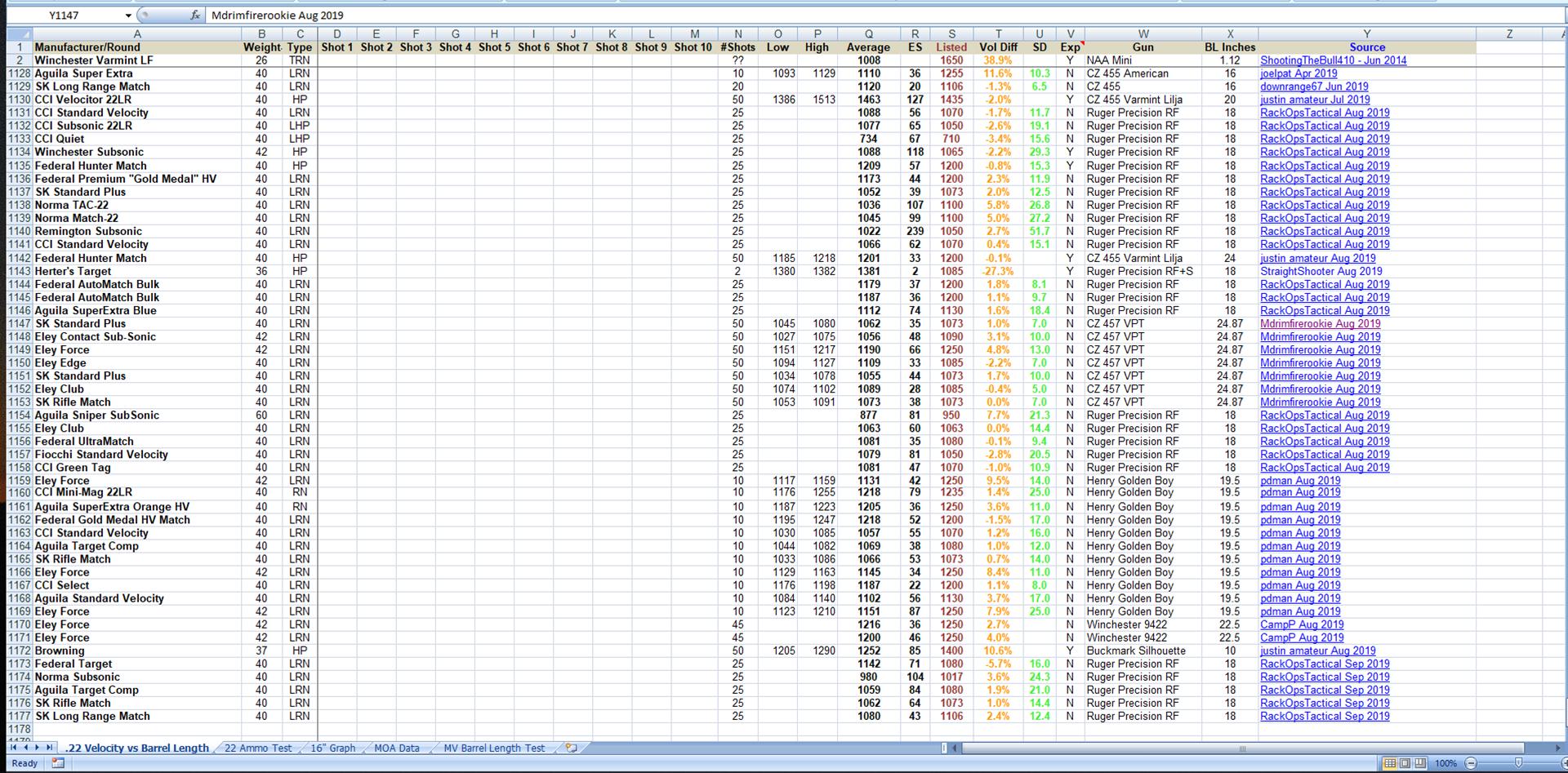

To date, over the last 3 yrs, I've put together a collection of data for .22LR that amount to 1158 lines on a spreadsheet. Almost half of it is of my own shooting and the rest is from others (like you and what you've posted); yes, your data is on my spreadsheet (including links to the web pages to see the actual reports). :cool:
FYI:
Testing these in my RPRR I've gotten the following (ES and SD's, that you might compare them to:
  • SK Long Range Match: 39, 8.8
  • SK Rifle Match: 60, 15.2
  • Federal Target: 72, 22.8
  • Norma Subsonic 40 Grain Lead Hollow Point: 70, 14.6
  • Aguila Target Competition Standard Velocity: 71, 16.O (this one not my numbers and from a Ruger 10/22)

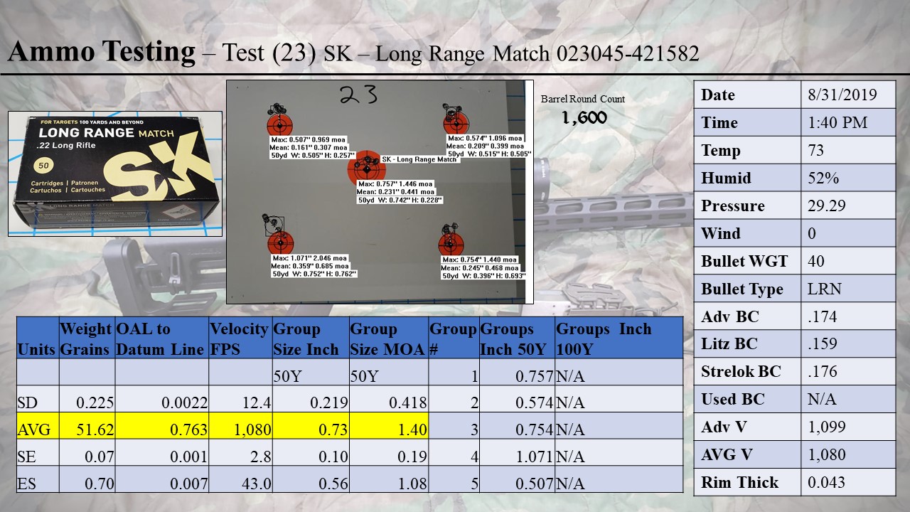

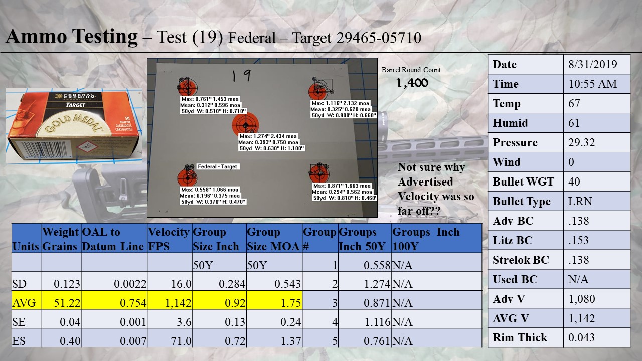

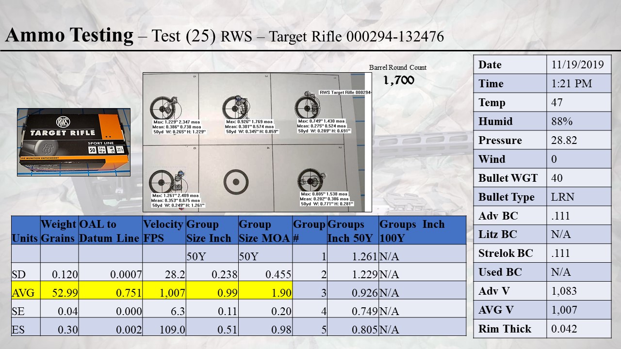

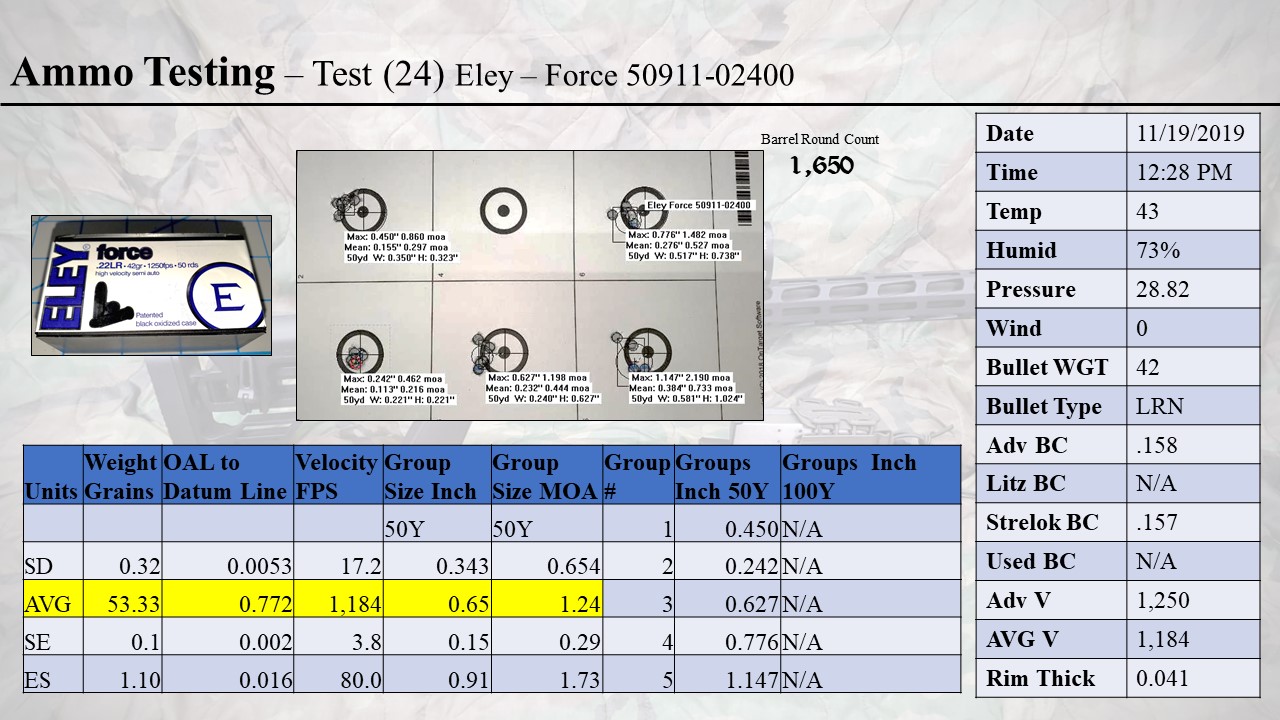

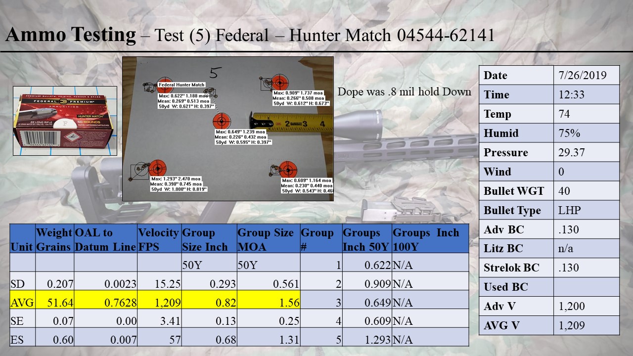

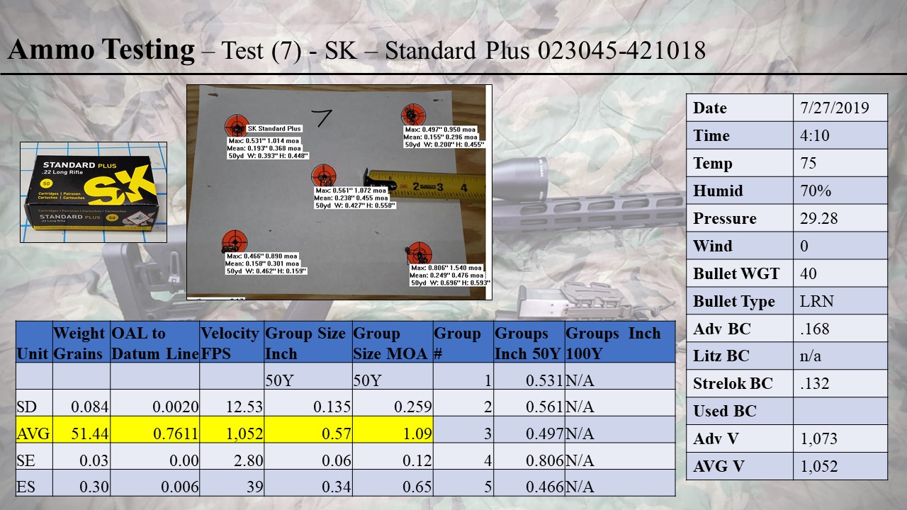

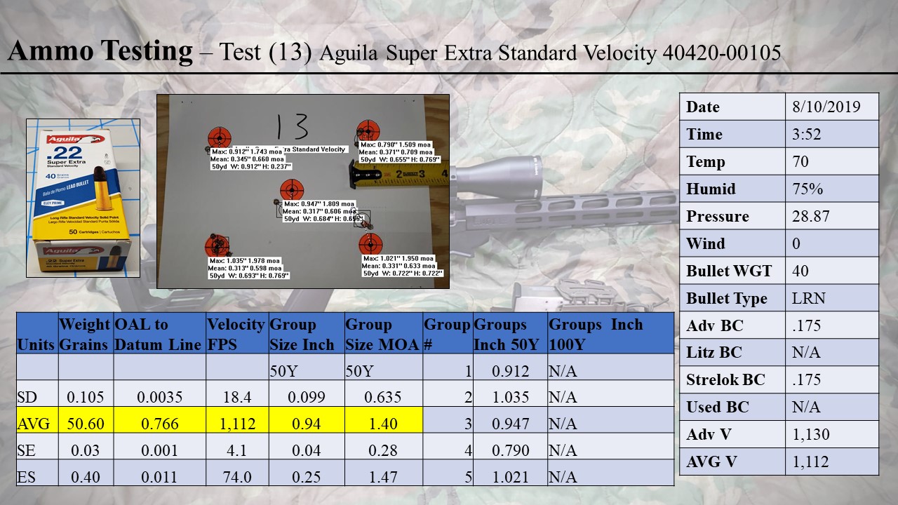

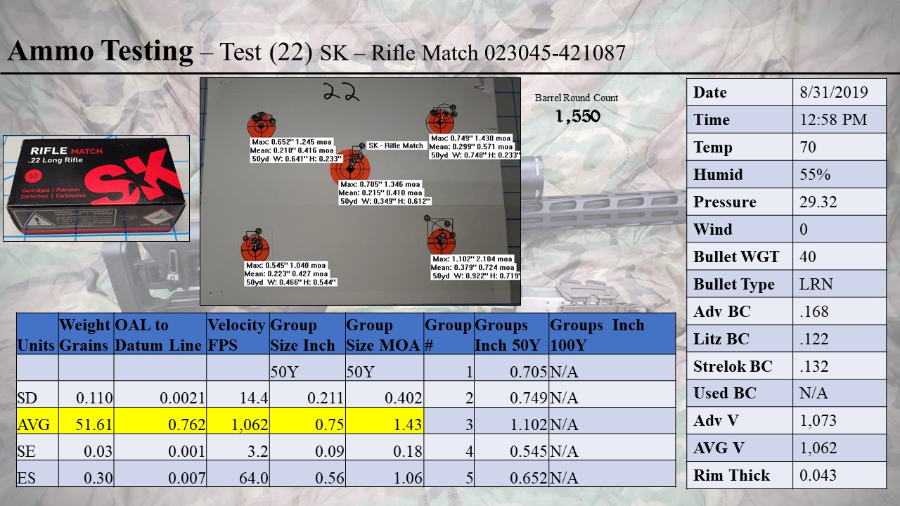

Update from Last Week's Testing:
Was a bit surprised that the Federal Target said it was at 1,080 and shot at 1,142. Made me wonder if they accidentally put in the HV match in this Target box by mistake?? All other advertised vs actual velocity readings were at least close.
This guy had the same experience with Federal Target:
Apparently, it has some extra velocity out of an 18" barrel. Another person with a CZ 455, 24" barrel, got an average of 1065 fps over 50 rounds: https://www.rimfirecentral.com/forums/showpost.php?p=11268887&postcount=289

You must have had some magic lot of SK+! The SD/ES of your SK+ is much lower than Rifle Match and LRM and CenterX... Thanks for doing this testing!
Interesting to me too is that his results for Center-X are the worst of the over 500 recorded rounds fired that's listed on my spreadsheet. It must be one of those "bad" lots of Center-X. :eek:

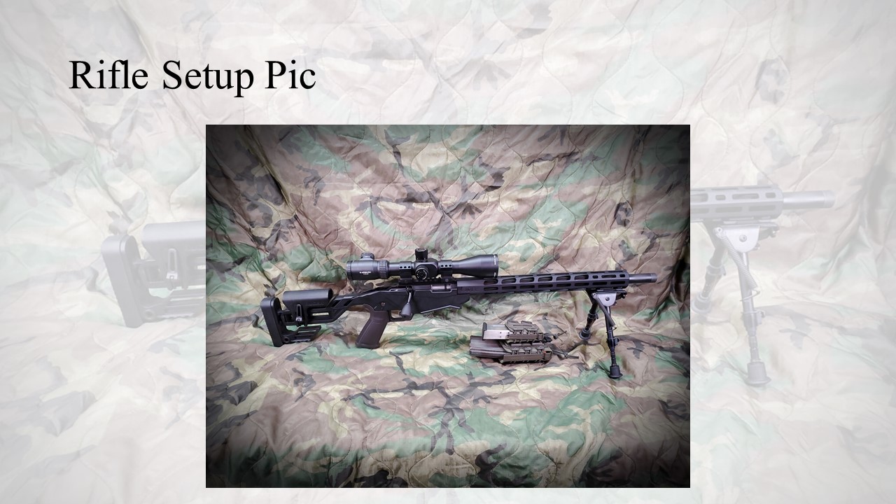

Are you also on a RPRR? I wonder what an aftermarket would do to improve it. It doesn't look to be shooting that great if the best average is still above 1moa.
Yes, I also use an RPRR along with a couple others.
There a few barrel manufacturers around now. And Timney has a fine trigger for it. Then there are some aftermarket stocks that are said to reduce the flex in the factory one. But, if I were going to upgrade it that much, I'd probably get a better gun . . . maybe something like a Voodoo.

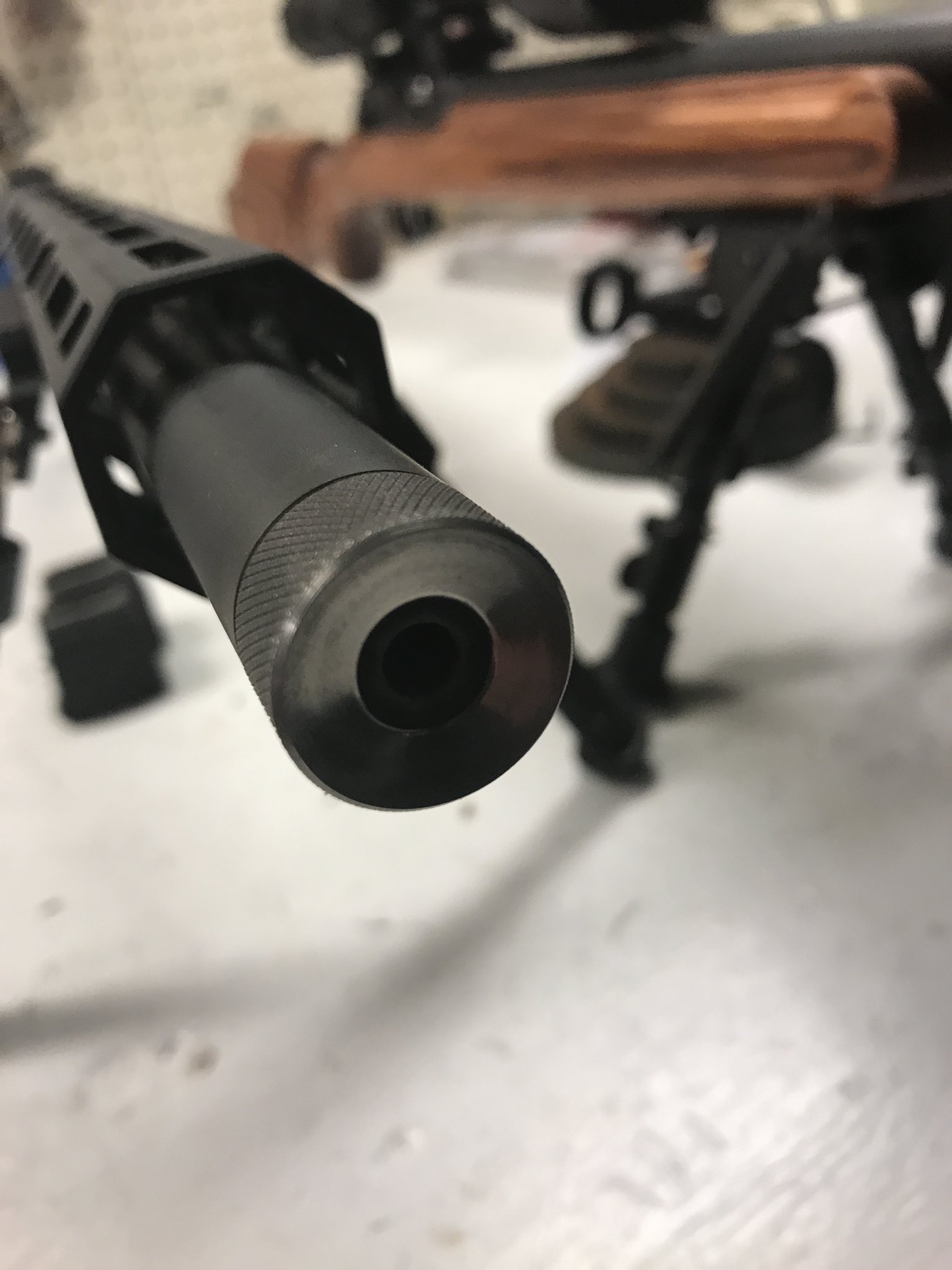

i have removed the trigger spring, bedded the action, cut the thread protector face to a 11 degree crown and opening up the hole to the width of the barrel see attached picture.
i have brought 10 shot groups down from 3” to 2 “ it is the fliers that kill a group, my next step was to figure out how to stop fliers! I have started with CCI standard I am weighing each bullet, I have found each batch has different weights I also am taking for granted brass case is close, bullet weight is close and I am just weighing power loads. I have found one box of 100 will vary 1 gr hints our fliers.
i started with .10 gr difference in weight and dropped my groups to 1 1/2” at 100 yards see attached
i have started to separate in groups of .05 gr and see how that tightens things up but it’s still winter up here and been windy. It is important to stay under supersonic, if you look at the ballistics most of what you shoot will go subsonic at 100 yards so the CCI standard is 1080 FPS which is very close. I am convinced I will get sub minute groups at 100 yards with this weapon! More to come if interest is there
