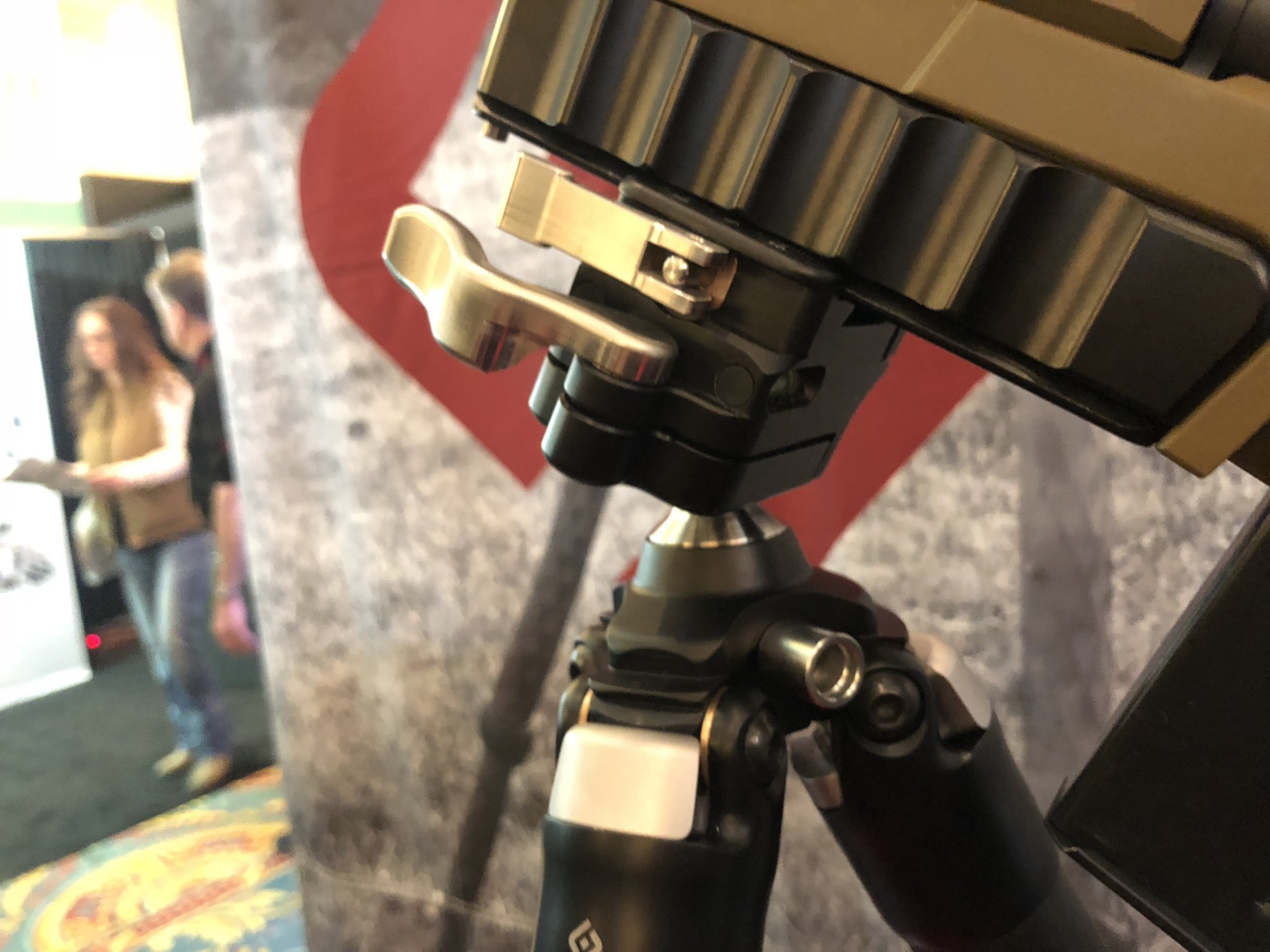

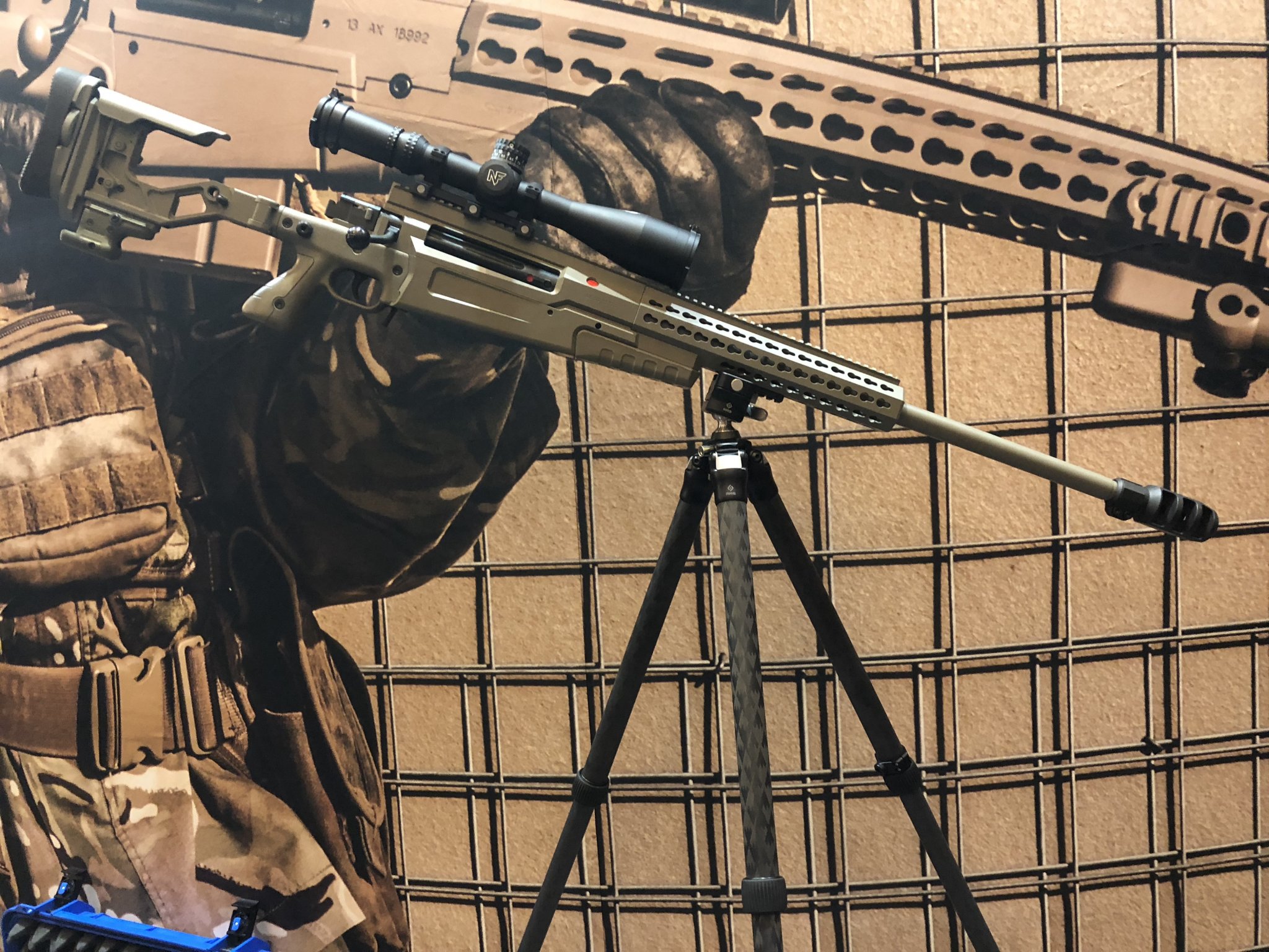

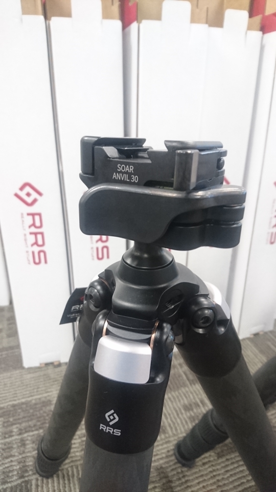

    Here are some SHOT Images, I know we have others on here,
    Holding up the AX .50 Cal

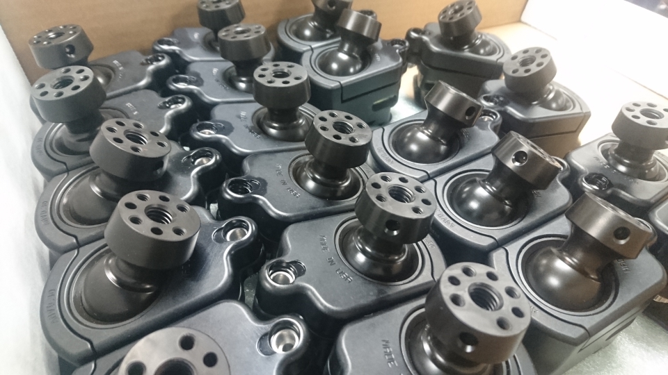

    Just received the latest update, the part that we are waiting on right now is the ball. We are working on different coatings to make sure there isn't any issues with lock-up, galling, etc. Once that is finished it will take a week and half to coat, assemble and ship. The listing says Mid April-Early May and I will most likely change that to Beg-Mid May just to give the most likely estimate, but it could still go out in April.
