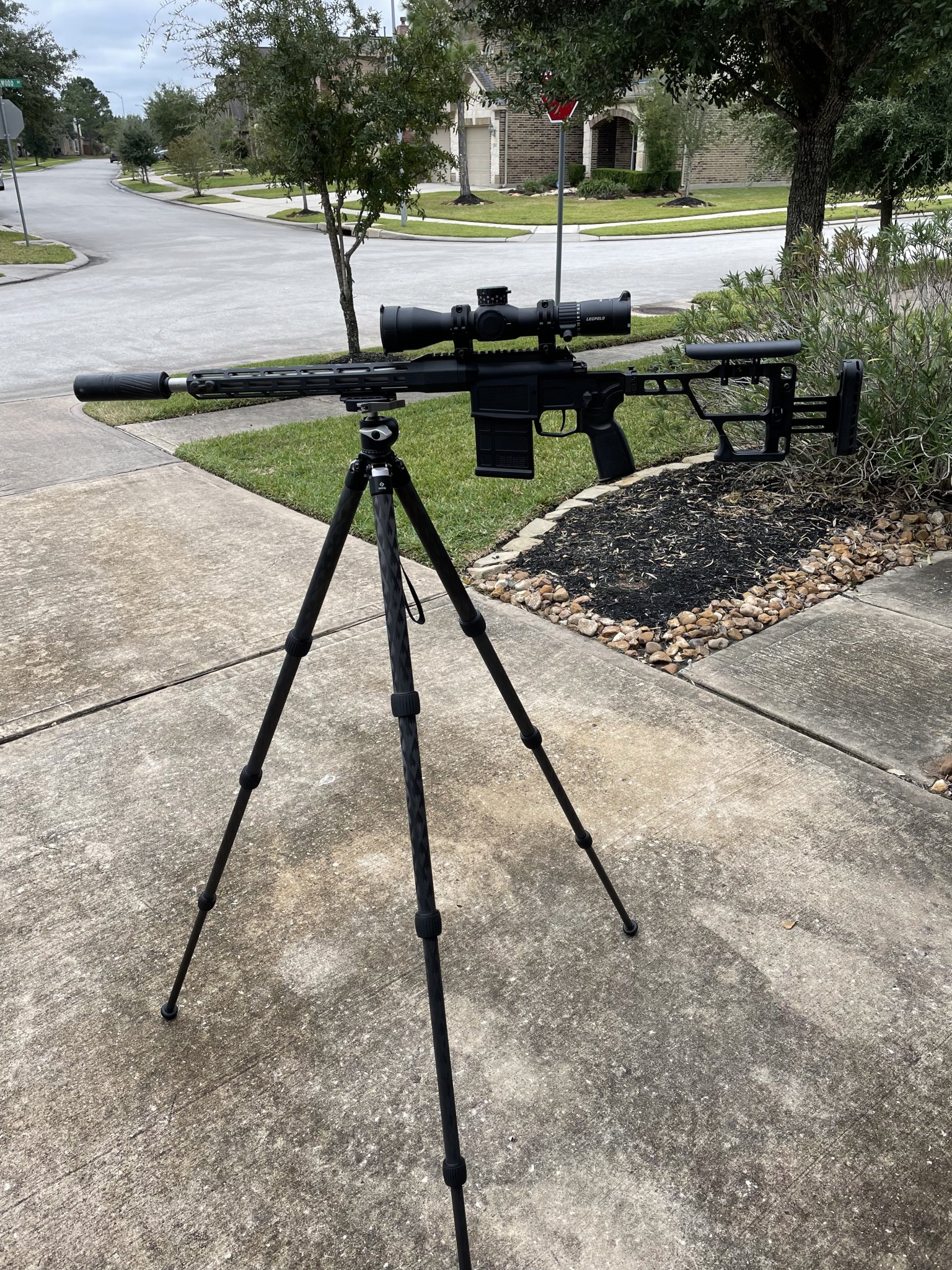

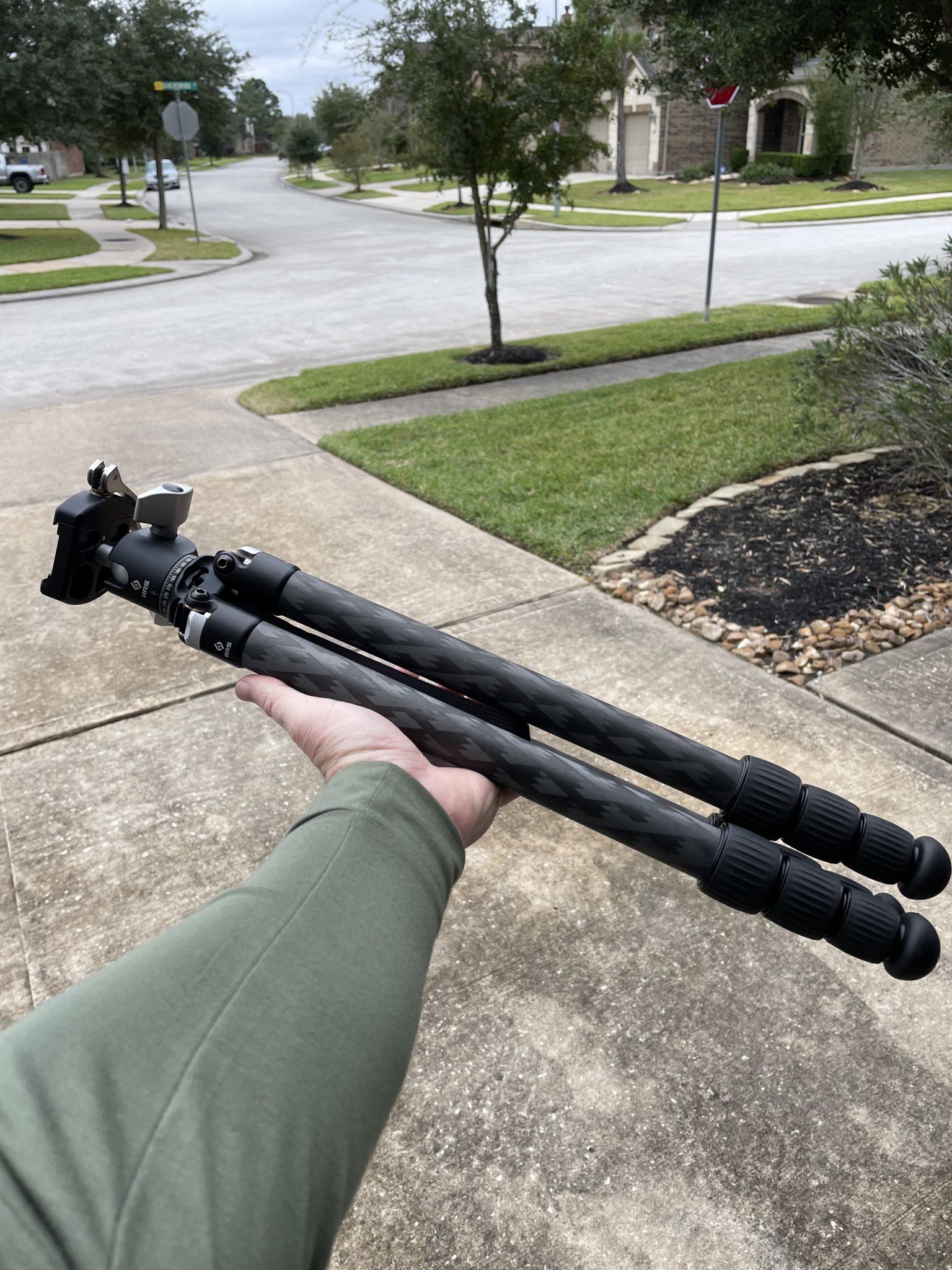

    I am thinking TFC-14 (no center column), and BH-30 because it saves me a good amount over the BH-40. As long as I am not sorely disappointed on stability. I am only using 10# hunting rifles and certainly not doing any free recoil. In all honesty I only mount a rifle 20% of the time to begin with.
    Got in the TFC-14 and BH-30. I am 5’9” so at max height it is just tall enough for me to shoot standing at full extension. I couldn’t stand upright and glass with the 34 anyhow, so no big loss there. I did some dry firing while standing…. I don’t feel like I’ve given up a ton of stability over the TFCT-34 and Anvil 30. From seated and kneeling it’s about the same. The ballhead is definitely a bit nicer for observation, can set the tension for moving binoculars around without them flopping loose like the Anvil 30. The whole package is lighter, and 3”+ shorter so it’ll be easier to fit in the backpack. All in all, I am very happy with the decision to downsize.
