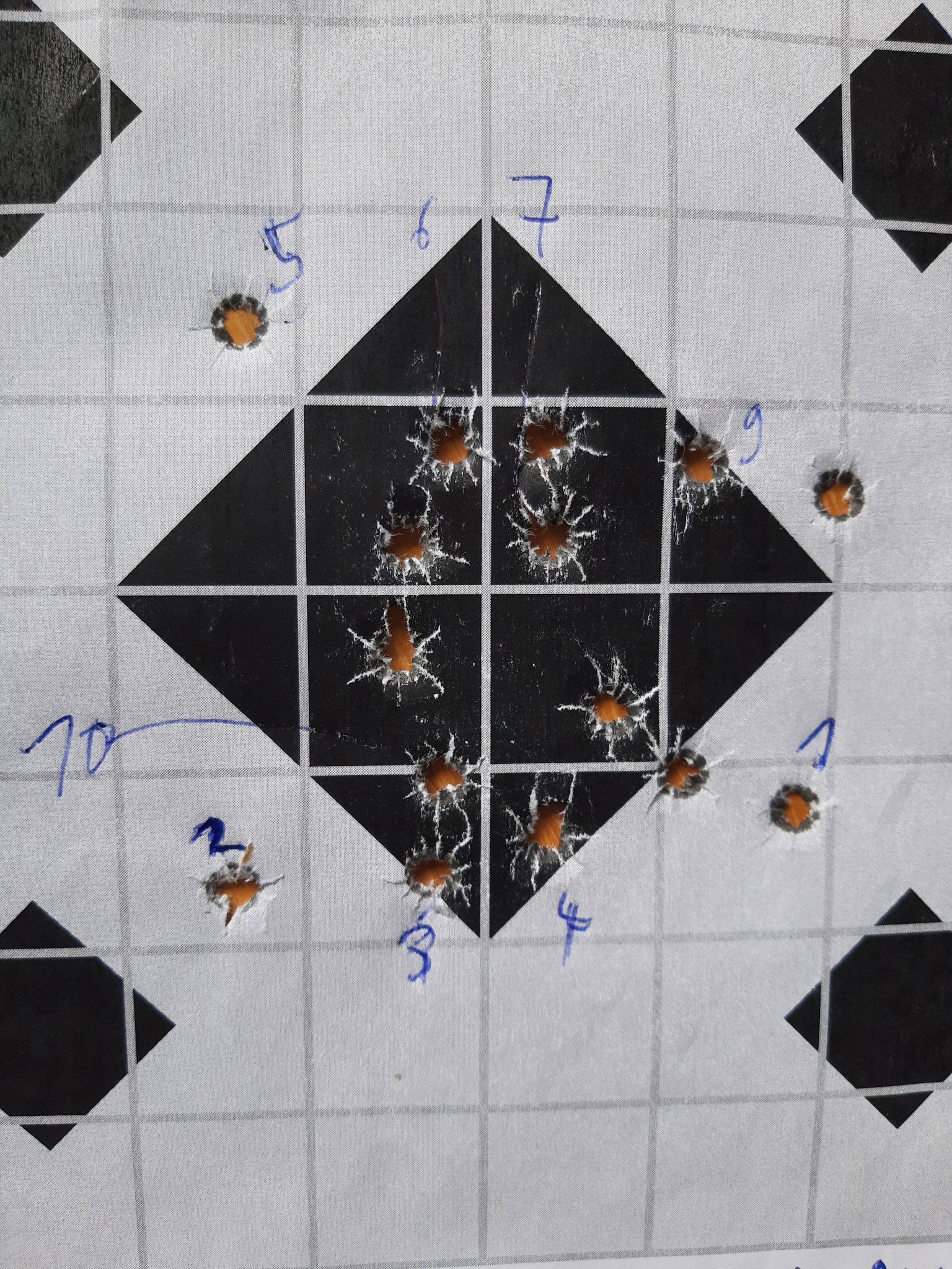

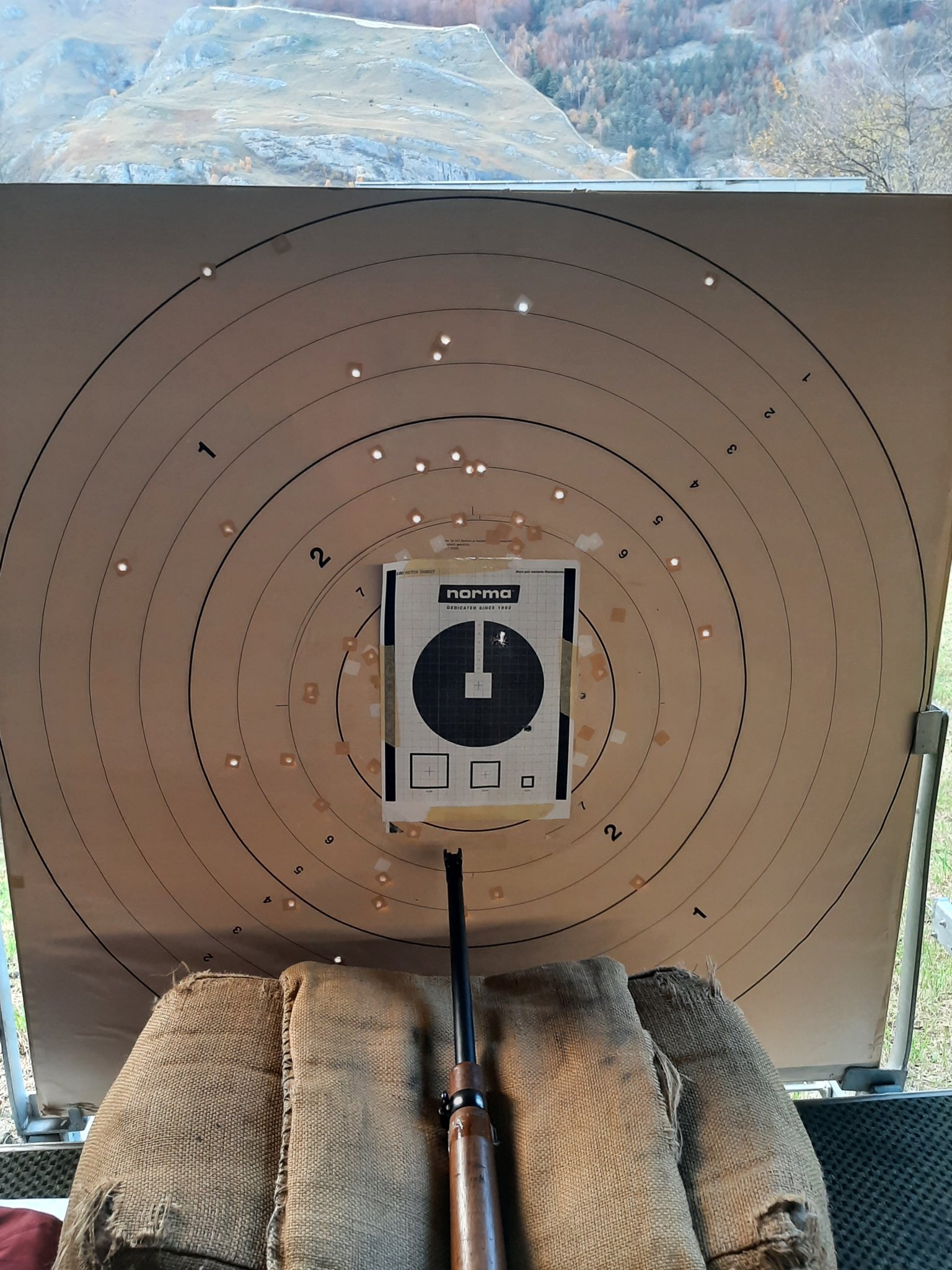

The RUAG .308 Win. 175 gr Swiss P HPBT-Round reached in the 27,5-inch-Barrel of my D73 a Muzzle-Velocity of 780 m/s resp. 2559 f/s.
And shot accurate IMHO.

Thanks Gasgun.
This was for sure not the best possibly Group, by the way.
Because I was in a hurry, i had to measure the MV too..And the same with several other ammo-types.. .
Happy new year to all :)
Gasgun you asked for the MV of the two rounds, at the very beginning.. Yes.
Before i completely forget that: the Federal .308 Win. 175 grs Gold Medal Match reached in my 27,5-inch-Barrel an MV of 2585 f/s resp. 788 m/s. In the summer..
As an average of 10 Shots.
Perhaps this is also helpful for you.. .

Thank you!
Is that at 100 meters?
I found this target many years ago on the web.. .At least 15 Years ago. Unfortunately I don't know the distance that it is intended for, originally.
But I'm in doubt that it was intended for"only"100" yards resp. meters.
Considering now his size - most of my targets have no more their original size - it is very similar to a for 200 m reduced Swiss Army B-Target.. .
The Group size - Shot 5 : a traitor ;-) is 4 Shots within 3,8 cm resp. 1,5 Inches. By the way.

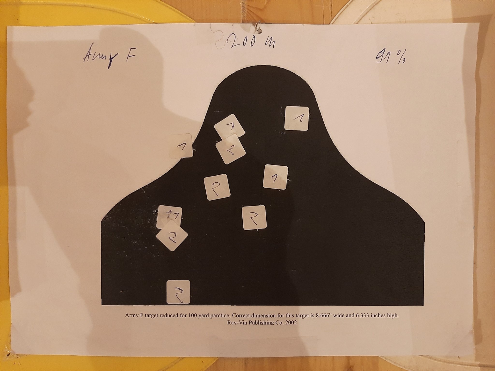

As a Swiss I would be glad being able to shoot distances of 700 meters at ore more ! Few of us can do that, according to my 32 Years experience.
This is a very quickly shot 200 meter-group in the end - shot at 100 meters. A typical sight-in distance here. Getting the MV, and impression of function, recoil - and a first idea - of the accuracy, too. Many use here different target sizes 😙 .. . There was a .50 caliber-Sniping-Rifle-Shooter starting at 25 meters ! Yes. True.
Therefore has this Federal "Gold Medal"-Match 175 grs-round has a really good accuracy-potential to me. Shot with my old glasses, by the way 🙃 The new are now in. One is waiting now for the good weather on Wednesday-afternoons.. .

100 m-Norma-Sight-in-Target, shot at 100 Meters. Only one size known for that. 3 7,5 Swiss RUAG Swiss P 175 gr Target: 11 mm at 100 m. Done.
Swiss Army-Target B, original: center 45 cm wide
The 5-Diamonds-Target and the to 20 cm wide re-duced B-Target are very similar. Other form: Thats half of the ca. 40 cm-shoulder of an average man.
As we don't shoot with our scope-rifles and such a special and expensive ammo on"fun-targets" , I like to interprete this target in this way. Got it ? :)

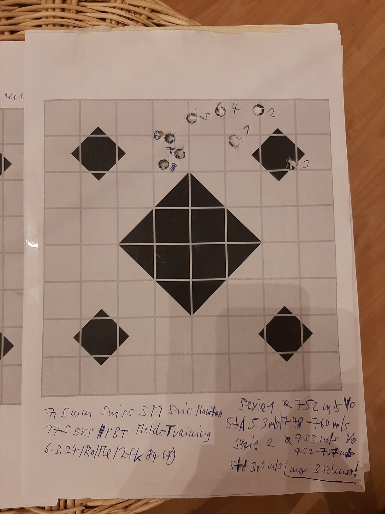

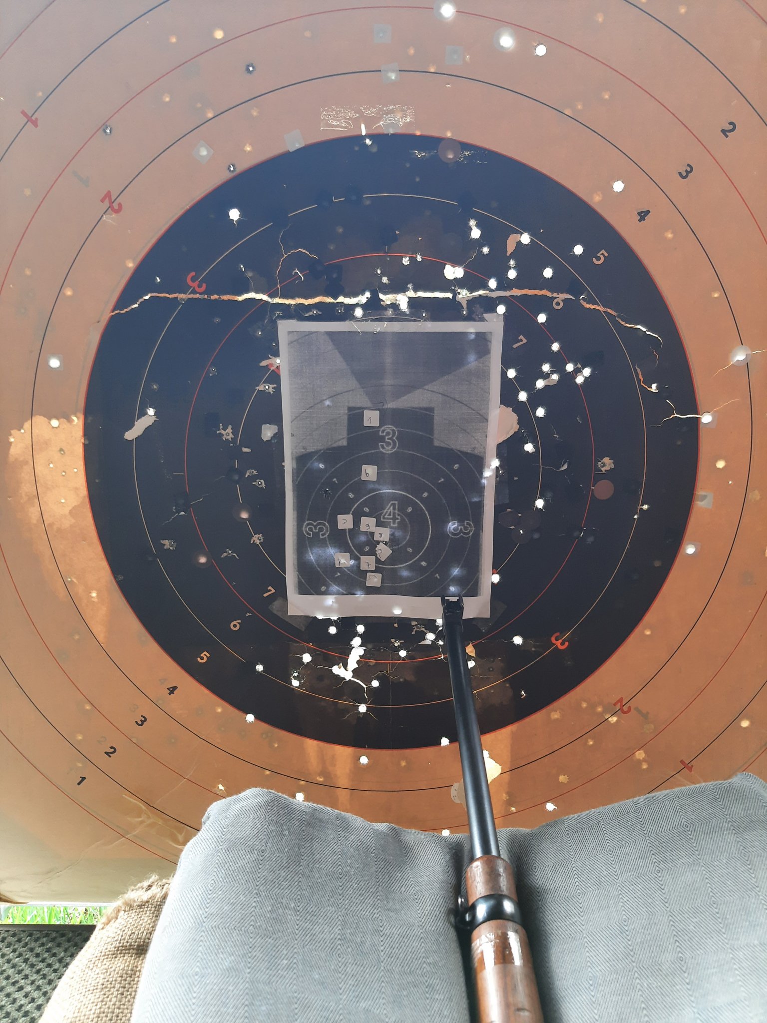

I add this pictures, too. First the Federal .308 Win. 175 gr HPBT "Gold Medal" Match.
Same target, same distance, same horrible aiming as with the RUAG Swiss P Target:
5 Shots in 37 mm resp. 1,45 inches. A Fine start.
Plus the newest pic of the 7,5 Swiss 175 gr HPBT Swiss P Target, the"rare Sibling" of the others :)
I've been thinking about all that last Wednesday ;-)
10 Shots in the Center, of which 4 in 21 mm. Nice.
BR

An ammo which shows a accuracy-potential of 5 shots within 19 mm until 5 shots within 28 mm at 100 meters in a barely tuned rifle is a not only desirable ammo.
She is really valuable, not ? ;):D
