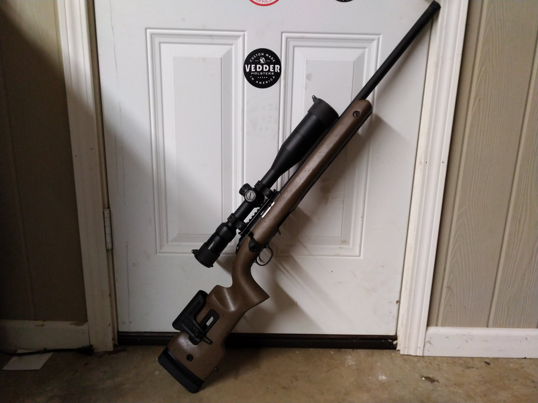

It has an old PA 4-14 FFP mil/mil on it and a 20moa rail. It has spanked some nice rifles a few times. It certainly isn’t a top level rifle, my Kidd is better, but it is definitely worth and performs better than my investment. I have always enjoyed working with an underdog and having it do well.
It was intended to be my squirrel slayer and it is exceedingly good at that job.

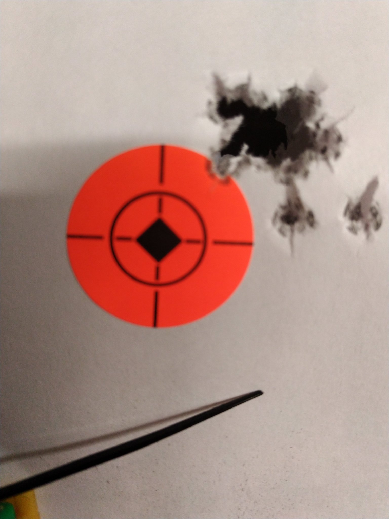

My skinny barrel American has shot .116 at 25 yards. I have not needed to shoot it farther for serious examination but may just for kicks. It’s job is squirrel control and it does it very well.
Barrel was cut and threaded/crowned, bedding blocks bedded, trigger return spring replaced with one from a pen and the bottom of the bolt stoned and slicked up. I tuned the mag for the lowest spring pressure that is reliable and the little thing just shoots.
Out of the box it was so-so. After some work it is really good. I do not think the barrel itself is now the limit but the chamber not being match.

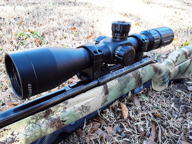

Even in the plastic stock (hey it comes with a cheek riser) it shoots great and has surprised plenty of folks. With the PA 4-14FFP having 30 mils of adjustment and with a 20moa base it can reach out to 400.

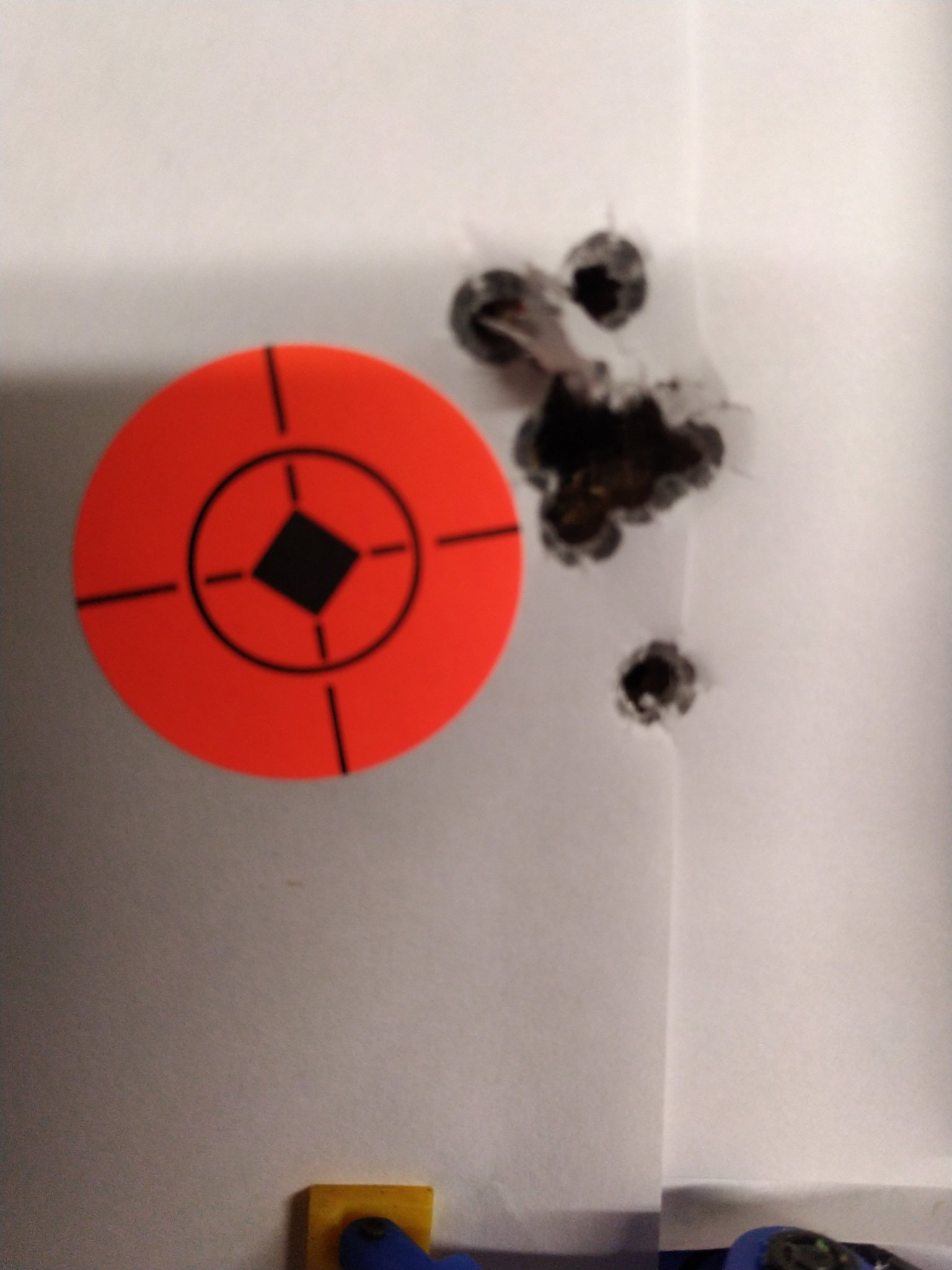

Got out this afternoon and could only get out to 60yds. Guys not real excited. 10 rounds each dot after 10 fouling rounds. Let's hear the feedback. I know it's gonna be positive and negative. Two inch dots all I had .

No it is not. The eley match wasn't terrible. I still have 40 rounds of each,so ill clean and try again.
Looks like it prefers the cheap stuff instead (and the Eley Match). Might want to just grab the CCI SV and go at it.
Sadly this will probably be similar to the rpr in that its very hit or miss if you get a good one. I know my ruger luck is terrible, finally sold my rpr after two trips back to ruger. Doubt Ill try my luck again with this one at the price they want for it.
Were you shooting off of a bipod or rest ? Rear bag ? Lawless made a ruger American ,shoot details up above , maybe spend some time and love and it will come around , I still want one just a little leery now , hope this one comes around for you
Bic pen spring trigger mod, bed the bedding blocks with aluminum tape and slick up the bottom of the bolt.

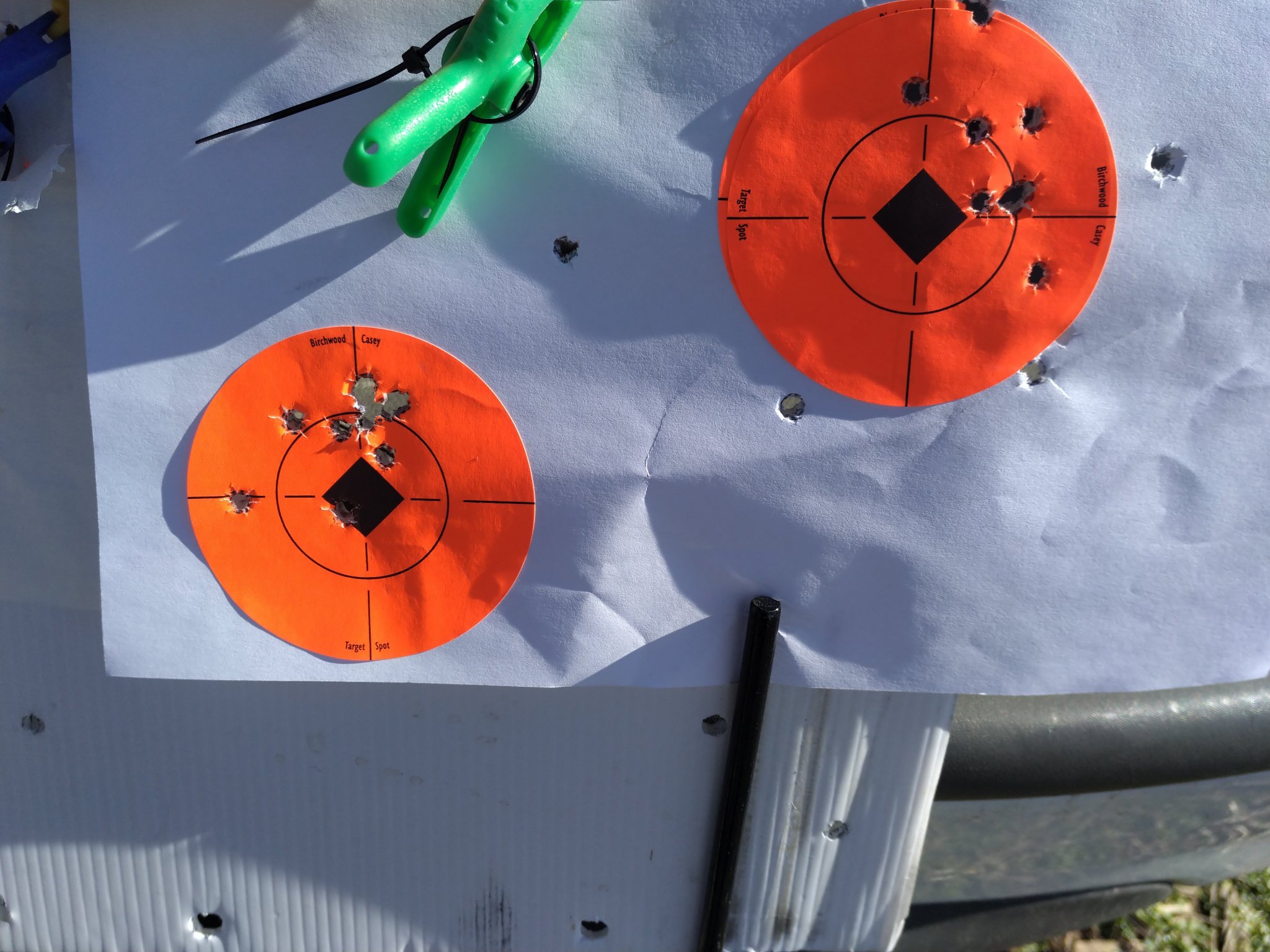

Round two,10.shots each and seems at 100 yds the sk lr is more consistent. I shot another 10 shots with sk and federal. Bottom target is sk in the pic with only two dots.

I took my skinny barrel American out this afternoon at 100 across my back pasture. I didn’t shoot paper but I wore out the 1.25” spinner with Eley Subsonic Hollow, CCI Standard, Eley Standard bulk, Federal Match and even Aquila 60g SS LOL
It was late so I didn’t have a lot of light so maybe I’ll shoot some paper tomorrow.
