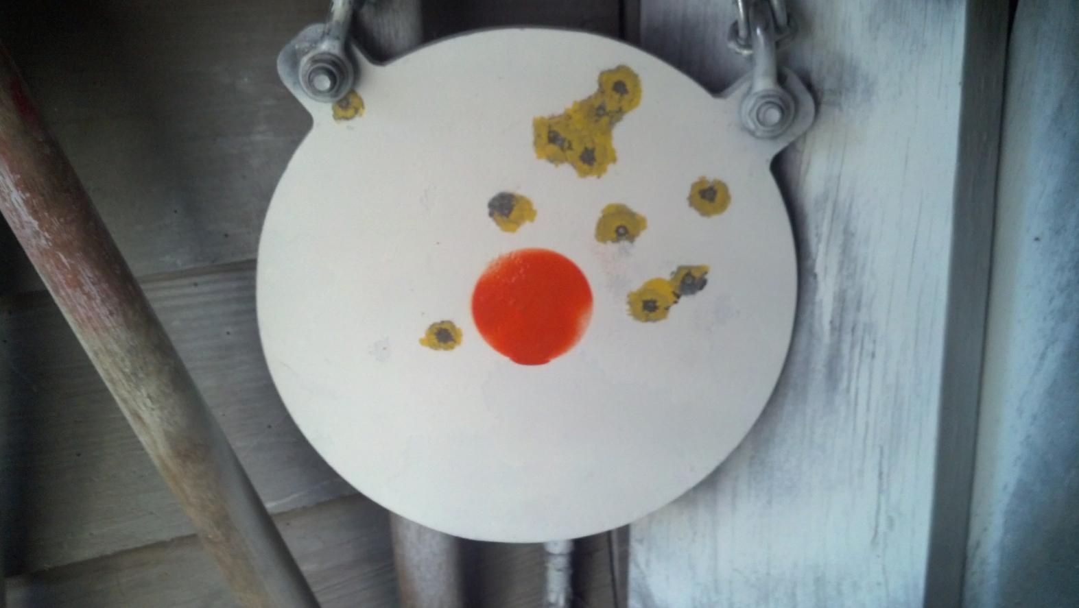

I would expect your barrel and the addition of your trigger would help you shoot some good groups. Better than what you are getting. I have an Archangel target stock, KSA barrel and Mueller APT on mine with stock trigger. I built up my own homemade cheek rest to make sure I get the same sight picture everytime. I mostly shoot 36gr bulk Federal or Winchester ammo in it. This is a pic of a 10" circle I shot at 250yds a couple of weeks back with Federal bulk 36gr ammo. Mind you I had to go near the max elevation for my scope and had to use the lowest mil-dot on my reticle. Got to get a 20MOA base for this thing. I would love to get my hands on some Match ammo to try out but right now I can't even find bulk 22LR anymore. Luckily I have plenty stored up.
